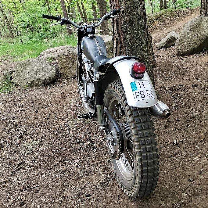

pschrauber Posted February 5, 2022 Report Share Posted February 5, 2022 I would suggest you design them by yourself and let them print by a print shop on sticker material that is used to wrap car bodies. That foil can be heated up and streched to the needs of the surface geometry. The standard foil can -as woody- mentioned be a problem when mounted on rounded surfaces. I made myself register sticker plates to my bike and these where printed on car body foil which was easy to apply if you follow the instruction using soapy water, a hot air gun and a squeegee. 1 Quote Link to comment Share on other sites More sharing options...
Ainsley Posted February 6, 2022 Author Report Share Posted February 6, 2022 Ah, that eBay sticker should do the trick, thanks. I've ordered two in case I mess up the first one. I reckon with a hairdryer I might be able to get it to curve in two directions. If not its cheap and I will resort to your idea, Pschrauber. Quote Link to comment Share on other sites More sharing options...
