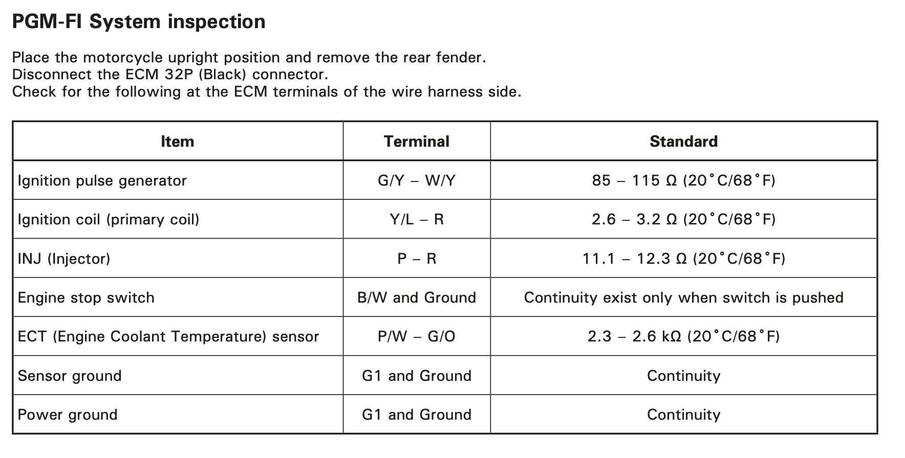

IBA4rt Posted November 1, 2024 Report Share Posted November 1, 2024 Well, although I haven't tried it yet, I have no words to thank you for the approach you have given me. Apart from having all the logic, I just picked up the manual and it specifies how to check the sensor from the control unit connector. I have tested all the parameters in this panel with a tester and more or less all of them correspond to the parameters except the temperature sensor that, by placing the tester on the pins indicated on the connector, does not return any data, there is no resistance or continuity. I have checked the sensor connector itself and everything looks normal, so one of two, either I have a sensor failure or I have a failure in the electrical installation since the formal way to check it is not in the sensor (from which, by the way, three cables come out, no only two). Quote Link to comment Share on other sites More sharing options...

IBA4rt Posted November 6, 2024 Report Share Posted November 6, 2024 Well, problem solved. After going crazy checking a thousand things, the fault was in the coil. First I thought it was the temperature sensor but I had made the measurement incorrectly, in ohms, when the parameters of this sensor are measured in Kiloomhios. After checking that this sensor was ok, I focused on the coil, it gave a high resistance at 20 degrees, 42 ohms. I went to my Honda dealer and the bike is new, they gave me the new coil, I mounted it and after two days of testing in different conditions the bike is perfect, now idling stable without backfires and it no longer turns off. I hope my little ordeal can help someone in the future. By the way, I love the motorcycle, it's a ****ing tractor 😁 2 Quote Link to comment Share on other sites More sharing options...
