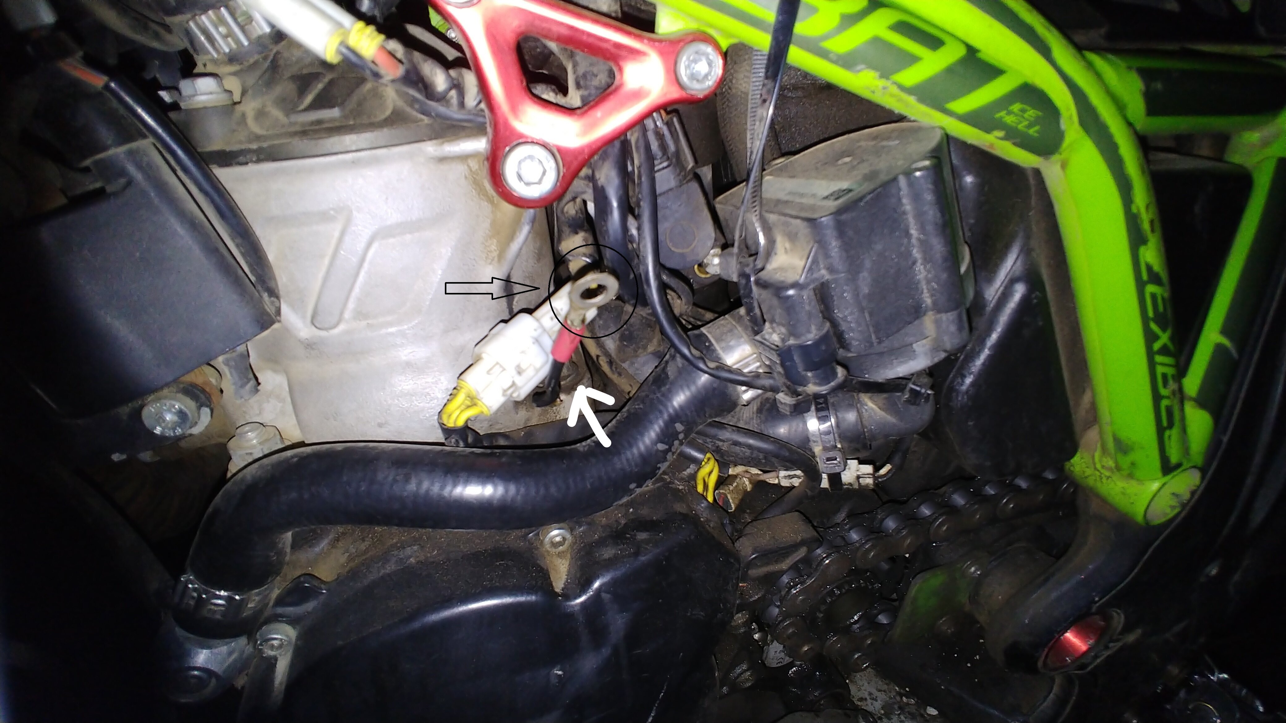

jeong won lee Posted February 9, 2022 Report Share Posted February 9, 2022 Hi. I'm a user living in South Korea. The RPM suddenly became unstable. I changed the 9v battery to a new one, but it just says that the battery is weak and it doesn't start. If I connect the external power, the engine will start. The RFM is unstable. If you turn off the external power, the engine will turn off. It's because of the negative electrode. Is it because of this? I don't remember where the cathode paper was. I'd like to know where to connect. Quote Link to comment Share on other sites More sharing options...
Tiewrap Posted February 9, 2022 Report Share Posted February 9, 2022 Aaah the picture makes it clear. On my bike that wire is on the nut of the cilinder which is very close to the wire. Quote Link to comment Share on other sites More sharing options...
jeong won lee Posted February 9, 2022 Author Report Share Posted February 9, 2022 5 hours ago, Tiewrap said: Aaah the picture makes it clear. On my bike that wire is on the nut of the cilinder which is very close to the wire. Thank you. One side is hung on the bolt of the white Hasalpyo and the other side is disconnected. Quote Link to comment Share on other sites More sharing options...
