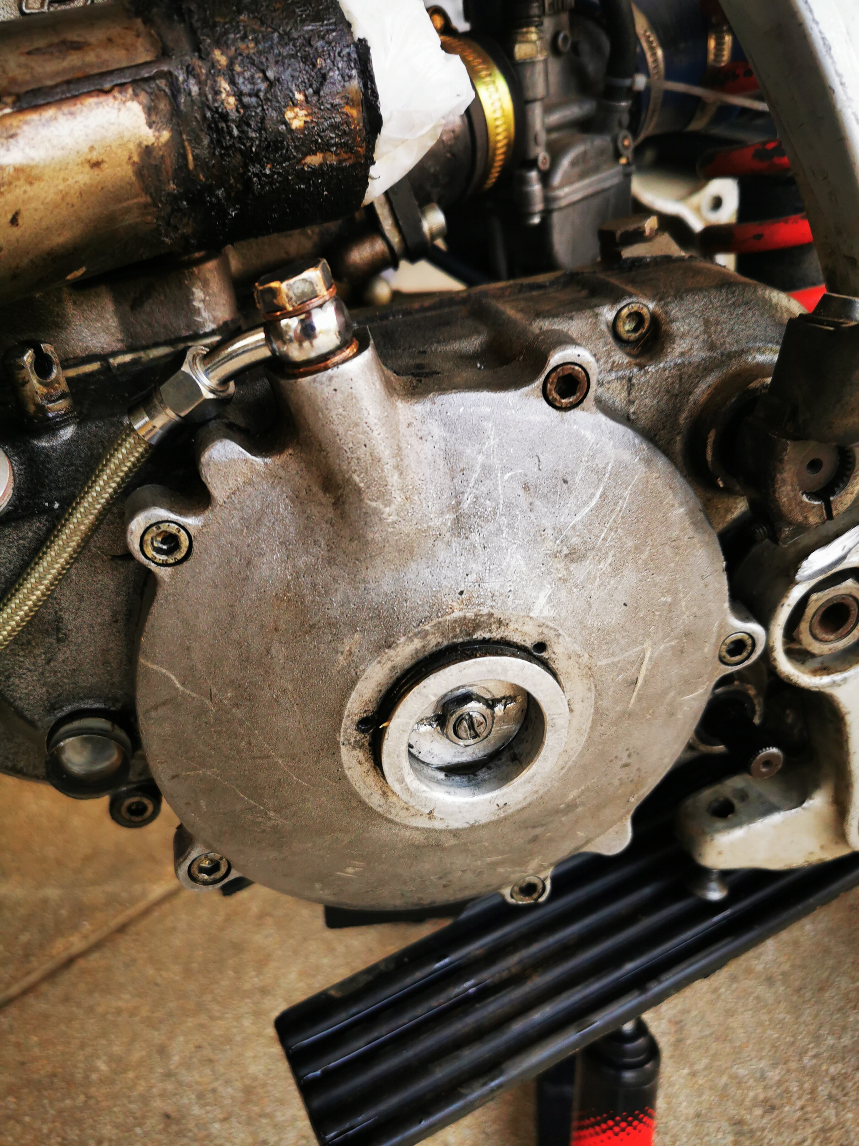

VictorBlack Posted March 4, 2022 Report Share Posted March 4, 2022 Identify this aftermarket Hydraulic Clutch fitted to my Beta Zero ? Any guidance here appreciated I know literally nothing about 1990 vintage Trials Bikes I purchased what I believe to be a 1992 Beta Zero But it has this Hydraulic Clutch set up ? I have a number of questions like how do you bleed it ? It does not seem to have a bleed valve but I am sure I can research that if I first know what it is. I am sure this bike came with a Cable Clutch Quote Link to comment Share on other sites More sharing options...
reggie Posted March 4, 2022 Report Share Posted March 4, 2022 Wow never seen that before! You can put the bleed nipple / banjo bolt from an Evo on to bleed. Th nipple may interfere with the exhaust. It would be interesting to see the inner workings of this. Thanks for sharing this . 1 Quote Link to comment Share on other sites More sharing options...
VictorBlack Posted March 4, 2022 Author Report Share Posted March 4, 2022 thank you yes that makes sense Quote Link to comment Share on other sites More sharing options...
VictorBlack Posted March 5, 2022 Author Report Share Posted March 5, 2022 Ok I found the answer to this Apparently its a Dougie Lampkin Works Special.. Thank you 1 Quote Link to comment Share on other sites More sharing options...

Nishijin Posted March 7, 2022 Report Share Posted March 7, 2022 Regarding bleeding technique… Maybe it’s like the Scorpa Easy, where you just crack the bolt and bleed down the face of the clutch cover. If you fit a bleed bolt, agreed it might foul on the exhaust. Quote Link to comment Share on other sites More sharing options...
