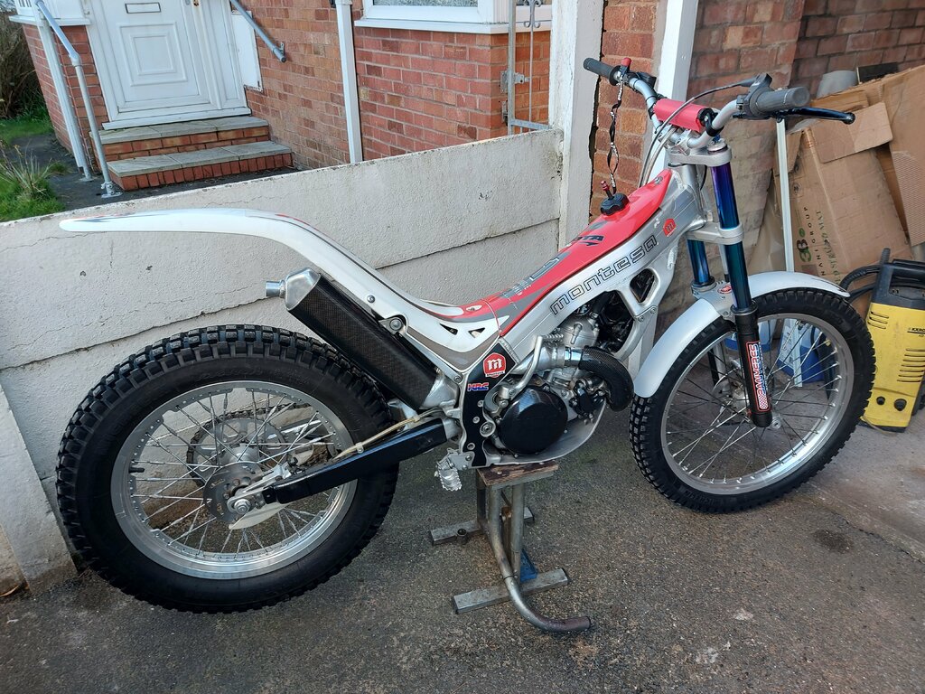

Cube Posted March 17, 2022 Report Share Posted March 17, 2022 Looks pretty cool in white mate! Nice! 1 Quote Link to comment Share on other sites More sharing options...
retromlc Posted March 19, 2022 Report Share Posted March 19, 2022 Nice clean bike 👍 1 Quote Link to comment Share on other sites More sharing options...
