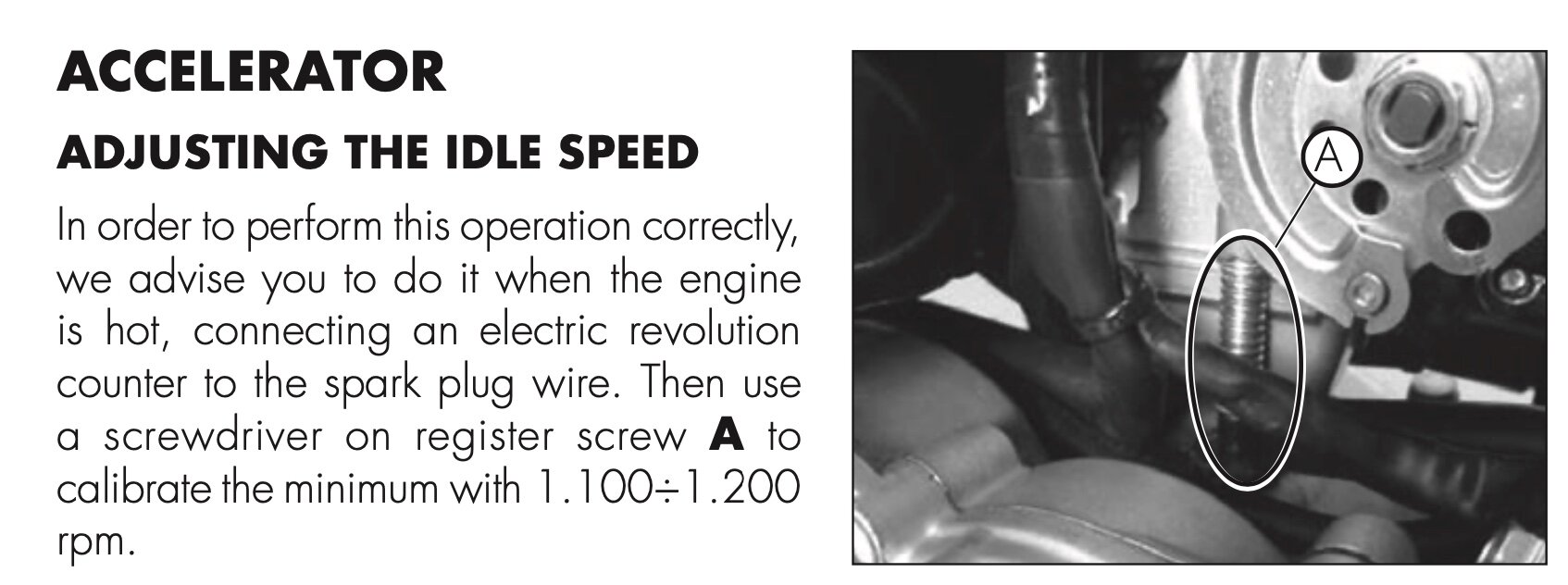

YO dudes!
Read the manual and it might as well be in Italian? Bike runs good but the idle speed is excessive, how do you adjust it without surgical tools? And yes, the throttle cable etc. is all functioning like all good domino's do!
