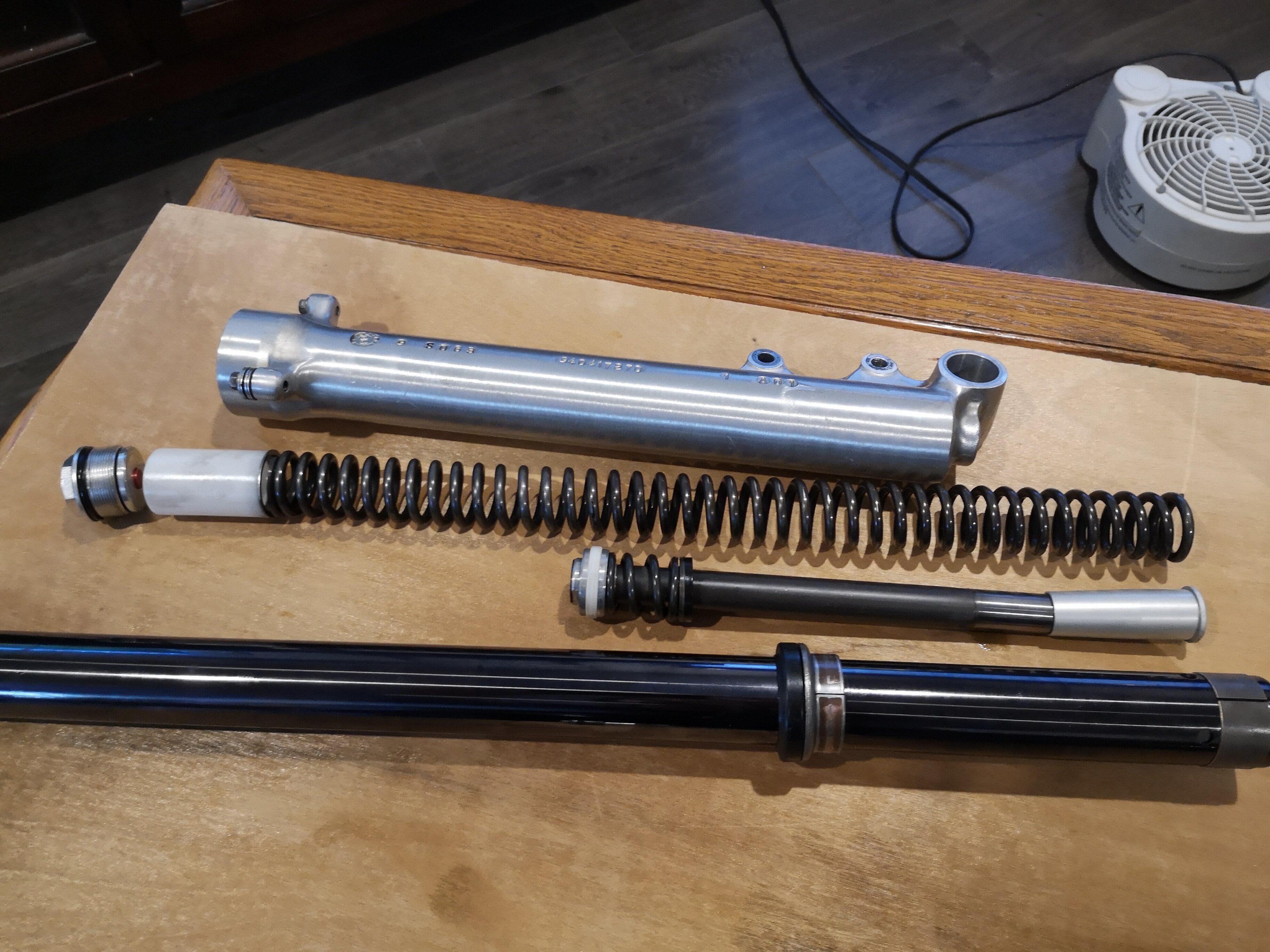

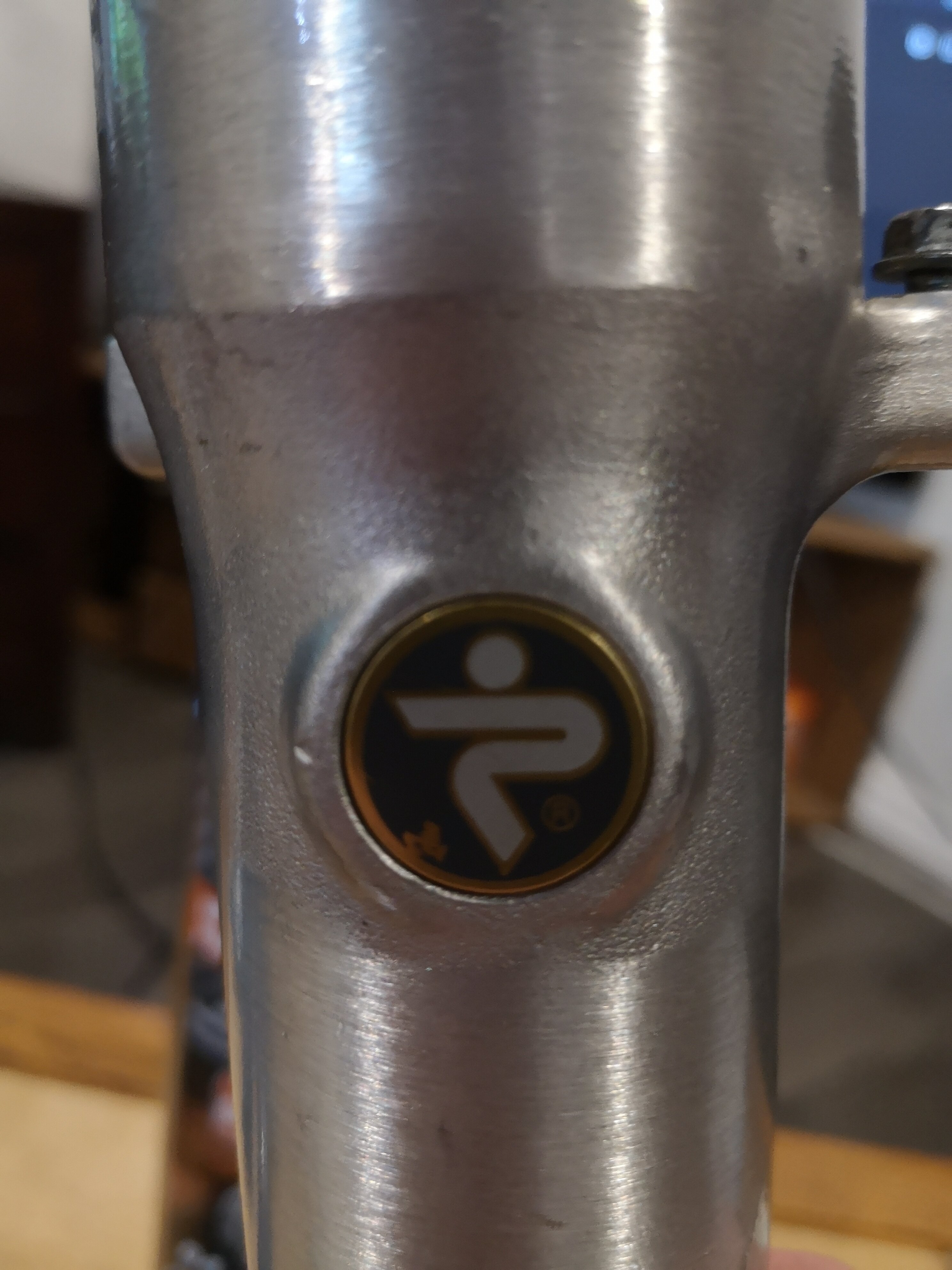

LarsH Posted April 12, 2022 Report Share Posted April 12, 2022 I'm trying to figure out who even makes these forks so I can get a manual and parts list. They are 38mm. The bike is a 2008 txtpro, but who knows where the forks are from. Who's logo is that? I googled a few makers and can't find it. Quote Link to comment Share on other sites More sharing options...
faussy Posted April 12, 2022 Report Share Posted April 12, 2022 (edited) All GG in that era, including 2008 had marzocchis. Those are paioli possibly out of a sherco or beta Edited April 12, 2022 by faussy Quote Link to comment Share on other sites More sharing options...
LarsH Posted April 12, 2022 Author Report Share Posted April 12, 2022 On 4/12/2022 at 5:14 PM, faussy said: All GG in that era, including 2008 had marzocchis. Those are paioli possibly out of a sherco or beta Expand Paioli!!!! That's it. I was going crazy trying to figure out why mine looked different. I'll go hit up those forums now. Quote Link to comment Share on other sites More sharing options...
LarsH Posted April 12, 2022 Author Report Share Posted April 12, 2022 I also discovered this thread: Apparently, some later 2008 GG came with Paioil. I guess mine was one of them. 1 Quote Link to comment Share on other sites More sharing options...
d2w Posted April 13, 2022 Report Share Posted April 13, 2022 And I have one as well: 2008 GG 280 TXT PRO. With Paioli. My 2008 (the 280 is my son's) GG 300 TXT PRO has Marzocchis. Must have been a supply issue. I believe Beta uses Paioli forks as standard equipment. Quote Link to comment Share on other sites More sharing options...
