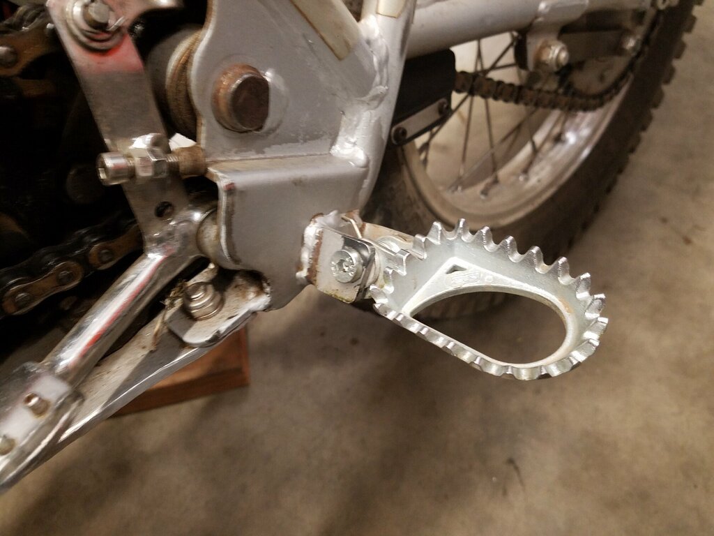

slowrider Posted April 12, 2022 Report Share Posted April 12, 2022 Has anyone tried these, and are they a bolt on or weld on? http://www.frankiemountain.com/en/compra/footpegs-bultaco-sherpa-bultaco-alpina-footrest-foot-pegs-bultaco-2084 Quote Link to comment Share on other sites More sharing options...
feetupfun Posted April 13, 2022 Report Share Posted April 13, 2022 Logically how could those pegs ever fit to the standard Bultaco footpeg mounts? And they look amazingly similar to these which are listed as needing brackets welded on https://www.inmotiontrials.com/product/footrest-kit-alloy-universal-with-weld-on-brackets-wide/ 3 Quote Link to comment Share on other sites More sharing options...
motovita Posted April 13, 2022 Report Share Posted April 13, 2022 (edited) 22 hours ago, slowrider said: Has anyone tried these, and are they a bolt on or weld on? http://www.frankiemountain.com/en/compra/footpegs-bultaco-sherpa-bultaco-alpina-footrest-foot-pegs-bultaco-2084 Those don't look like they'ii fit any Bultaco peg mount I ever saw. Edited April 13, 2022 by motovita Quote Link to comment Share on other sites More sharing options...
carl ekblom Posted April 13, 2022 Report Share Posted April 13, 2022 Think you need weld on brackets for the footpegs in mention. Most people feel comfortable if they move the footpegs slightly rearwards and slightly downwards. Slightly is up to a couple of cm. I like the S3 steel ones. S3 steel footpegs are reasonable light and are long lasting Quote Link to comment Share on other sites More sharing options...
slowrider Posted April 14, 2022 Author Report Share Posted April 14, 2022 Disapointed to hear you think they wont just bolt on, seem someone should make a set that does that. Do you have a link for the S3 pegs? Quote Link to comment Share on other sites More sharing options...
carl ekblom Posted April 14, 2022 Report Share Posted April 14, 2022 https://www.splatshop.co.uk/s3-hardrock-steel-footrests.html You may find similar from Jitsie 1 Quote Link to comment Share on other sites More sharing options...
carl ekblom Posted April 14, 2022 Report Share Posted April 14, 2022 https://s3parts.com/en/footrest-and-parts/173-trial-footrests-s3-hard-rock-steel-8435645010398 1 Quote Link to comment Share on other sites More sharing options...
vintagenut Posted April 15, 2022 Report Share Posted April 15, 2022 I absolutely love these pegs! Have them on both my Sherpa and my 240 Fantic. Affordable, strong, grippy, mildly adjustable and great quality. Yes - you do have to weld the brackets into place (I purchased my universal brackets separately from In Motion) but it's well worth it for what you gain in the end. If you're careful with a cutoff wheel, you can pretty neatly cut away your old mounts and save with your OEM pegs... just in case you sell the bike later on and want to include the parts needed to return to original. 1 Quote Link to comment Share on other sites More sharing options...
