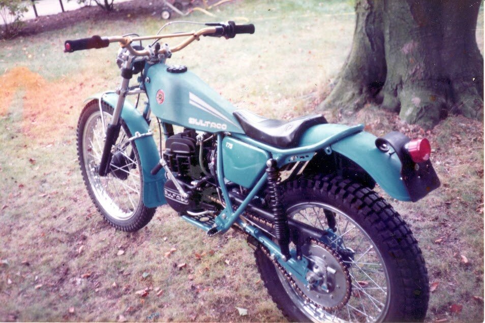

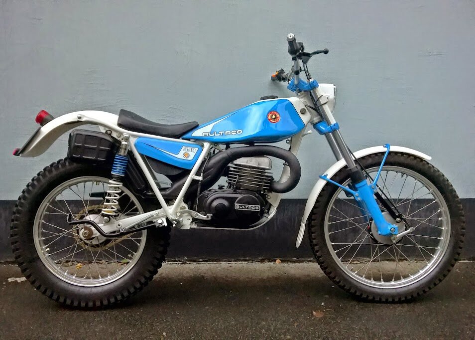

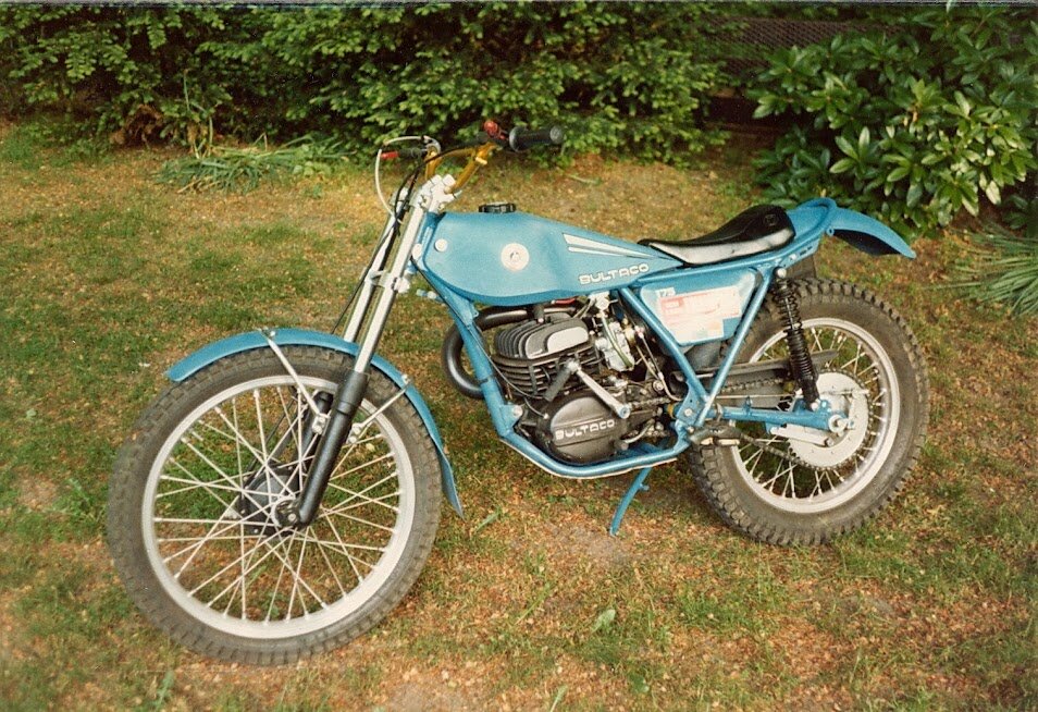

pschrauber Posted April 30, 2022 Report Share Posted April 30, 2022 9 hours ago, carl ekblom said: Had a discussion with a number of Bultaco experts some time ago about possible shades of Bultaco blue. It ended "there is only one known Bultaco blue from factory". Different shades of blue seen on old colour photos is possibly due to agening photos. This is good for me unless someone has different and more correct information. My remark is RAL5015 suits well (or perfect) and it´s easy to find https://www.ctborracha.com/wp-content/uploads/2019/02/3-RAL-to-Pantone-Conversion.pdf Bultaco used many German standards but produced their bikes due to the Spanish tax regulations, Like the strength of their bolts, the Bing carbs build by them and as told I painted two bikes in RAL 5015 and where told both times that is the right color, still it shades a bit depending the brand. I think it worked out very good. First photo of the pair is original, the second is rebuild a rebuild. First 2: 175 Sherpa in summer 82 and in summer 83 refurbished. Second 2: 2x 340 Sherpa when pulled out of a garage in 2009 and later refurbished: 1 Quote Link to comment Share on other sites More sharing options...
