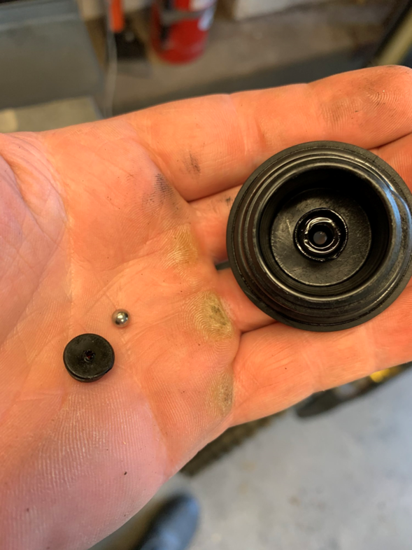

stevec Posted May 17, 2022 Report Share Posted May 17, 2022 (edited) There have been reports of gas tank vent valves sticking. The valve is in the gas cap: Loosen the cap next time it happens and listen for air rushing in. Some riders remove the ball and install a conventional check valve on the end of the vent tube. Edited May 17, 2022 by stevec Quote Link to comment Share on other sites More sharing options...
trshelena Posted May 17, 2022 Author Report Share Posted May 17, 2022 17 hours ago, stevec said: There have been reports of gas tank vent valves sticking. The valve is in the gas cap: Loosen the cap next time it happens and listen for air rushing in. Some riders remove the ball and install a conventional check valve on the end of the vent tube. Thanks I'm going to try this I'm just going to get the vent tube. I have a Bernie Schreiber training class in 3 1/2 weeks will be a good test and I'll let you know. Quote Link to comment Share on other sites More sharing options...

stevec Posted May 18, 2022 Report Share Posted May 18, 2022 8 hours ago, lineaway said: That is so funny after I posted it in 2018! Now there's some working hands! Here's the most useful thread: https://www.advrider.com/f/threads/calling-out-trs-owners-questions-things-to-share.1288338/page-19#post-35746434 . "Hoss Cartright" is Jim Snell, the US importer. 1 Quote Link to comment Share on other sites More sharing options...
Bike_Breaker Posted May 18, 2022 Report Share Posted May 18, 2022 I didn't even think to mention the vent tube issue. I thought TRS fixed that on the '20 or '21. I have never had an issue with mine doing this. Quote Link to comment Share on other sites More sharing options...

trshelena Posted June 20, 2022 Author Report Share Posted June 20, 2022 I removed the ball from the gas cap and still have the problem any more thoughts? Quote Link to comment Share on other sites More sharing options...
