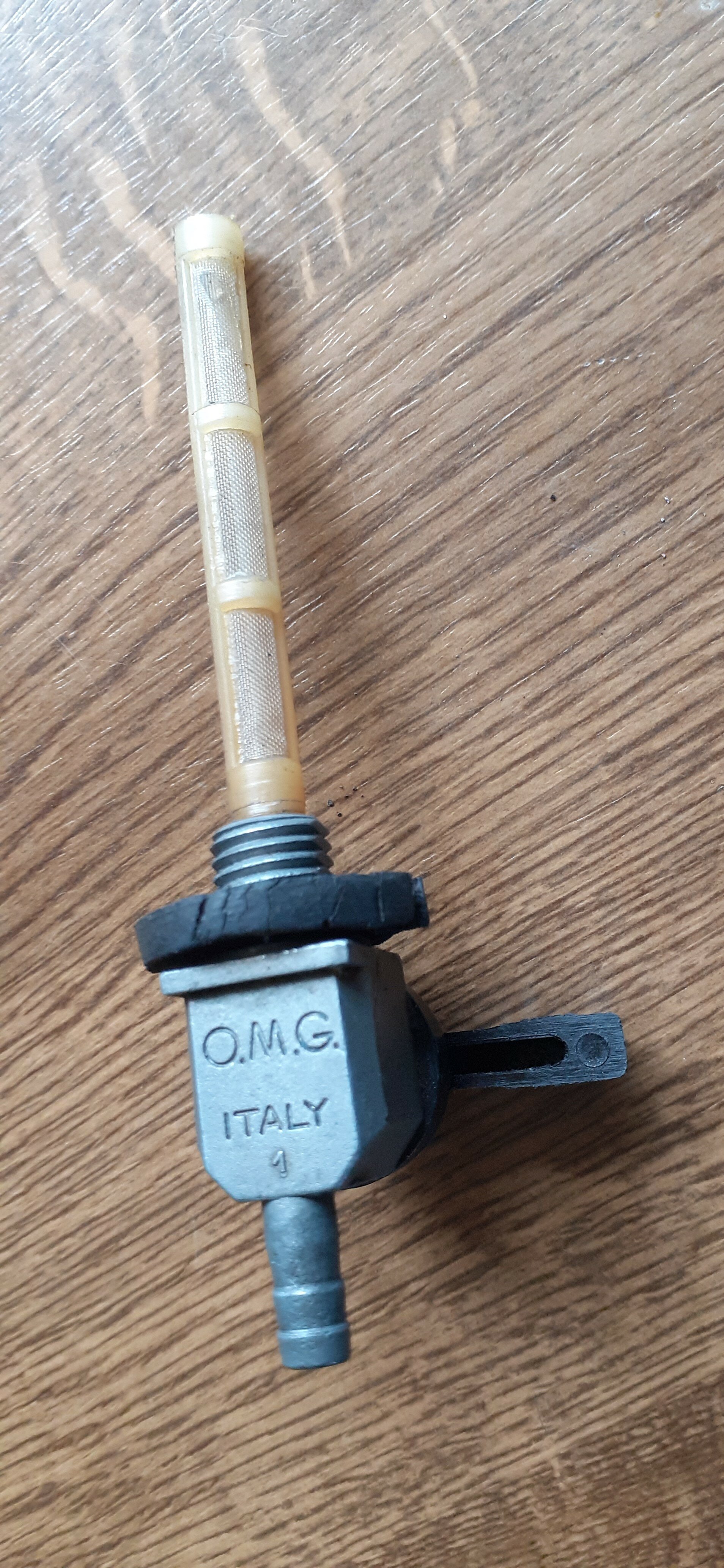

borderlord Posted May 23, 2022 Report Share Posted May 23, 2022 My petrol tap has failed and was wondering if these are diaphragm operated???? The flow of petrol to the carb just stopped. Tank is full of petrol........everything is clean...... Thanks Borderlord Quote Link to comment Share on other sites More sharing options...
Old Gezzer Posted May 23, 2022 Report Share Posted May 23, 2022 Hi, Inmotion have them in stock. https://www.inmotiontrials.com/product/petrol-tap/ 1 Quote Link to comment Share on other sites More sharing options...
bullylover Posted May 24, 2022 Report Share Posted May 24, 2022 Pull your tap apart and make sure it is clean inside the tap. The bit that turns it on and off again should come out. The tap rubber often gets old and rotten. 2 Quote Link to comment Share on other sites More sharing options...
