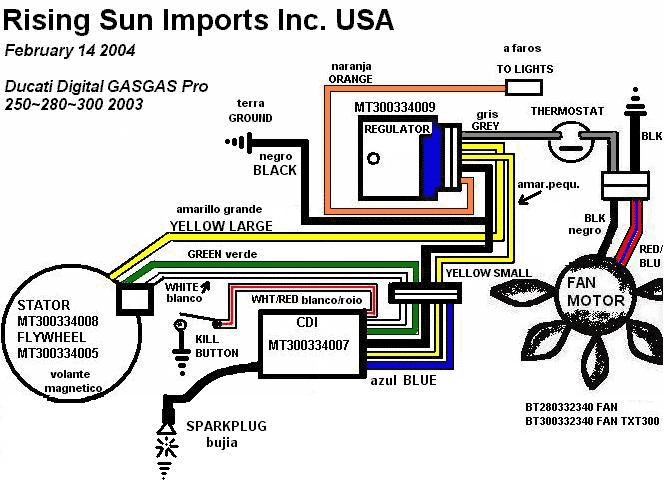

holdk2 Posted June 4, 2022 Report Share Posted June 4, 2022 Hi All, I've just bought a non runner Gas Gas TXT 250 and i have a couple of questions if anyone can help. There is two wires going to the airbox what just pulled out of the box when giving the bike a service what do these do and what are there function...? and I'm after fitting a kill switch has anyone got a wiring diagram pls. Kind Regards Kev Quote Link to comment Share on other sites More sharing options...

holdk2 Posted June 5, 2022 Author Report Share Posted June 5, 2022 @faussy2003 TXT pro what's the difference from the TXT pro to TXT pls Quote Link to comment Share on other sites More sharing options...
faussy Posted June 6, 2022 Report Share Posted June 6, 2022 On 6/5/2022 at 10:12 AM, holdk2 said: @faussy2003 TXT pro what's the difference from the TXT pro to TXT pls Different ignition. This should be yours Quote Link to comment Share on other sites More sharing options...
