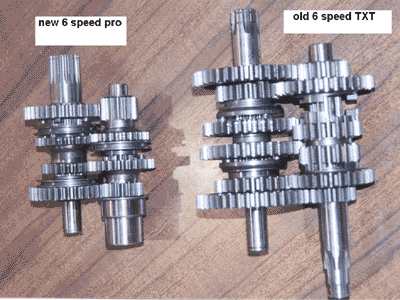

rhaines Posted February 22, 2006 Report Share Posted February 22, 2006 I have read somewhere that the gearbox clunks because of the design of the new four/ six pro gearbox(uses less cogs and still gets six gears). I will try to attach a piccy to this post which shows the inside of the gearbox and there is one on the web somewhere of this photo but with lines on showing how it mixes and matches the cogs to get the six gears. In the article that I read it said the gear changes could be improved by de-burring all the edges of the gear selector drum etc. hope this helps Quote Link to comment Share on other sites More sharing options...
magicmat Posted February 23, 2006 Author Report Share Posted February 23, 2006 is there actual burr ? or would you just round the edges ?? to be honest id rather not too that and live with a noiser gearbox, expensive if you mess it up !! wouldnt mind a read of that article tho Quote Link to comment Share on other sites More sharing options...
rhaines Posted February 23, 2006 Report Share Posted February 23, 2006 I assume they just mean the raggy edges from the castings but not 100%.I looked again for the article last night but couldnt find it, but Im sure it was on one of the american sites. Quote Link to comment Share on other sites More sharing options...
