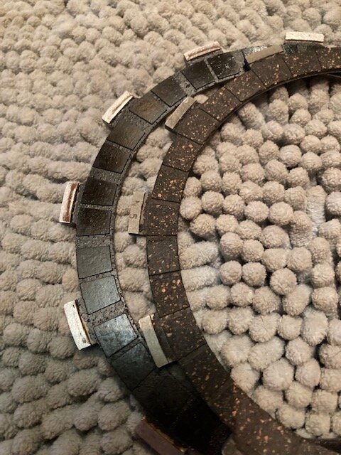

dobbin22 Posted June 16, 2022 Report Share Posted June 16, 2022 1975 TL250 clutch friction plates - 22201-286-010 and 222-286-000 part numbers. (One part number appears to have replaced the other). I'm replacing the friction plates. The part number I ordered, 22201-286-010 is not as wide as the plates in my clutch. The originals are 11.40mm while the replacement plates (22201-286-010} are 9.30mm Anyone changed out their original friction plates for new ones? And what part number did you use? I can put them in and give them a try, but I'm loosing friction surface. Which will probably translate into less clutch grip. I appreciate some ideas from those who've changed their clutch plates. Thanks. Regards, Dobbin22 Quote Link to comment Share on other sites More sharing options...
lineaway Posted June 17, 2022 Report Share Posted June 17, 2022 I show 22201-376-000 are the correct plates. Quote Link to comment Share on other sites More sharing options...
dobbin22 Posted June 17, 2022 Author Report Share Posted June 17, 2022 - I show 22201-376-000 are the correct plates. - Thank you. Three part numbers. Ordered the 22201376000 and will check the width. 22201286010 22201369000 22201376000 Regards, Dobbin22 Quote Link to comment Share on other sites More sharing options...
