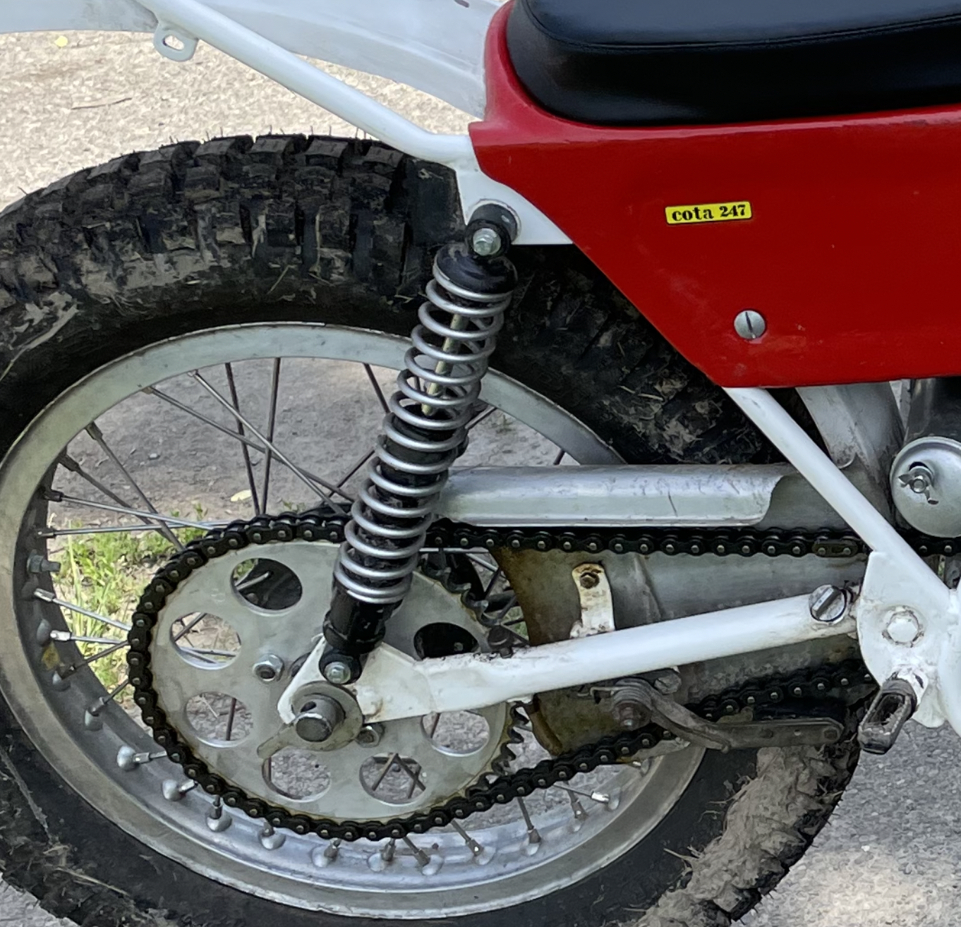

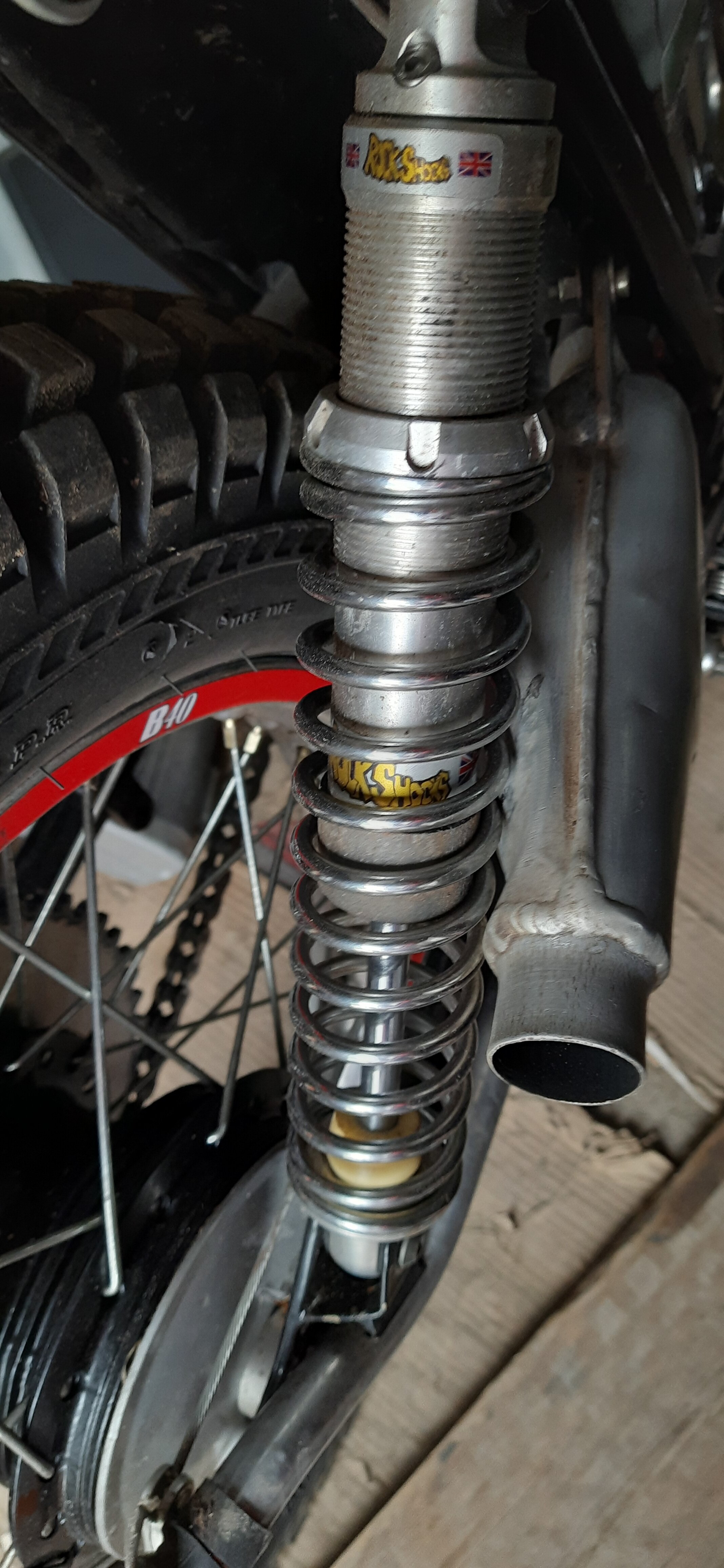

Niro Posted June 25, 2022 Report Share Posted June 25, 2022 A little background: Me- 6ft. weight 175lb with gear. Bike- 1970 Montesa Cota 247 with unknown brand of rear shocks. The shocks can be adjust, but I can't turn the adjuster. See photos. Skill level- beginner. where- riding in vintage trials competitions in woods with a lot of uphills and downhills. Goal- keep getting better and score more points. Budget- unfortunately tight. I don't want to spend more than 200GBP include shipping to USA. At first I was intrigue by the OZO "Expert" shocks. The price is 90GBP before shipping and they seems good upgrade for trial competitions. Then I start reading and found out a world full of rear shocks upgrade. Unfortunately most of them is out of reach. One that I can afford is the steel version of Falcon with 50LB spring (according to their recommendation). I would like please to read any thoughts of which shocks are preferred or maybe something I'm missing. Thanks Quote Link to comment Share on other sites More sharing options...
