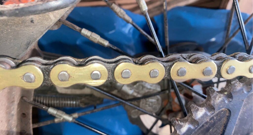

faussy Posted July 2, 2022 Report Share Posted July 2, 2022 Also what width of chain did you put on. Ive seen people put mx chains on and the width has caused the split link to hit the chain tensioner arm Quote Link to comment Share on other sites More sharing options...

Glayne Posted July 4, 2022 Report Share Posted July 4, 2022 From that short clip the rattle seems a touch intermittent? Is the master link catching on something? As advised above it certainly sounds chain related, could the wheel be installed any straighter? 9 second video of that is making me want to figure it out! Quote Link to comment Share on other sites More sharing options...

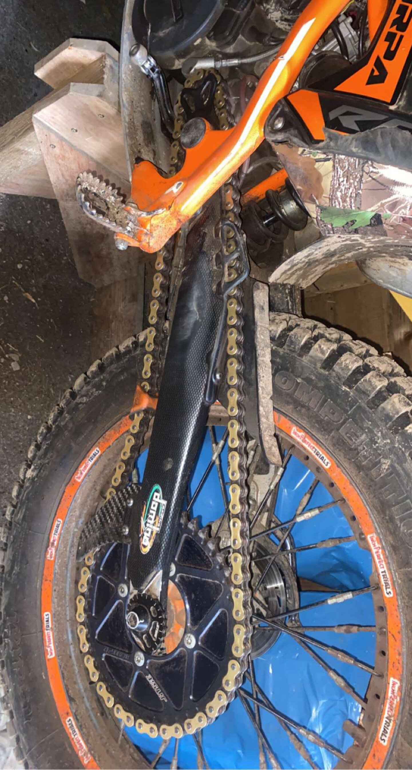

Nukeproofmule Posted July 4, 2022 Author Report Share Posted July 4, 2022 19 hours ago, feetupfun said: The noise disappears when you pull the clutch in because that takes the tension out of the chain which allows the chain to move under the effects of gravity and inertia rather than being pulled into a straight line by the motor. When the clutch is out, one run of the chain is tight and the other is loose - under motor drive the top is tight and the bottom is loose. Under overrun, the bottom is tight and the top is loose. When you pull the clutch in and ride along, both runs are loose and the chain flaps around more. Ahh okay that makes a lot of sense actually…I can’t see any clear signs of the chain catching any metal on the frame or swing arm though. Only thing i did notice is that the outside faces of the chain links look polished from what I think must be passing through the tensioner block. The tensioner arm has a bit of side to side movement and is quite easy to push up down. Maybe both of these are contributing to a nasty noise? @Glaynehaha yeah it’s bugging me too, chain & wheel seem to be nicely in line and spin freely with the bike in a stand. Quote Link to comment Share on other sites More sharing options...

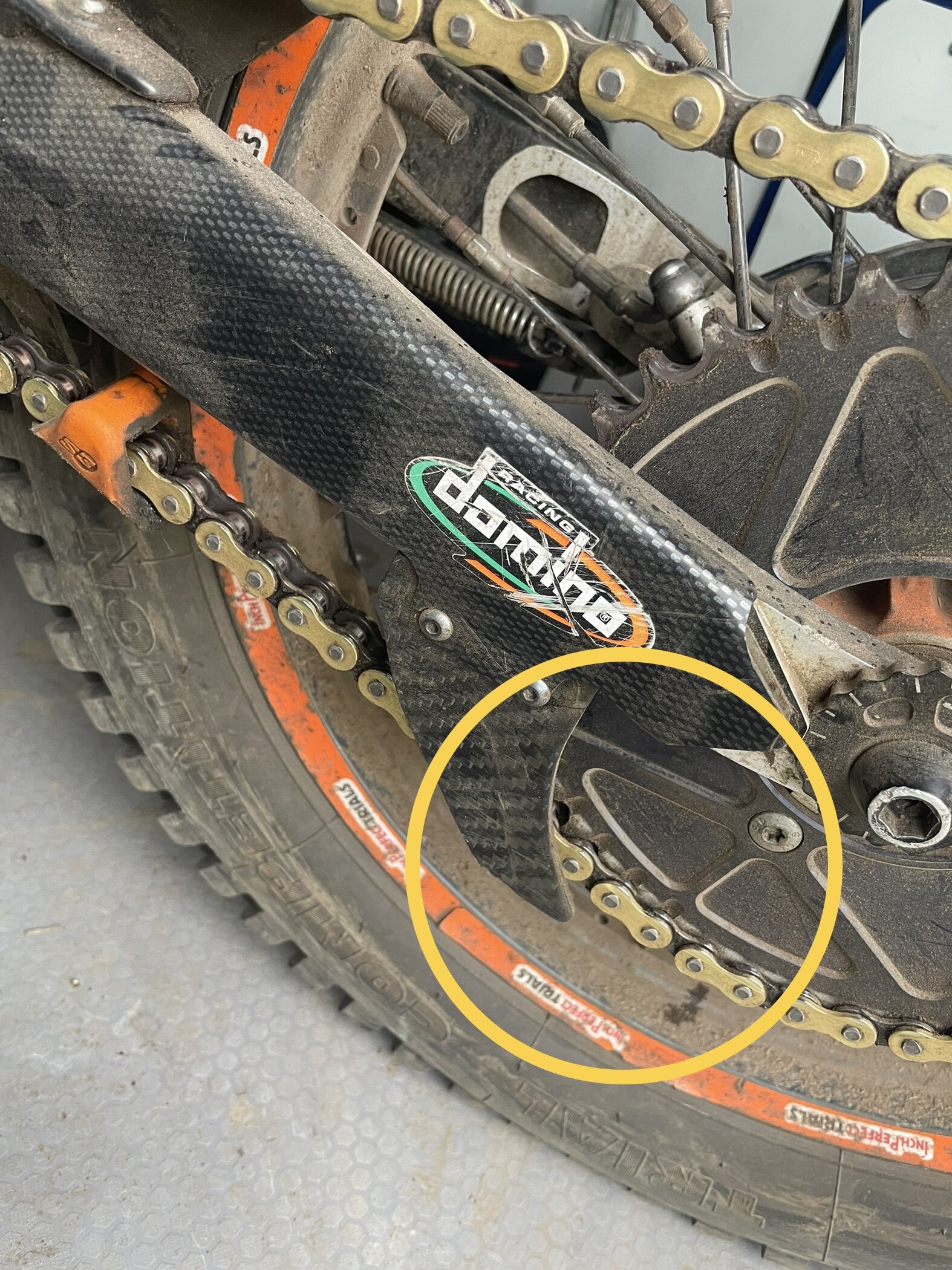

Nukeproofmule Posted July 14, 2022 Author Report Share Posted July 14, 2022 @Glayne @feetupfun Not sure if you guys are still interested but I’ve found where the noise is coming from. Chain is clacking off the bottom of the rear sprocket. I have the chain tension set so the top of the tensioner block is about 20mm from the under side of the swing arm but might try a bit tighter to see if the noise goes away. do the chain tensioner arm springs wear out over time and need replaced? Chain guide does also seem to be sitting at a slight angle so it’s maybe taken a bash off a rock at some point Quote Link to comment Share on other sites More sharing options...
Glayne Posted July 14, 2022 Report Share Posted July 14, 2022 Good find, I would start getting the chain guide straight or replaced. I would imagine just about any spring gets fatigued over time, I have not had to replace mine...yet... Quote Link to comment Share on other sites More sharing options...
