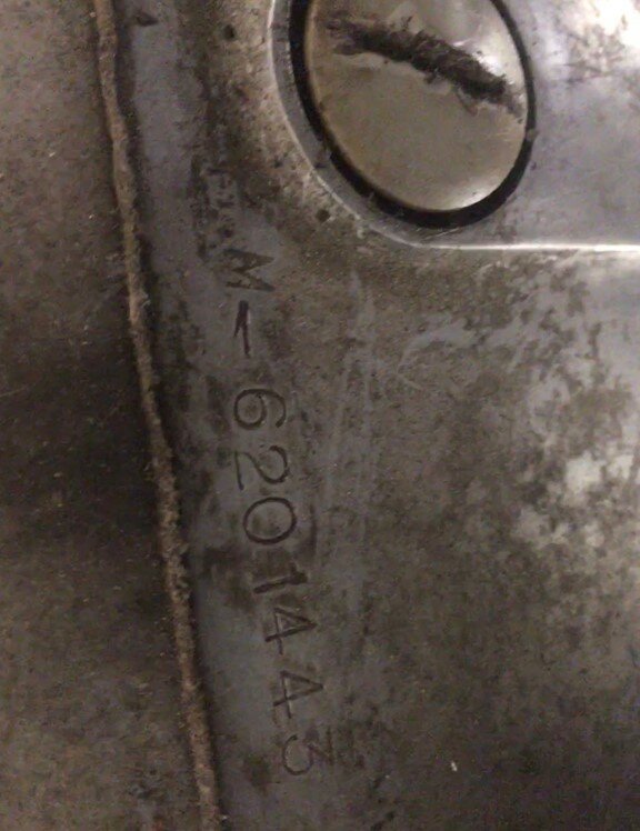

jofritz Posted July 12, 2022 Author Report Share Posted July 12, 2022 well, to give you guys a first pic (to make sure it even is a Lobito) As far as I was diving into it, it should be around '68 to '70, any hints welcome!!! Quote Link to comment Share on other sites More sharing options...
motovita Posted July 12, 2022 Report Share Posted July 12, 2022 That engine case is from a Sherpa Scrambler 125, 68-69 vintage. Quote Link to comment Share on other sites More sharing options...
jofritz Posted July 12, 2022 Author Report Share Posted July 12, 2022 Checked it as a Lobito 125 MK3 1970-1972 starting at 62.000.001 so 1443 should be still 1970 as it is a rather low one... well not so many built, but beeing 1970 myself, I like the thought of it... 1 Quote Link to comment Share on other sites More sharing options...
feetupfun Posted July 12, 2022 Report Share Posted July 12, 2022 3 minutes ago, jofritz said: Checked it as a Lobito 125 MK3 1970-1972 starting at 62.000.001 so 1443 should be still 1970 as it is a rather low one... well not so many built, but beeing 1970 myself, I like the thought of it... Well the right hand side engine casing is from a Mk3 Lobito. A proper ID of the bike (and the motor) needs decent photos of the bike and the motor Quote Link to comment Share on other sites More sharing options...

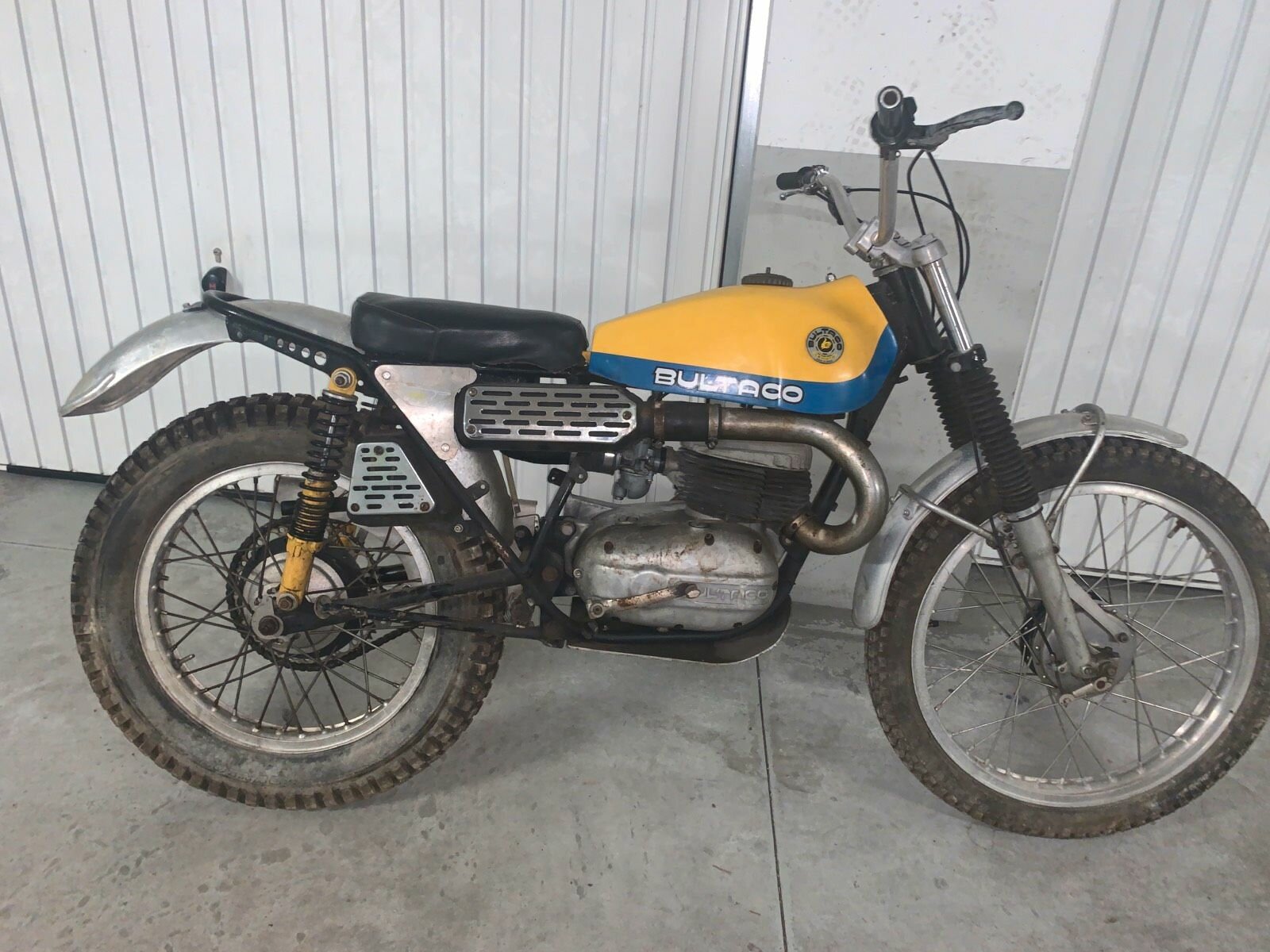

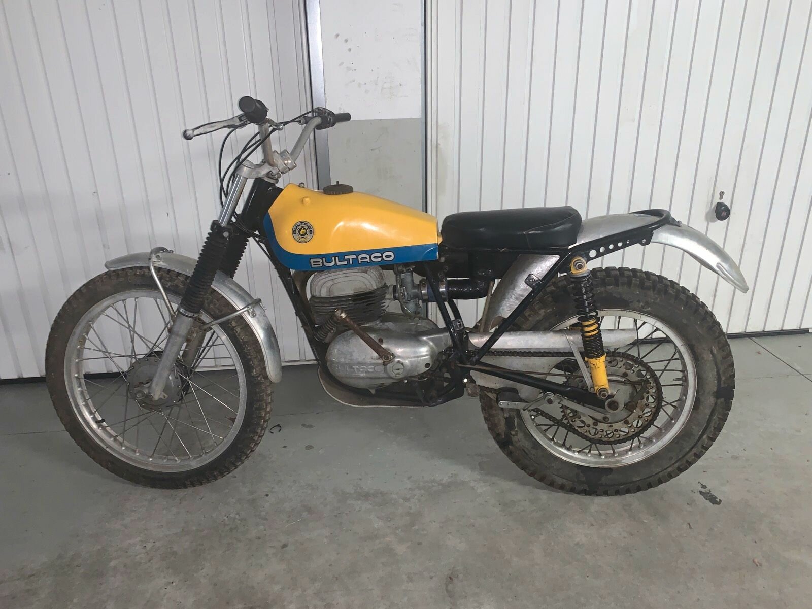

jofritz Posted July 14, 2022 Author Report Share Posted July 14, 2022 so here are the "before" pics and it already looks great even without cleaning... we will see how far it will go with some cleaning and taking care of the alloy parts. Quote Link to comment Share on other sites More sharing options...
