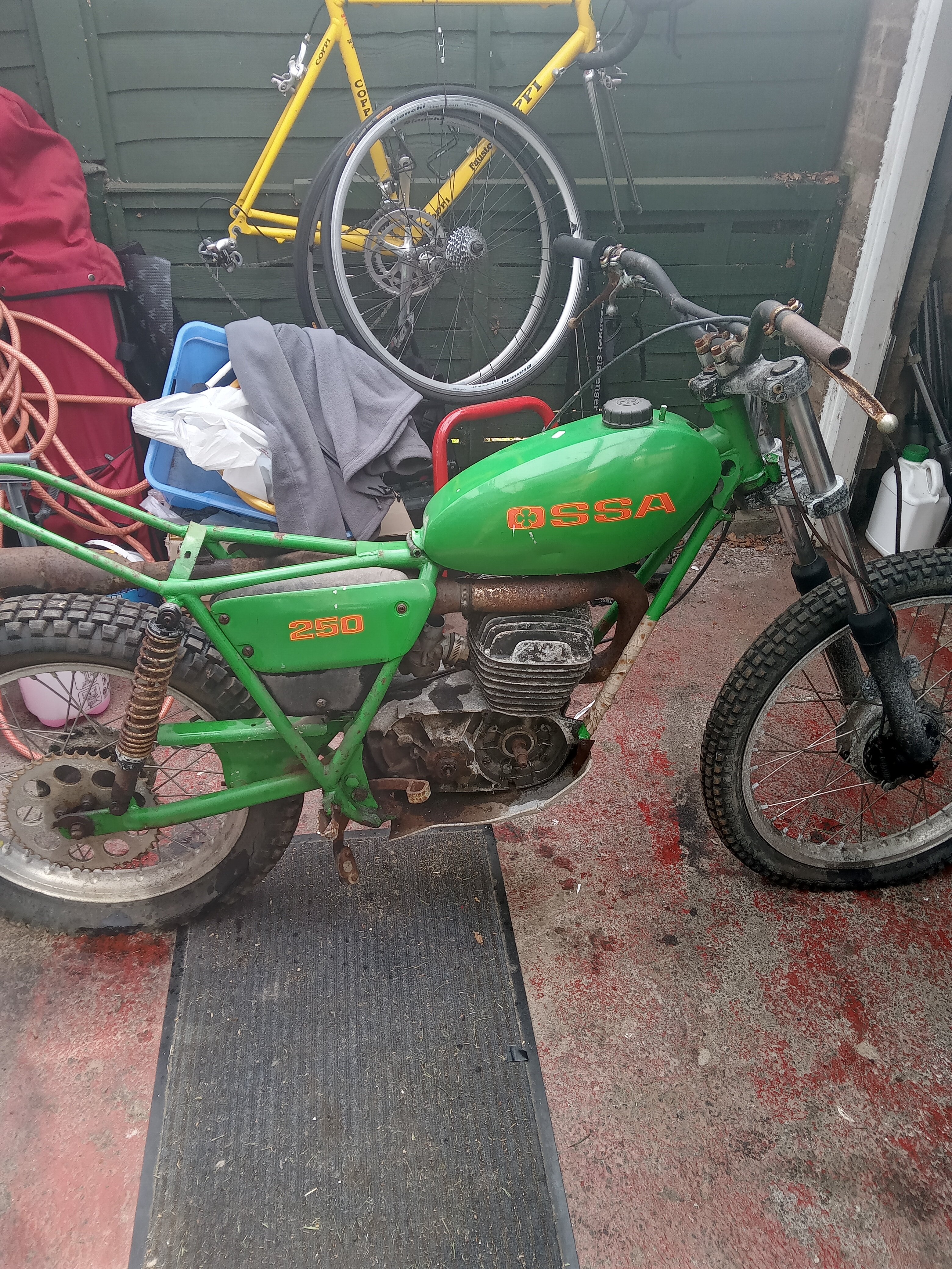

ColinPybus Posted August 10, 2022 Report Share Posted August 10, 2022 Is it possible to fit an electronic ignition to a 1975 Ossa 250 MAR? If so where can I get one ? Failing that has anybody got a points ignition set in good condition that I could buy? I'm based in England . TIA Quote Link to comment Share on other sites More sharing options...

ColinPybus Posted August 11, 2022 Author Report Share Posted August 11, 2022 Thanks for the replies. I have seen the electronic ignition system from In motion, but it's says not for points system flywheels. I assume this means I need a different flywheel? Are these readily available? Thanks again for your help. Quote Link to comment Share on other sites More sharing options...
feetupfun Posted August 11, 2022 Report Share Posted August 11, 2022 1 hour ago, ColinPybus said: Thanks for the replies. I have seen the electronic ignition system from In motion, but it's says not for points system flywheels. I assume this means I need a different flywheel? Are these readily available? Thanks again for your help. option 1. Buy a non-points OSSA flywheel and the In Motion ignition option 2. Buy an ignition from somewhere else https://www.francetrialclassic.com/en/ignition/5010-ossa-250-350-electronic-ignition.html Quote Link to comment Share on other sites More sharing options...
ColinPybus Posted August 11, 2022 Author Report Share Posted August 11, 2022 Yes I've seen the French one as well. Any idea where I'll get a non points flywheel or is it just a case of continually trawling the internet? Thanks again. Quote Link to comment Share on other sites More sharing options...
feetupfun Posted August 11, 2022 Report Share Posted August 11, 2022 I don't have a non-points MAR flywheel for sale at the moment. Aren't there any OSSA specialist parts people in the UK? There are some in the US who would probably have what you want. What's wrong with your points ignition? I've never seen an MAR with points ignition to know what other bike shared the same stator setup. Maybe it's something common Quote Link to comment Share on other sites More sharing options...
ColinPybus Posted August 11, 2022 Author Report Share Posted August 11, 2022 The problem I have is that there's no ignition system at all with the bike! 1 Quote Link to comment Share on other sites More sharing options...

fourex Posted August 12, 2022 Report Share Posted August 12, 2022 I don't think Electrex World does anything for Ossa, but looks like Vape do. https://www.vape.eu/ossa I'm curious, why did Ossa MAR's originally have electronic ignitions and then why revert back to points, were their electronic ignitions unreliable? Quote Link to comment Share on other sites More sharing options...
ColinPybus Posted August 12, 2022 Author Report Share Posted August 12, 2022 I think they had points originally, I've got nothing on the ignition side of the crank so refitting an electronic ignition would make more sense. Thanks for the info. Quote Link to comment Share on other sites More sharing options...
fourex Posted August 12, 2022 Report Share Posted August 12, 2022 1 hour ago, ColinPybus said: I think they had points originally, I've got nothing on the ignition side of the crank so refitting an electronic ignition would make more sense. Thanks for the info. Colin, my '74 MAR mk2 has electronic ignition standard, hence the question of others why they went to points in '75. Check out the Vape site, it looks like they can solve your problems, if not others will chime in. https://www.vape.eu/ossa Quote Link to comment Share on other sites More sharing options...
woody Posted August 12, 2022 Report Share Posted August 12, 2022 All of the trials bikes had electronic up to the TR77 which went to points, then back to electronic on the Grippers. There are two types of electronic and the firing point pick-up is in a different location on each. On MK1 MAR and early MK2 the flywheel/stator have a small hole for the pin to set the timing at about 8 o'clock and the stator is a hexagonal shape, from about 1974/5 the later round type was fitted with the timing position at about 5 o'clock, so the flywheel and stator have to be the same type. If you look at just a flywheel on its own, with the keyway at 12 o'clock you see the small hole for the pin in the flywheel face in the positions mentioned. The electronic or points systems can be fitted to any of the MAR / TR77 / Gripper, the crank taper and stator fixing are the same on all, just the correct combination of flywheel/stator is needed There was a flywheel on ebay a couple of days or so ago which I think was the later type although I noticed on In Motion they state the later type ignition is no longer available, not sure why as I thought it would be the same set up, just a different position for the pick up You could try Martin Rickman as he has used MAR parts, you can find him on facebook under that name or this is his website https://www.idleride.co.uk/?fbclid=IwAR2NXBx1sRRmAfMsfOYEsqIWzeQG9NxHNjS32jWA2FcnggLmipw2KSfKFNw Or maybe Gary Warr who runs Ossa Stuff in the UK might have something, he races Phantoms but might have used MAR parts https://www.ossastuff.com/ 2 Quote Link to comment Share on other sites More sharing options...
