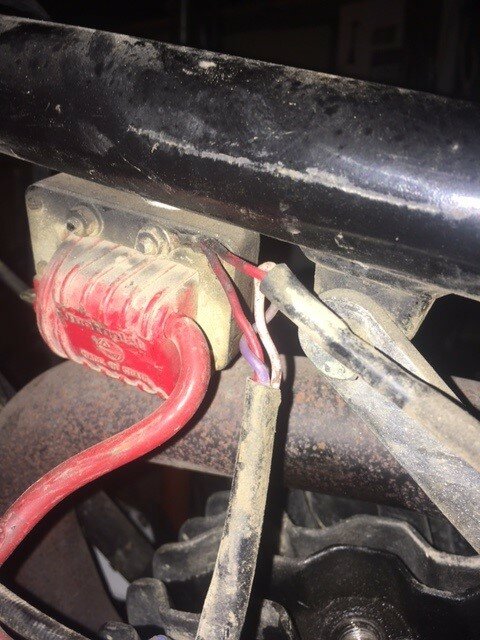

jofritz Posted August 13, 2022 Report Share Posted August 13, 2022 Hi there, last activities in the Bultaco section... but now talking about my latest Montesa. There is no sparc so I decided to take things off to simplify the lot. No lights, horn, switches ... and ended up with 4 cables comming from the engine... all pink, burgundy and puple cables gone (never seen that before 🙂) Now, I would expect the black going to the coil, the red from the lighting was to ground, but will be gone, once I managed to open up the little nut on the bracket... so I have a green, white and yellow left... on my Bultaco it is the green one to earth... for the Montesa I could not find anything to help me sorting things out yet. Any help welcome... Quote Link to comment Share on other sites More sharing options...

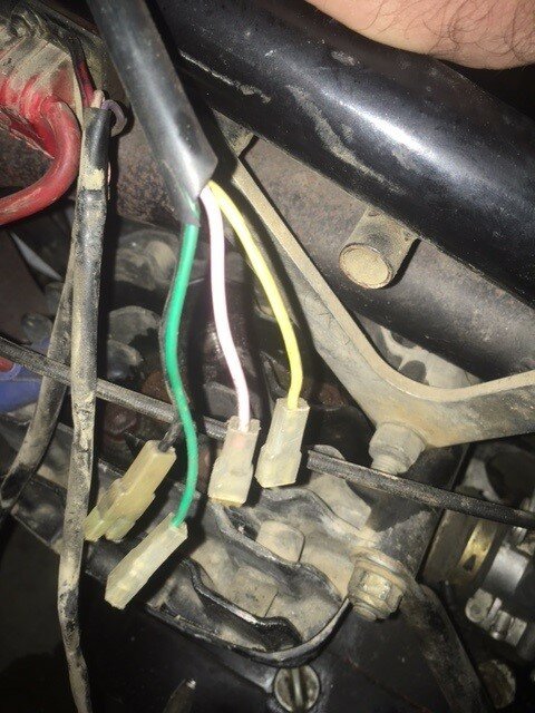

jofritz Posted August 14, 2022 Author Report Share Posted August 14, 2022 had a closer look at daylight... the white is PINK... so still 80s 🙂 So my earlier mail should state: I have 4 cables from the engine: black green yellow and PINK which one needs to be grounded on the coil bracket? Quote Link to comment Share on other sites More sharing options...

jofritz Posted August 14, 2022 Author Report Share Posted August 14, 2022 (edited) Hi Ian, thanks again... but as I said... I don't really get it... pink to "stop" (break-switch rather than kill switch?) green to horn (...) yellow to where? ends some place in the handlebar switch and goes on in some other color... Now red (which is history on my bike) came from all lights (front and back) and was grounded out ont the coil bracket... so what shuld I put there instead??? Edited August 14, 2022 by jofritz Quote Link to comment Share on other sites More sharing options...

jofritz Posted August 31, 2022 Author Report Share Posted August 31, 2022 (edited) Hy guys and thanks so far... Been on holidays and now staring again working on the Montesa. Don't yet get it... Black to coil, kill switch and condenser. So far understood. On my bultaco the green from the magneto goes directly to ground (bracket on coil) on the Montesa I have the red wires comming from all sides of the lightsystem to be grounded on this bracket. So somehow it feels right to have a line from the kill switch back to the coil bracket (might as well be red) to ground the kill switch. But won't be any cable leading from the magneto to ground bracket directly? There must be some guys driving with ignition wiring only.. Edited August 31, 2022 by jofritz Quote Link to comment Share on other sites More sharing options...
jofritz Posted September 4, 2022 Author Report Share Posted September 4, 2022 After receiving a new hint I tried it. Black cable only, that is all it needs for running... and I have spark, but probably to weak for propper running. Will start using starter spray, revs up but does not run on the fuel supply. Engine stops after a few seconds, only managed to start it twice... what would you guys do next/first??? Thank you in advance... and greetings after some days at the beautiful cote-d'azur Quote Link to comment Share on other sites More sharing options...
