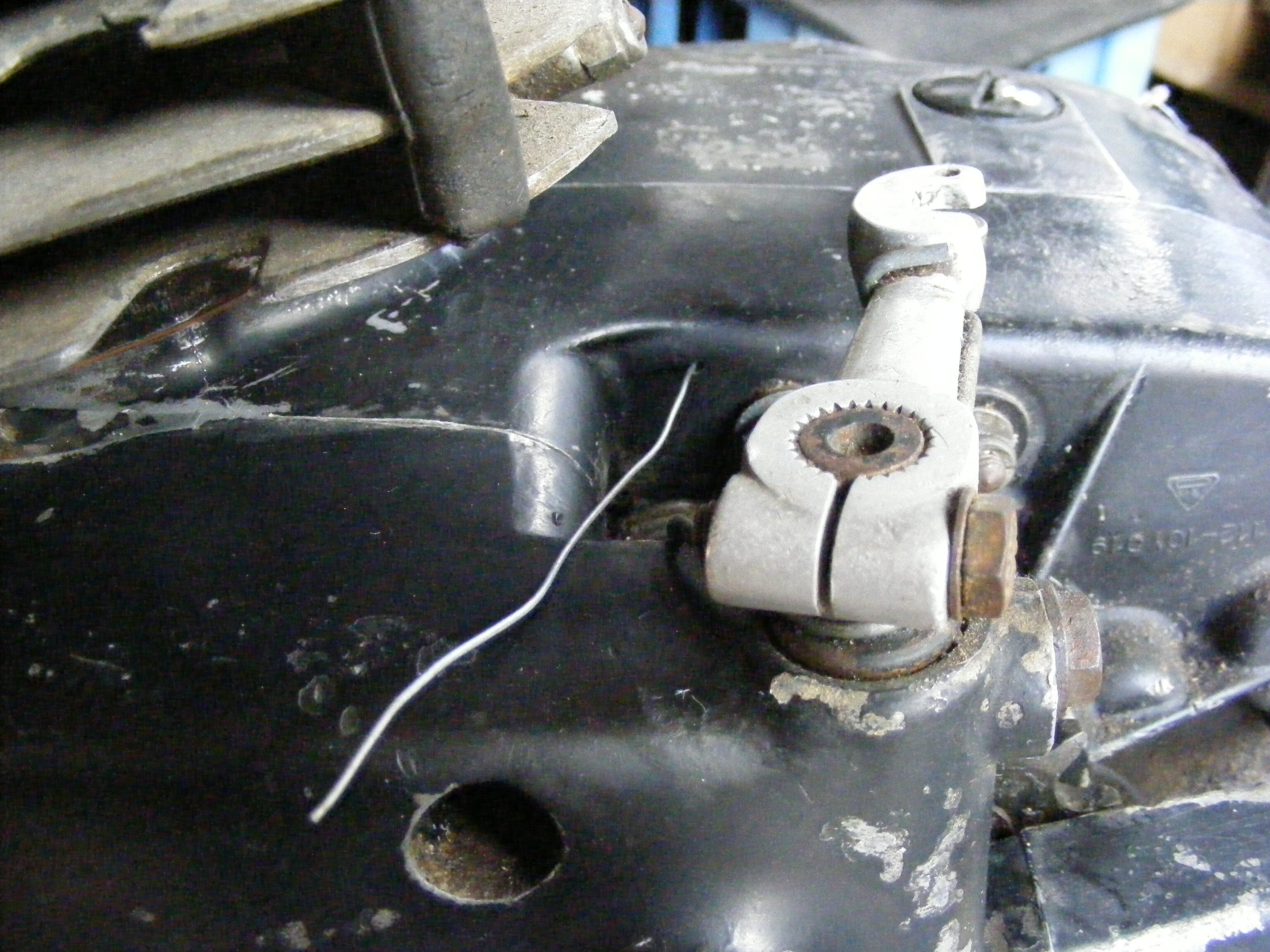

 If the leak persists, check that the gearbox breather is clear. It's a small hole high up on the left crankcase, just forward of the fixed end of the kickstart  spring. If this hole is blocked, some have found that this can cause an oil leak from the gearbox or worsen an existing one, especially when the motor gets hot.  (The air inside the gearbox will expand with heat, and it has to go somewhere, I suppose..........)
On this 199 engine I've pushed a piece of wire into the breather to make clear its position :-
HTH
