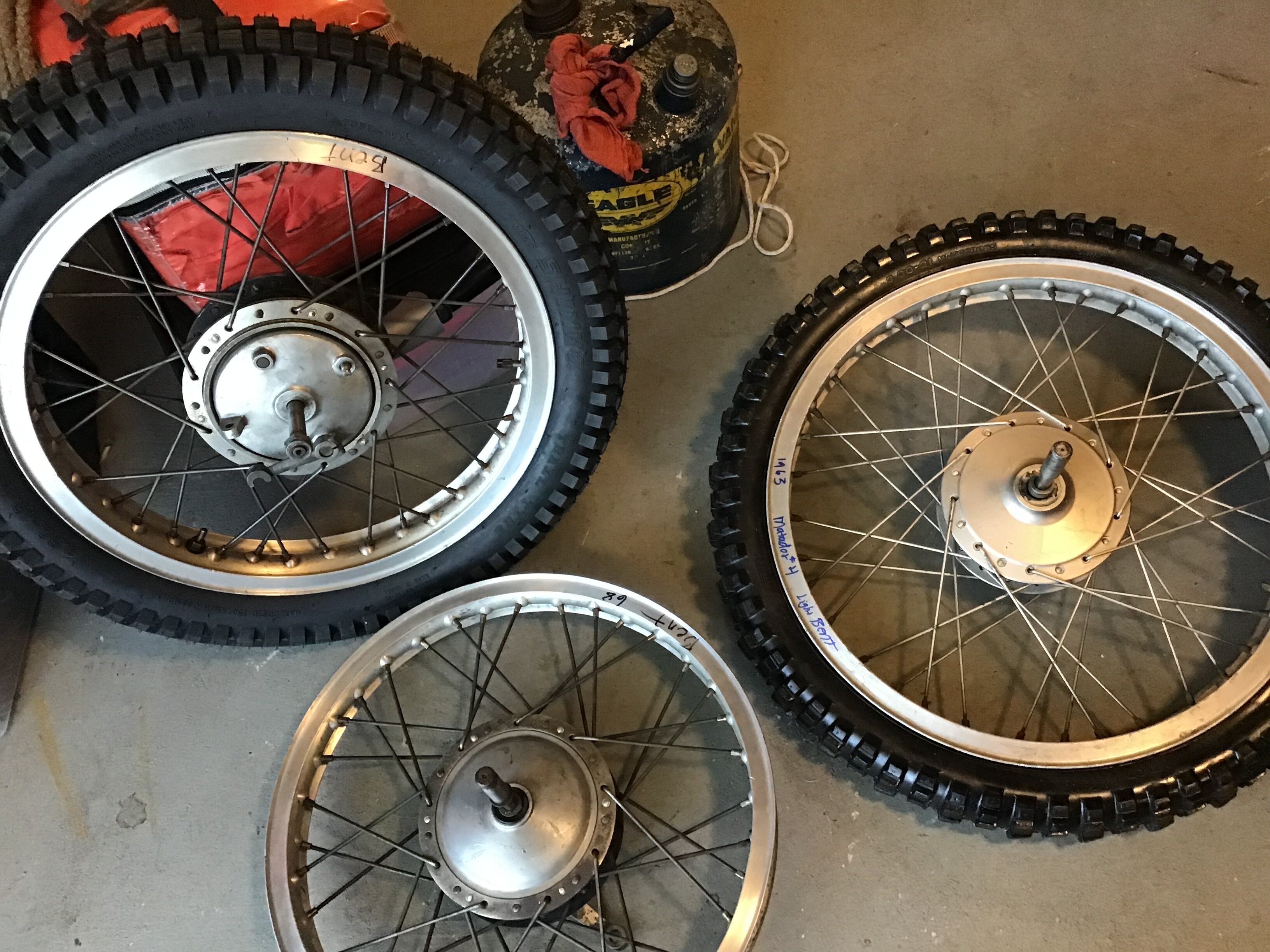

larry s. k. Posted September 6, 2022 Report Share Posted September 6, 2022 Wheels,,, all three of these wheels are bent , don’t know what to think dirt bike used equals # , always check front wheel , up in the air spin around , c k , , and I purchased some tires on flee bay , new , shrink is one brand will never purchase again 2 tires deformed , upon installing , was 50 $ dollar tire new , both same brand deformed ,, upon installing on rim ,, think there made in Asia Taiwan ,, , if I do math that 3 new tires cost 150. USD deformed , upon purchase flee bay , $ and having problem with bent rims ,,,,,, fk fkfk,,,,,, , some of these are for my mk 4 mod 68 pursang , it runs , ,,,,,, CHEERS Quote Link to comment Share on other sites More sharing options...

stpauls Posted September 7, 2022 Report Share Posted September 7, 2022 Easy enough to sort out a bent wheel rim. Youtube is your friend here. Don't waste money on buying cheap tyres. Quote Link to comment Share on other sites More sharing options...
teamferret Posted September 7, 2022 Report Share Posted September 7, 2022 I can't see clearly from the photos, but are you sure the tyres are seated on the rim correctly it looks like the bead might still be off the rim and in the centre depression. It's common with off road tyres that they don't want to come back on the rim properly and you have to deflate soap up the bead then reinflate even as high as 80PSI 1 1 Quote Link to comment Share on other sites More sharing options...
Glayne Posted September 7, 2022 Report Share Posted September 7, 2022 On 9/7/2022 at 8:36 AM, teamferret said: I can't see clearly from the photos, but are you sure the tyres are seated on the rim correctly it looks like the bead might still be off the rim and in the centre depression. It's common with off road tyres that they don't want to come back on the rim properly and you have to deflate soap up the bead then reinflate even as high as 80PSI Expand ...and be very careful at 80PSI, air can be very scary... Quote Link to comment Share on other sites More sharing options...
larry s. k. Posted September 7, 2022 Author Report Share Posted September 7, 2022 Hi all , I carfually installed with dish soap water ,add air , drain air , go to 20 psi ,ck , then 25 psi , to 35 psi , , I must have purchased a run of bad tires , on sale mf Shinko ,,,,,there all over ebay , looks popular brand , well , one bubbled near valve tem , and would not seat on other end ot tire , one of other tires just would not seat ,, and pull up ,, these two where Shinko ,,,,the other brand is kenda , it just made a buble near stem area , ,, very mind blowing , all new tires from ebay , there were on sale 50$ usd each , I working on building a 121 pursang , have looking in my used parts front wheel , upon checking , , installing spinning each , , just found more work , like rebuilding a new front wheel , , trials bikes , I sure are very hard on front rims , go up creaks full rocks pot holes , guys thanks for the tips , cheers Quote Link to comment Share on other sites More sharing options...
