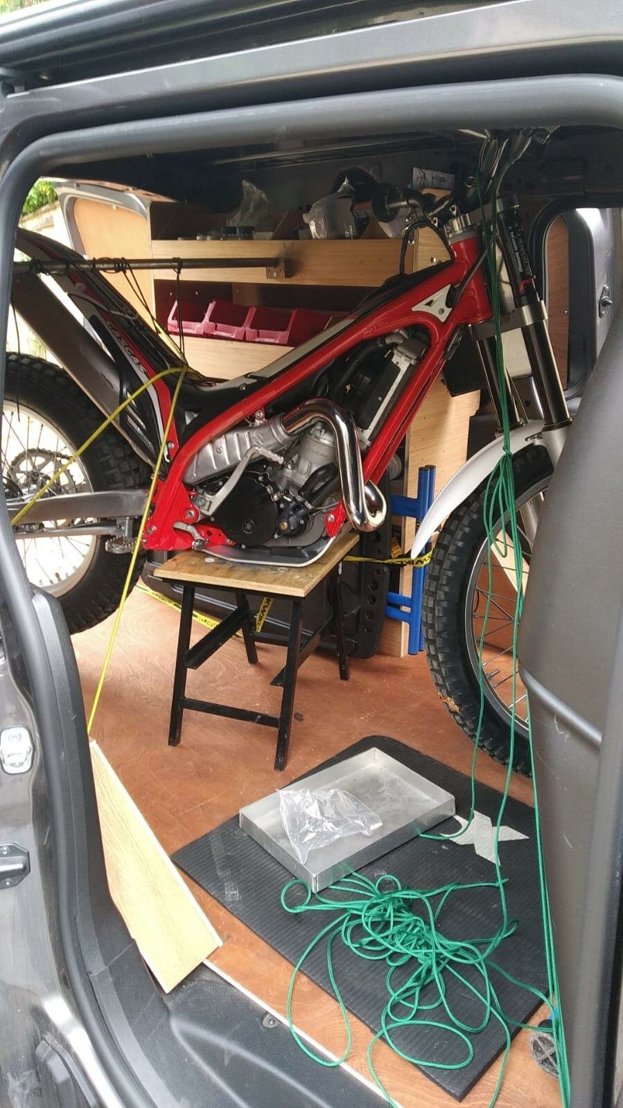

GonkDroid Posted September 25, 2022 Report Share Posted September 25, 2022 (edited) Helloo, I've just bough a Gasgas 125 (2009) off ebay and I cant get the thing to start. During purchase it wouldn't start either but im confident that, in a few months, with your help, it'll fire up!! Here is what I know: bike looks good, its got a carburettor and a spark plug. compression seems fine. There is fuel in the tank. It's been left for a while unused. Ill try to add some pics - Please could any one give me some simple tips. Somewhere to start in terms of getting this thing started. So far I have mainly tried: full choke. half/full throttle, kicking the hell oot of it till I'm knackered. Edited September 25, 2022 by GonkDroid spells Quote Link to comment Share on other sites More sharing options...
