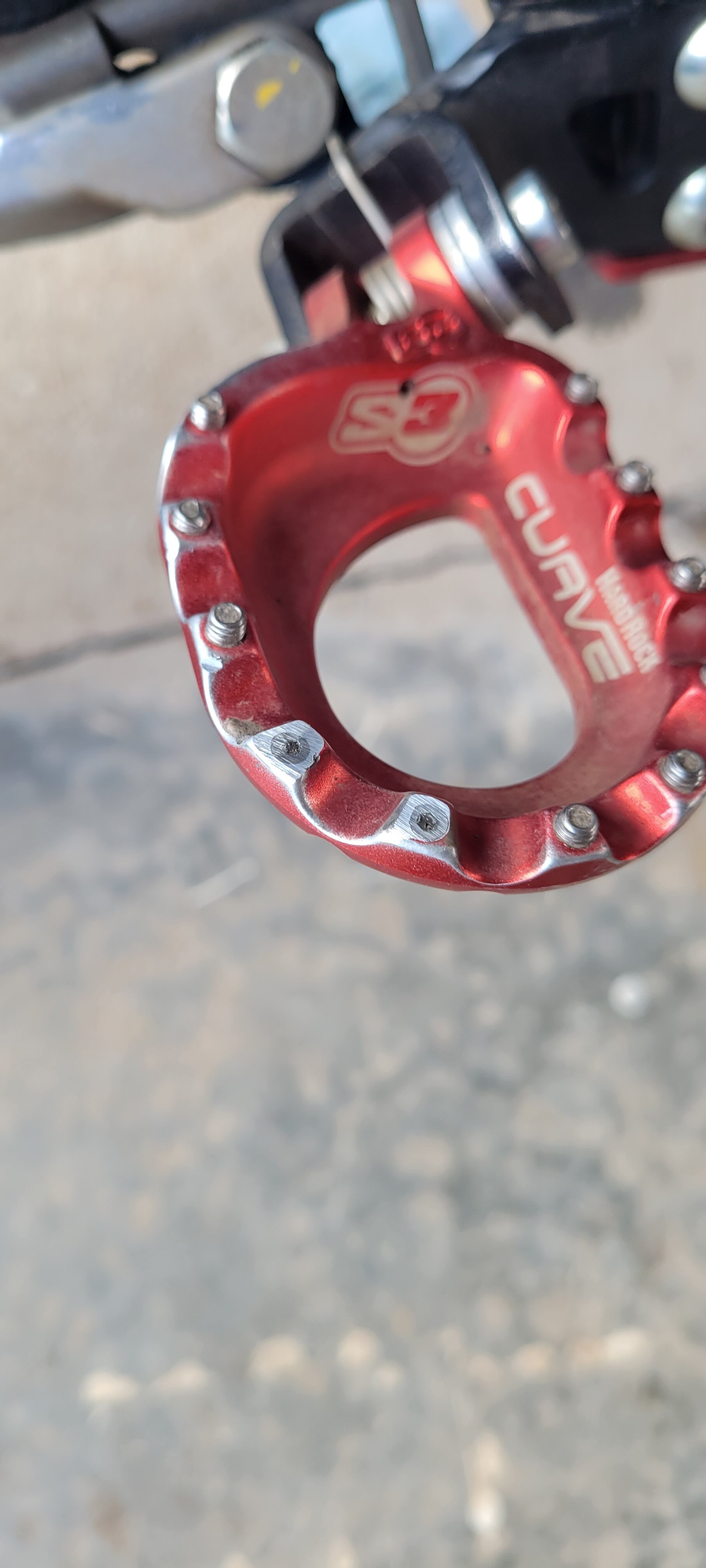

Cota300rr Posted September 28, 2022 Report Share Posted September 28, 2022 I have a 2107 Cota 300RR, and whenever I kick her over the lever hits the footpeg. I put new pegs on and the lever is damaging them a bit, as well as the lever itself is getting chewed up. It seems impossible to stop the kick before the peg. I saw someone else on here had put a rubber piece on his. I have put a bit of rubber hose on it for now to help protect them, but the rubber is causing the lever to get stuck on the peg now. Is this normal for these bikes, and is there a solution? Thanks in advance. Quote Link to comment Share on other sites More sharing options...
lineaway Posted September 29, 2022 Report Share Posted September 29, 2022 Grind down the peg before it screws up the lever. Quote Link to comment Share on other sites More sharing options...
stpauls Posted September 29, 2022 Report Share Posted September 29, 2022 Bend the kickstart back to it's correct angle: Take the kickstart leaver off. Put it in a vice. Heat it up with a blowlamp, or preferably an oxyacetylene torch to a red colour, then bend it, perhaps using a long length of pipe. When you are happy with the angle then heat it up again to red, then quench it in a bucket of cold water to make it tough again. Simples. Quote Link to comment Share on other sites More sharing options...
Cota300rr Posted September 29, 2022 Author Report Share Posted September 29, 2022 Yikes I don't particularly like the idea of grinding my brand new pegs down but I guess if that's what it comes to.... The idea of bending the lever, that tells me that it isn't normally supposed to do this then? It seems like even the new ones that I tried at the dealership did it, but I thought maybe I'm kicking too far. It seems to take up that whole stroke to kick it over, though. I'll have to give this a go, rather than grinding down the pegs first. Thanks for the tips! Quote Link to comment Share on other sites More sharing options...
lineaway Posted September 29, 2022 Report Share Posted September 29, 2022 Well just remove the insert if they are new! Mine were destroyed. Quote Link to comment Share on other sites More sharing options...
Cota300rr Posted December 20, 2023 Author Report Share Posted December 20, 2023 To follow up on this old thread, I ended up sliding a piece of rubber coolant hose of the correct diameter over the end of the arm and safety wiring it on, It no longer sticks and I didn't have to grind anything or bend anything. Also makes the arm less slippy for kicking over. Maybe not as pretty, but it works. Cheers! 1 Quote Link to comment Share on other sites More sharing options...
lineaway Posted December 21, 2023 Report Share Posted December 21, 2023 Funny, I went back to the short lever. All is well being I am short too Worst thing is I had it in my spares all along! 1 Quote Link to comment Share on other sites More sharing options...
Cota300rr Posted December 21, 2023 Author Report Share Posted December 21, 2023 15 hours ago, lineaway said: Funny, I went back to the short lever. All is well being I am short too Worst thing is I had it in my spares all along! Oh isn't that just the way...glad it worked out for you! Quote Link to comment Share on other sites More sharing options...
