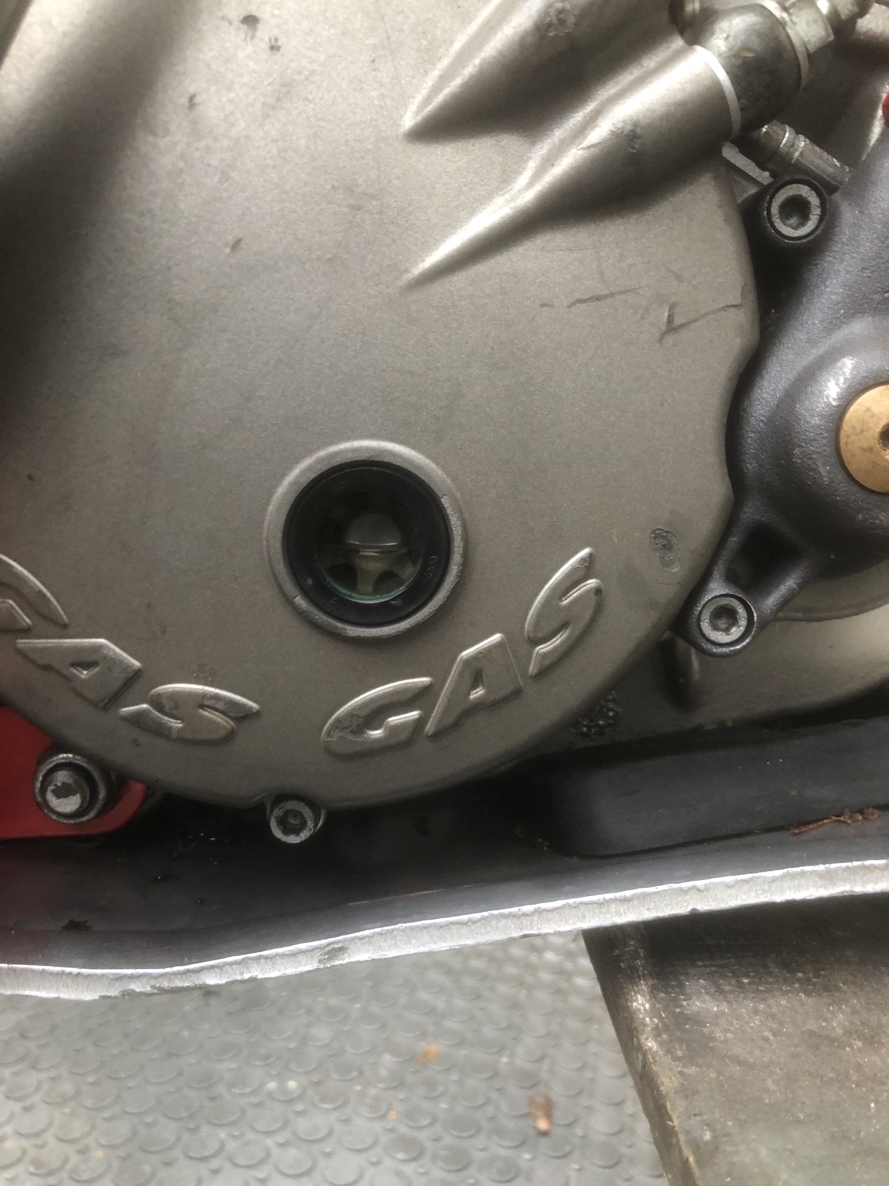

Teddydanson Posted October 23, 2022 Report Share Posted October 23, 2022 Hi all I’ve just done an oil change on my Gas gas txt pro 2013 300cc ive notice a little oil before on the bash plate, I’ve changed the oil and started her up, when I dropped it, there was 300ml ive topped up with 390-400ml its half way up the site glass ish. Problem I’ve noticed is when running, there’s a slight drip weep out of the clutch case bolt under the site glass? I’ve taken it out and check it.. but just wondering how or what it could be. thanks for any help Quote Link to comment Share on other sites More sharing options...

Strutty Posted October 25, 2022 Report Share Posted October 25, 2022 presume you have checked the casing for cracks from an impact or over-tightening? Also, check the bolt lengths are in the correct holes as some are a fair bit longer. Quote Link to comment Share on other sites More sharing options...
Teddydanson Posted October 25, 2022 Author Report Share Posted October 25, 2022 The lad who I got it off said it was leaking above the water pump, so I’m presuming the bolts are different lengths, and somebody hasn’t put them back correctly.. I’ve watched him snell ont YouTube, and there’s four different lengths, so I’ll drop the oil again and take them out, and check. The order. 👍🏻 Quote Link to comment Share on other sites More sharing options...
lineaway Posted October 25, 2022 Report Share Posted October 25, 2022 The longest seem to align with the dowel pins, two others with the water pump and then the rest are short. Most leaks on that cover are from the kick start seal. Good luck. Quote Link to comment Share on other sites More sharing options...
Teddydanson Posted October 30, 2022 Author Report Share Posted October 30, 2022 Just cleaned it all down, checked the bolts, and it is leaking slowly from the kickstart and obviously running down, it’s not fast but obviously it’s a leak. Does anybody know if it’s simply to change yourself? I’m going to look on Jim snells YouTube stuff. Thanks for any help. 👍🏻 Quote Link to comment Share on other sites More sharing options...

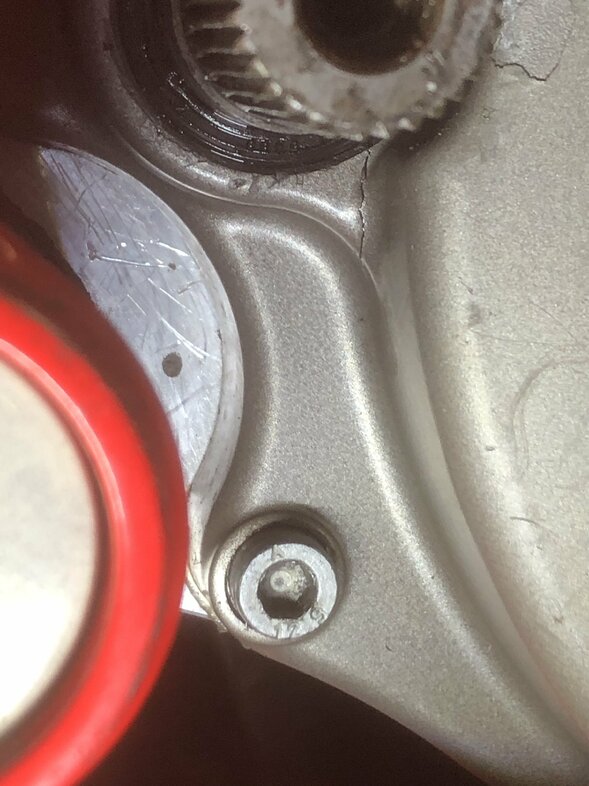

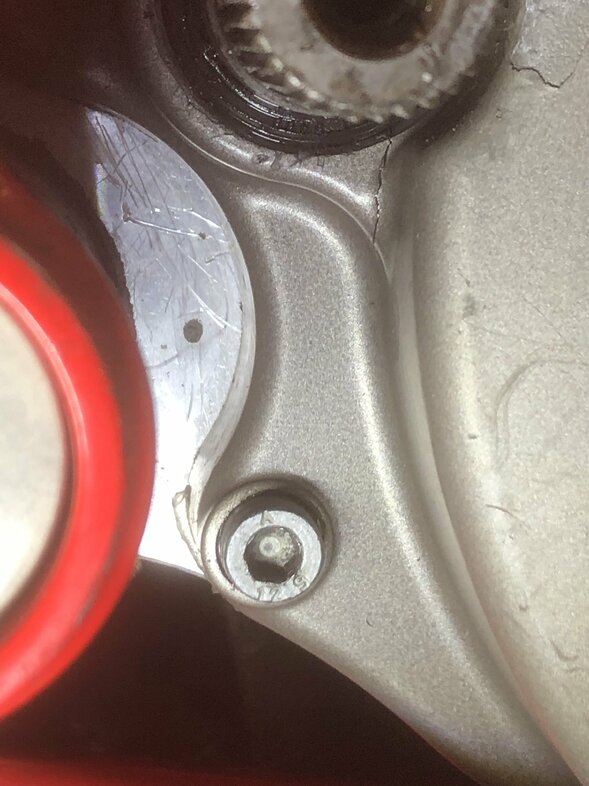

Teddydanson Posted November 6, 2022 Author Report Share Posted November 6, 2022 Finally had time to clean and have a proper look. Was just about to take the kicksart seal out and change, on closer inspection, just under the kickstart shaft, there’s a crack in the casting at about 4-5 o’clock position… bummer. I’m going to try some jb weld, but if not it’s a new case. Question is if I change , which I’m confident of doing, but just unsure about the clutch line next to the oil filler, Dino have to bleed out the clutch fluid, thanks for any yelp On 11/6/2022 at 10:23 AM, Teddydanson said: Expand Quote Link to comment Share on other sites More sharing options...
