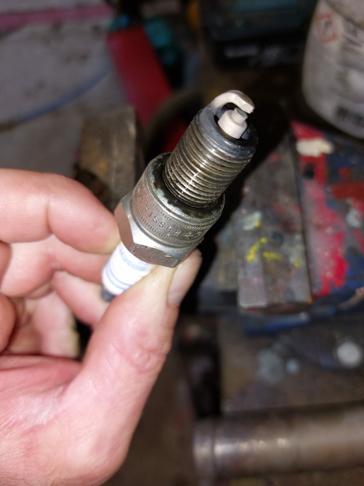

garydwall Posted October 28, 2022 Report Share Posted October 28, 2022 Hello. Can someone please help. My 2009 starts easily from cold. However when hot it gives a little backfire when kicking and eventually starts. I've done everything to try eliminate. Carb cleaned twice, new reeds, new plug, new plug cap , adjusted fuel screw etc etc. Have a 2008 which is much easier to start.... Any suggestions much appreciated. Thank you Quote Link to comment Share on other sites More sharing options...
garydwall Posted October 28, 2022 Author Report Share Posted October 28, 2022 Quote Link to comment Share on other sites More sharing options...
lineaway Posted October 28, 2022 Report Share Posted October 28, 2022 She be running lean. What size bike and what carb and your elevation. Quote Link to comment Share on other sites More sharing options...
garydwall Posted October 29, 2022 Author Report Share Posted October 29, 2022 250cc , dellorto, 300 mtrs above sea level.... Thank you lineaway Quote Link to comment Share on other sites More sharing options...
lineaway Posted October 29, 2022 Report Share Posted October 29, 2022 You need a 36 to 38 pilot and might want to go up one size of main jet. When you clean the carb you need to make sure the pilot circuit and the choke circuit blow clear. Good luck. 1 Quote Link to comment Share on other sites More sharing options...
