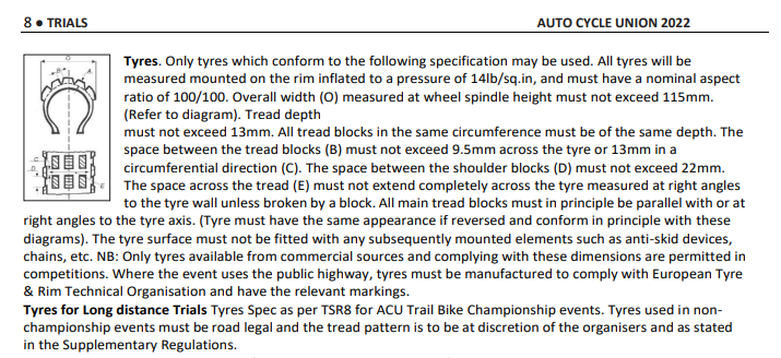

trapezeartist Posted November 5, 2022 Report Share Posted November 5, 2022 So here's a naive question that has been niggling away in my head for a while. Why are trials tyres the way they are? Is there a rule somewhere that bans MX or enduro tyres? Or has years of experience led to conventional trials tyres being the best for the job? I occasionally watch an X-Trial video and wonder why no-one has tried a slick tyre. Quote Link to comment Share on other sites More sharing options...
eddie1 Posted November 5, 2022 Report Share Posted November 5, 2022 It's in here somewhere. 1 Quote Link to comment Share on other sites More sharing options...
gazzaecowarrior Posted November 5, 2022 Report Share Posted November 5, 2022 I think it helps keep the sport accessible and competitive as pretty much everybody is riding on the same tyres. Trials is one of the cheapest motorsports and having everyone riding on the same tyres means that ability rather than expenditure will give all riders a fairer and more equal role of the dice. 3 Quote Link to comment Share on other sites More sharing options...
trapezeartist Posted November 5, 2022 Author Report Share Posted November 5, 2022 4 hours ago, eddie1 said: It's in here somewhere. Shows how carefully I read the regs! Anyway, that clearly settles my question. Thanks. Quote Link to comment Share on other sites More sharing options...

tony27 Posted November 6, 2022 Report Share Posted November 6, 2022 I doubt MX tyres will fit most trials swingarms & aren't tubeless like trials specific tyres, in most trials situations they won't grip as well either due to shape & sidewall stiffness I find it interesting how in the regs it says nominal maximum size of 100/100, at least 1 of the modern tyres is labeled 120/100 on the sidewall which I'm guessing has to be with how the manufacturers measure their tyres, different brands of MX tyres vary hugely in width, a 100/90 is the same width as a 120/90 as 1 is measured across the case & the other across the knobs 1 Quote Link to comment Share on other sites More sharing options...
