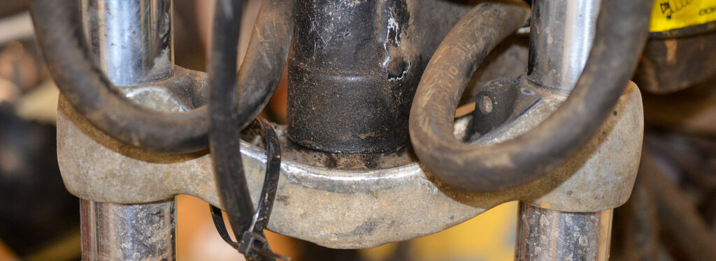

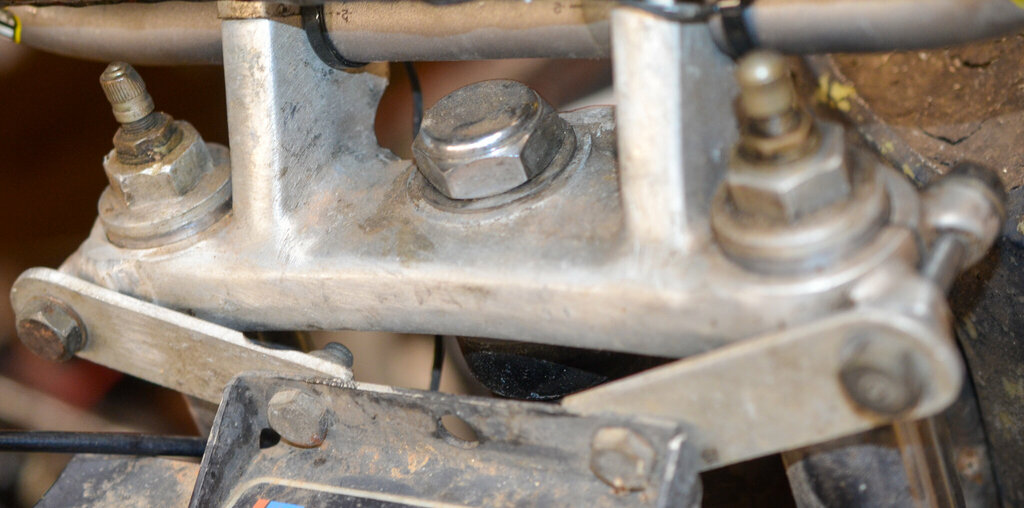

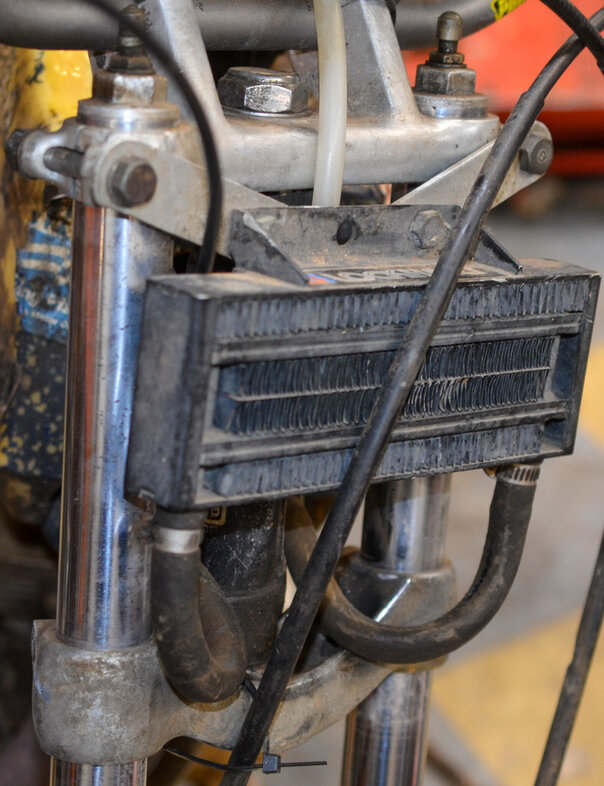

jmatch Posted November 12, 2022 Report Share Posted November 12, 2022 Can anyone recognize/ID these fork trees? They're on a TL125 with 34mm KT250 forks but the clamps are from neither of the above. The top unit keeps cracking so it's time to try to locate a replacement. Thanks for any help! John in NC USA Quote Link to comment Share on other sites More sharing options...
feetupfun Posted November 12, 2022 Report Share Posted November 12, 2022 They look a lot like HondaTL250 yokes with the lower yoke fitted upside down. However I think that TL250 tubes are 33mm diameter. Having the lower triple arch the wrong way up magnifies the forces on the yokes. Quote Link to comment Share on other sites More sharing options...
mcman56 Posted November 13, 2022 Report Share Posted November 13, 2022 (edited) TL250 are 33 mm so maybe bored out TL250 clamps. I'm having problems with pictures but have links. https://ibb.co/B2ghdCr https://ibb.co/0hRRdgX https://ibb.co/8Nt1NCk Edited November 13, 2022 by mcman56 picture issues 1 Quote Link to comment Share on other sites More sharing options...
jmatch Posted November 19, 2022 Author Report Share Posted November 19, 2022 TL250 is the donor. I’ve seen some on a tlr200 that appear very similar and may be easier to find than TL250 units. I did find a local TL250 but I have to buy the whole bike to get the clamps, situation is not that dire, thanks for the help! 1 Quote Link to comment Share on other sites More sharing options...
