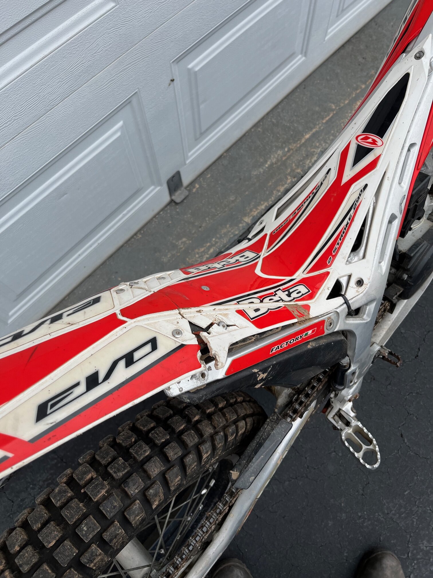

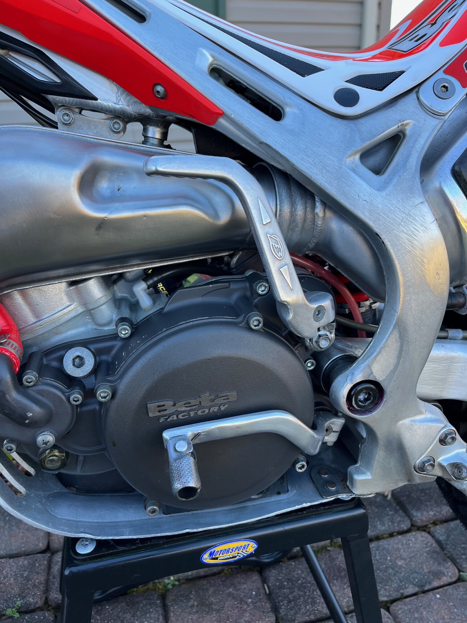

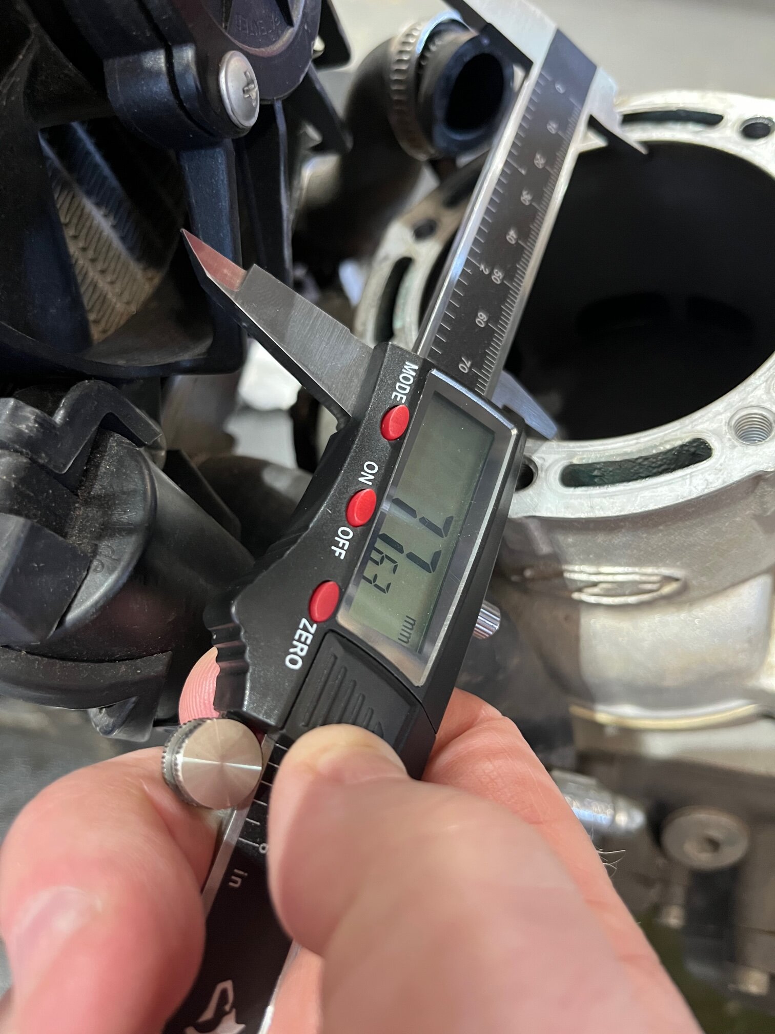

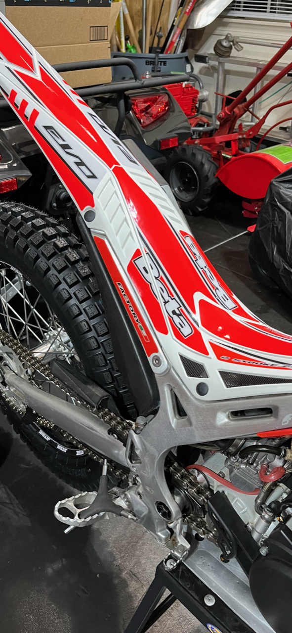

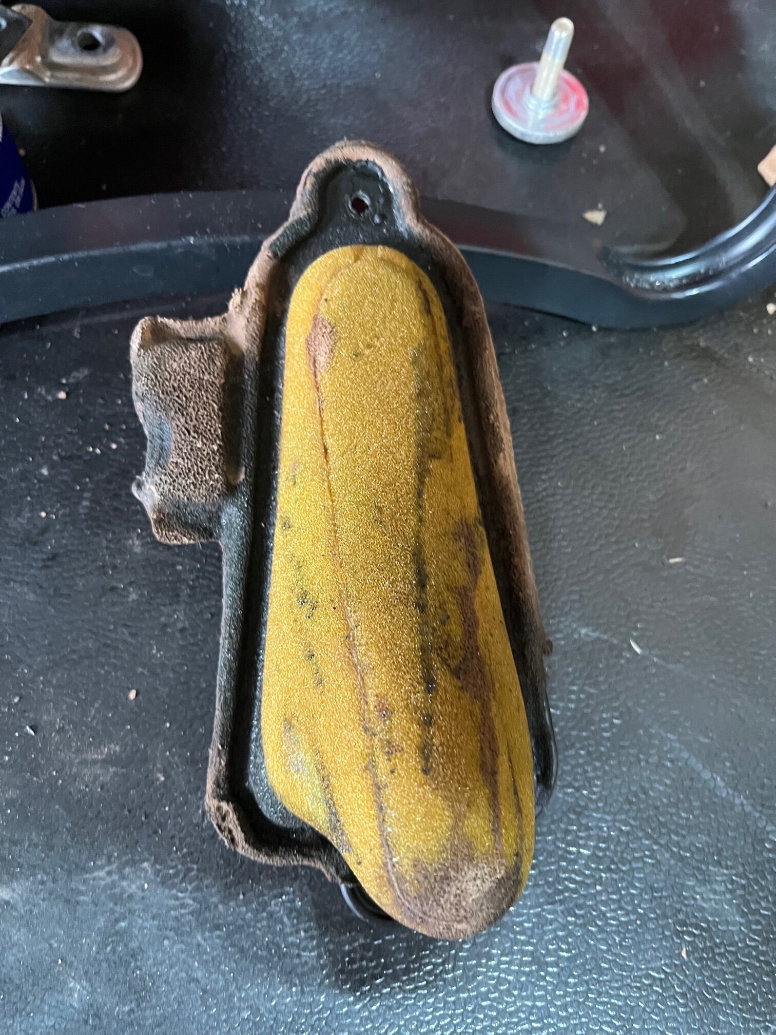

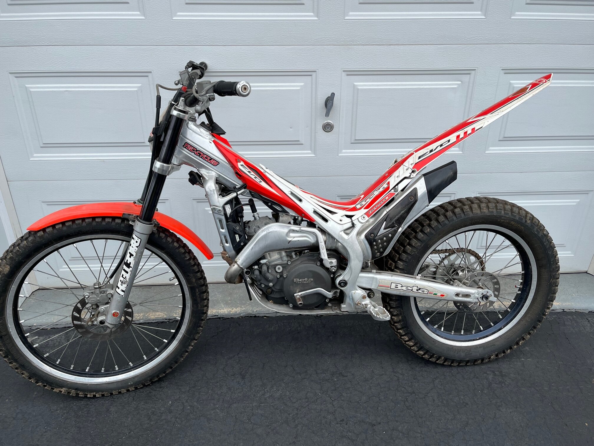

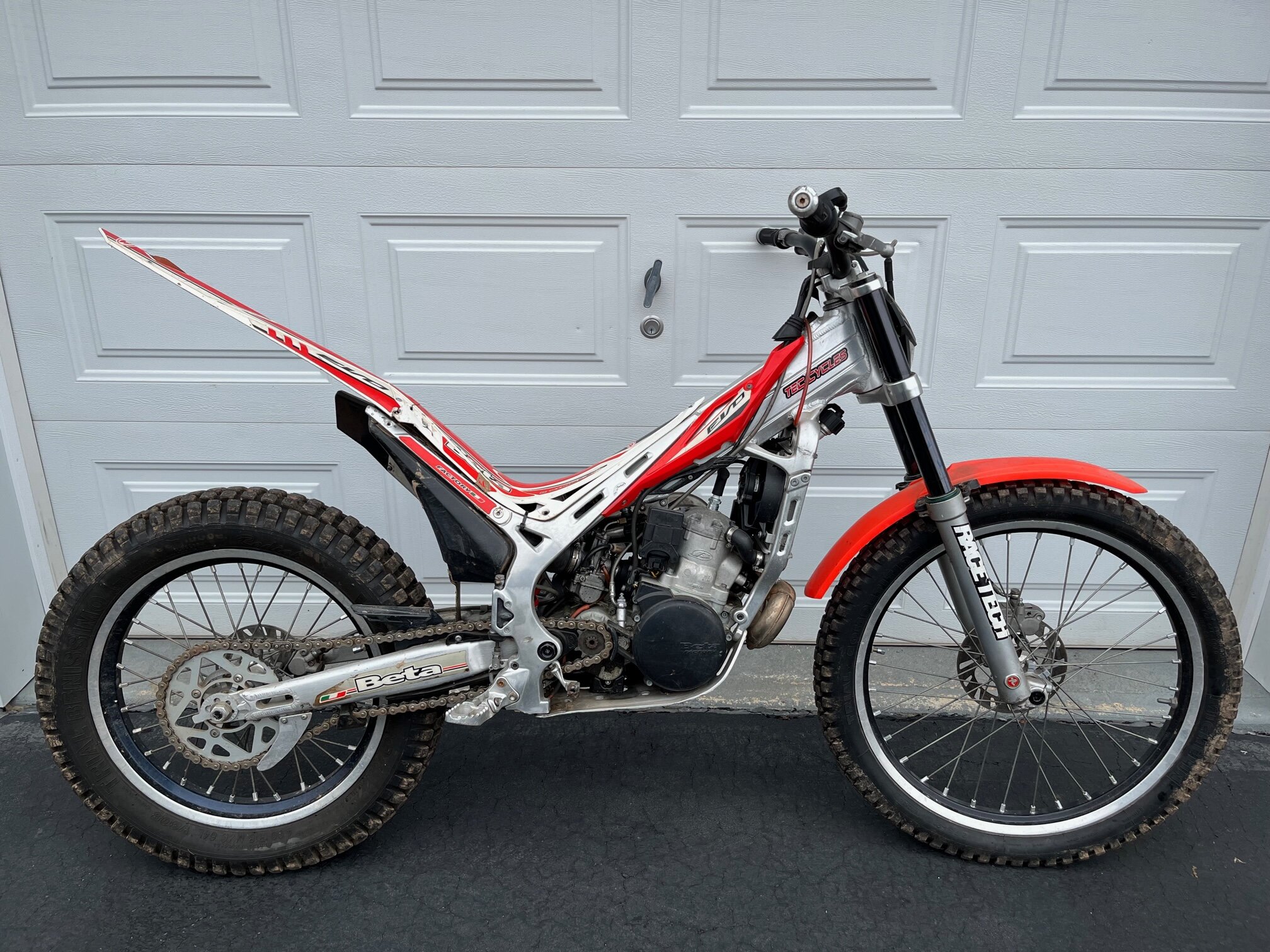

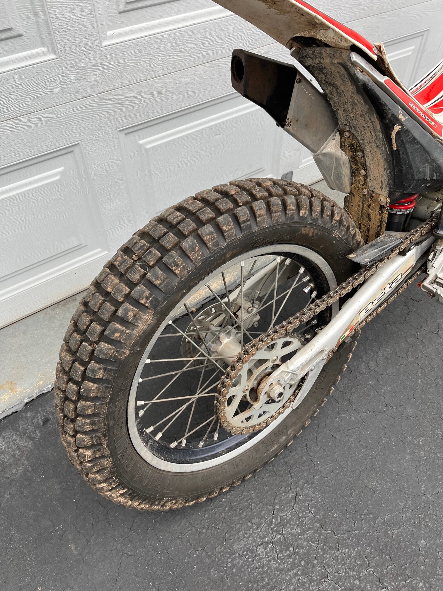

PAULIE Posted January 22, 2023 Report Share Posted January 22, 2023 (edited) Came across this EVO while searching for a new bike/winter project. It needs lots of attention but it runs great! Initial purchase pics and what has been done so far... The tires have 2014 date codes and are pretty hard, especially this Vee Air filter was filtering/hanging on for dear life and ready to fall apart...got to it just in time She is a 290. The cylinder bore looks fine and a quick peek through the exhaust port revealed no scuffing on the piston so the jug is not coming off Edited March 25, 2023 by PAULIE 1 Quote Link to comment Share on other sites More sharing options...

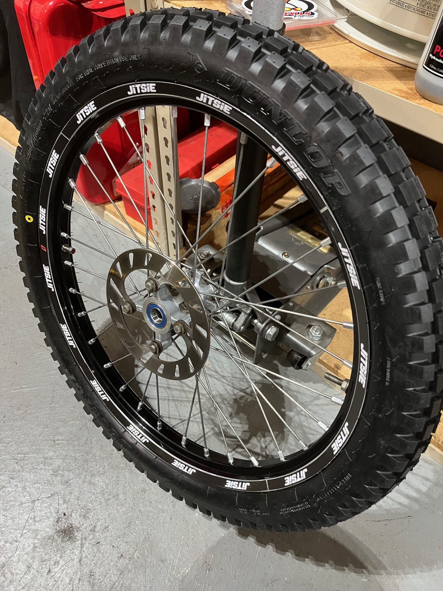

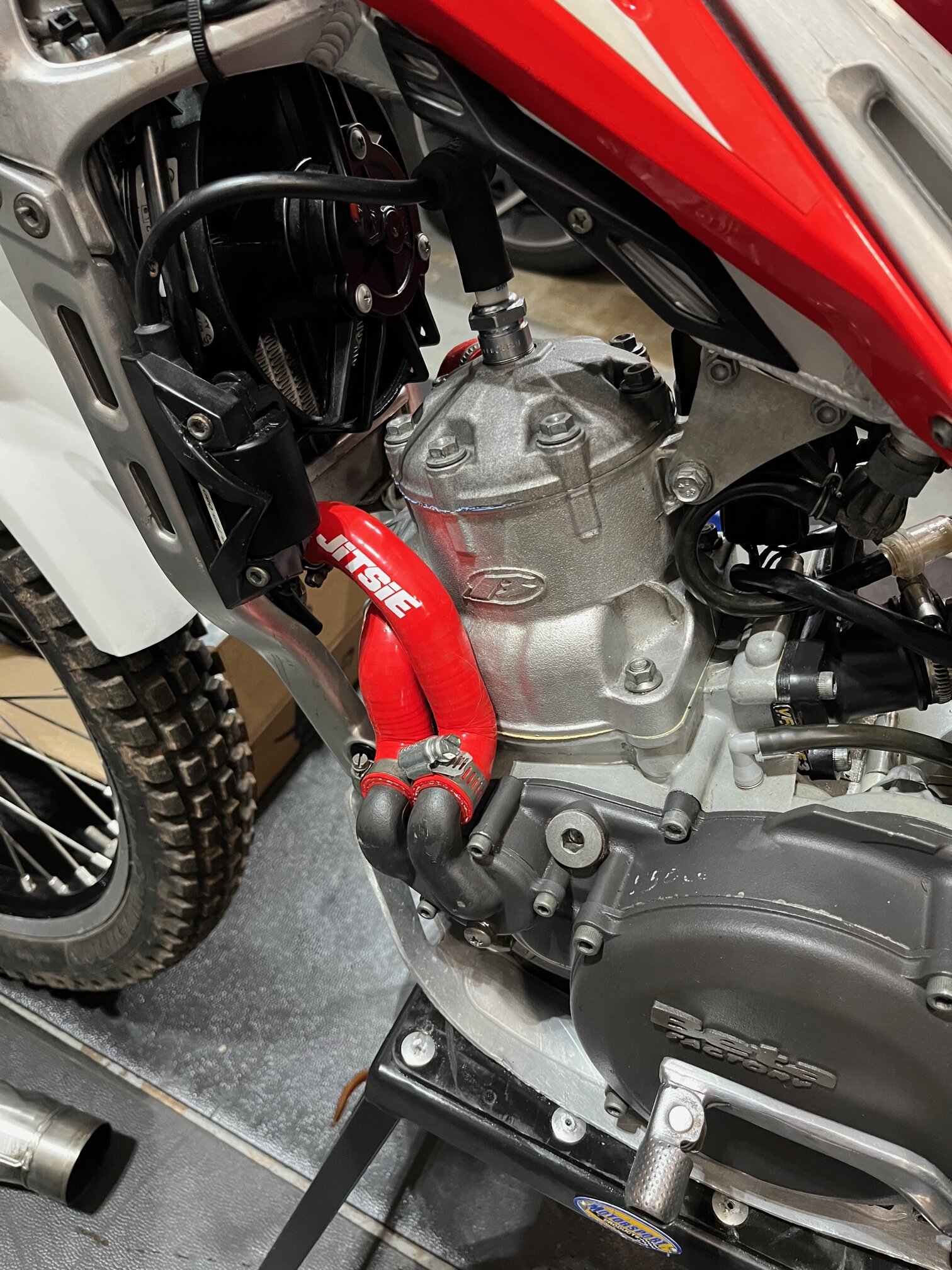

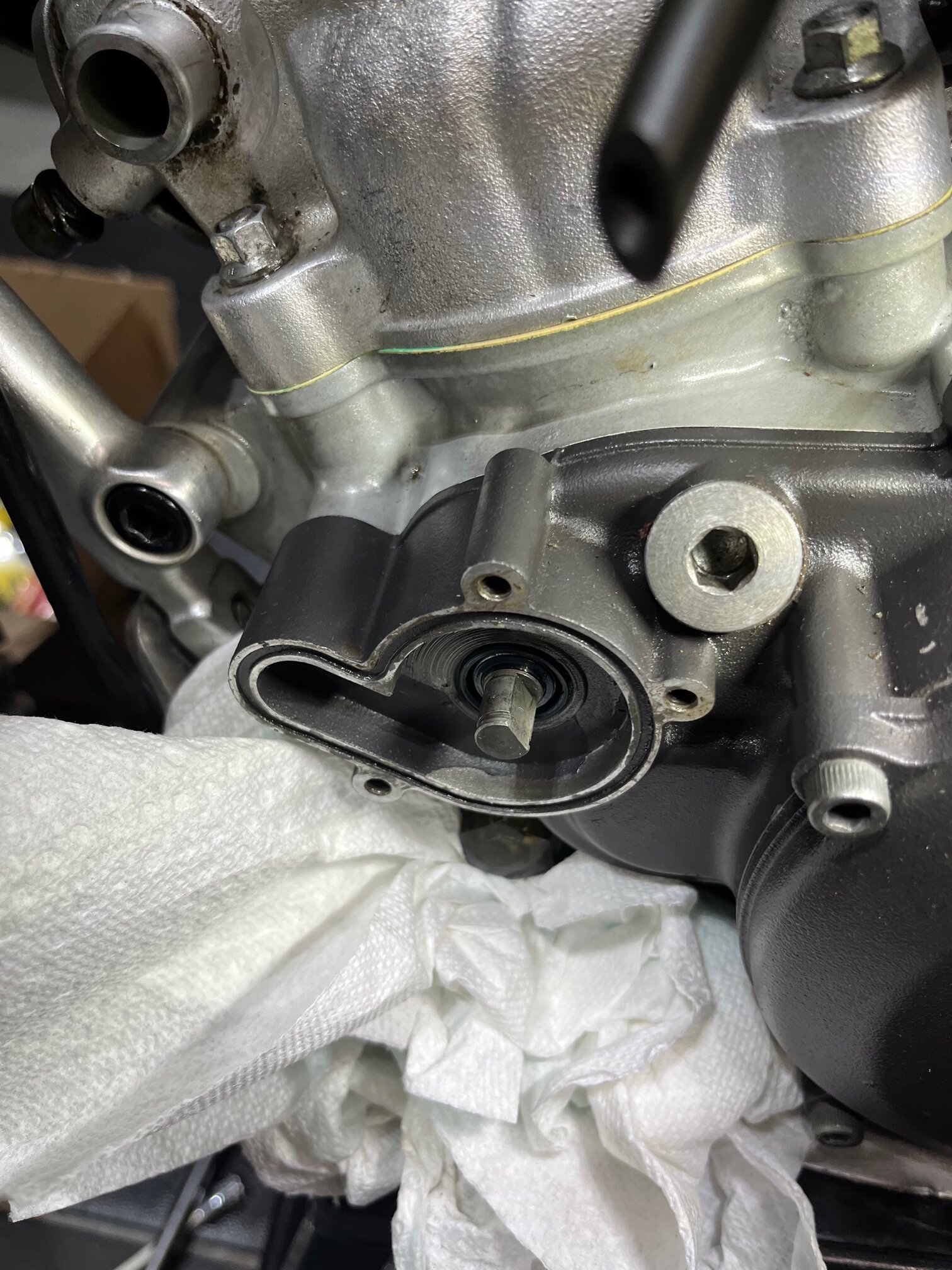

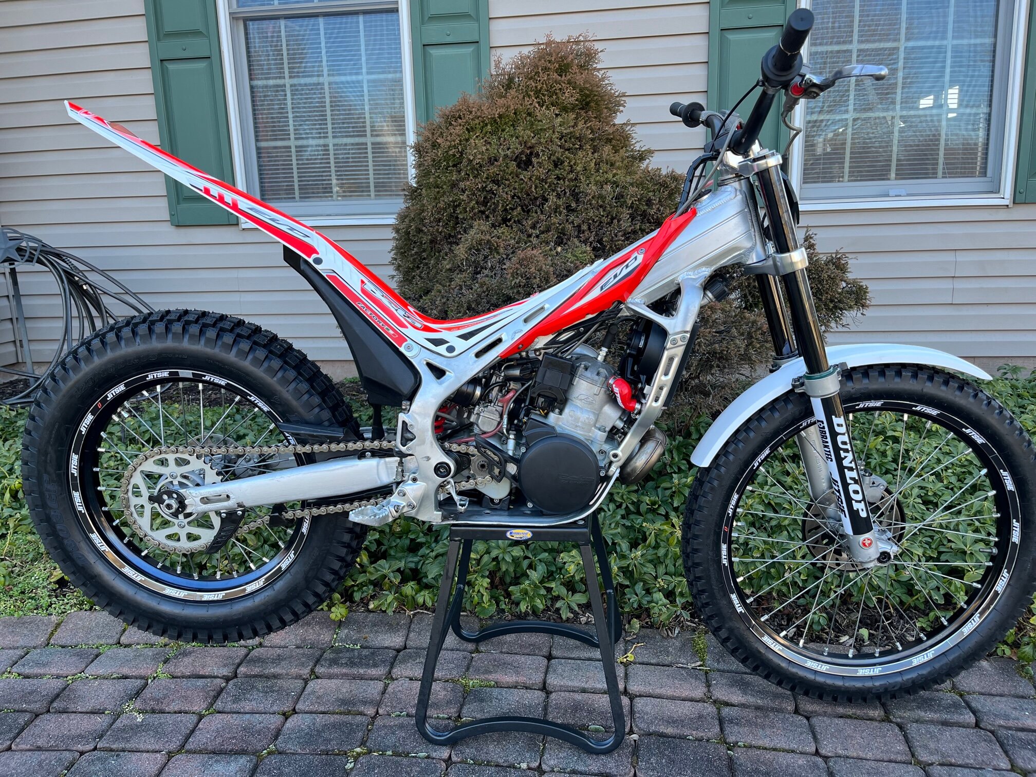

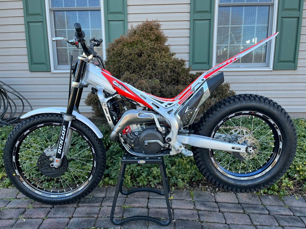

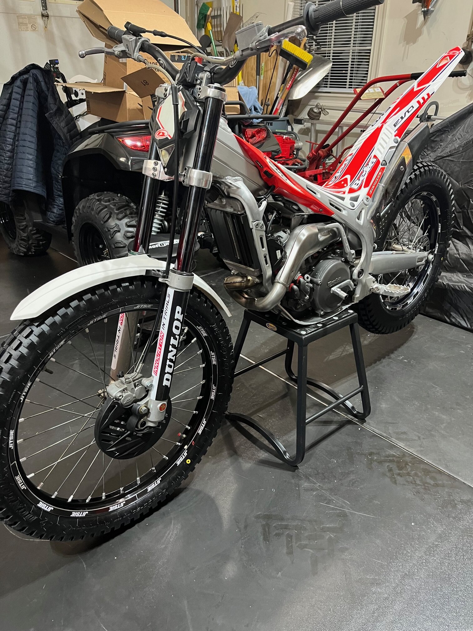

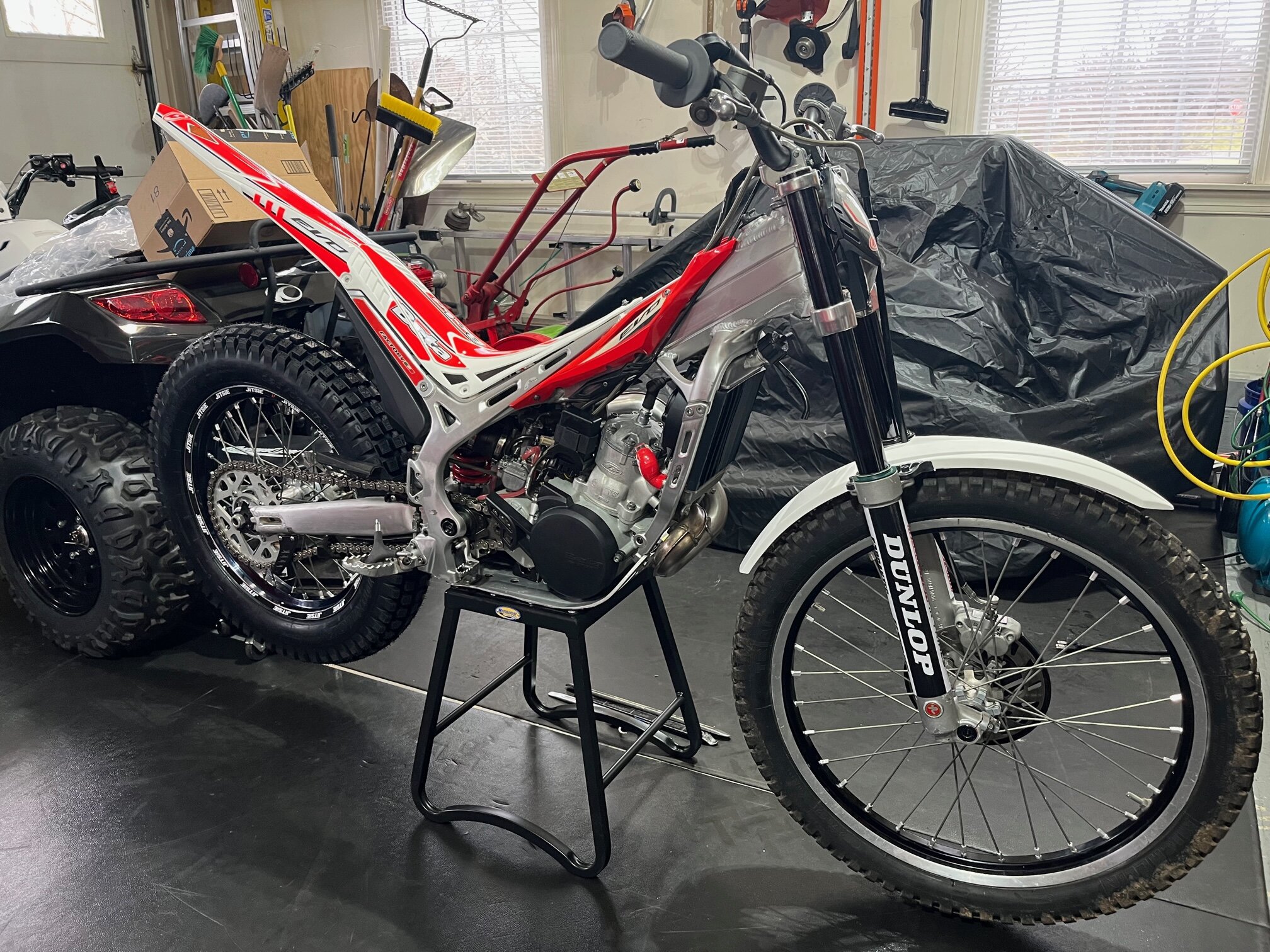

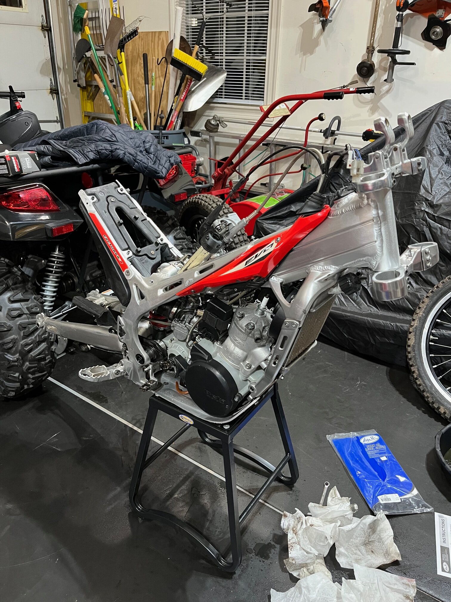

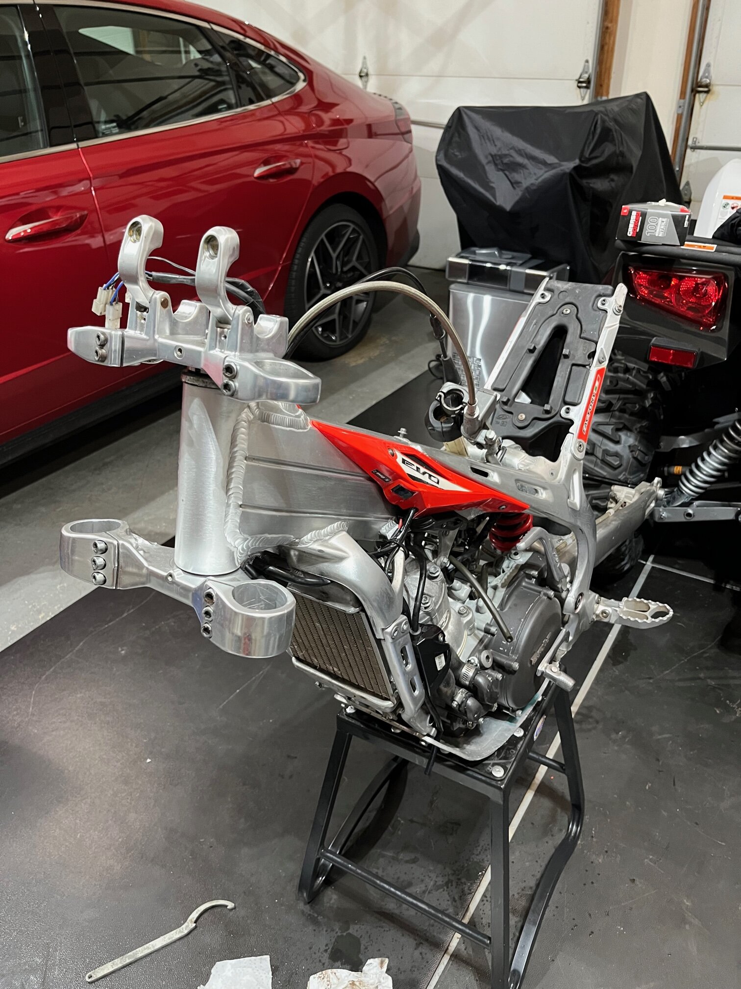

PAULIE Posted January 22, 2023 Author Report Share Posted January 22, 2023 (edited) New impeller and hoses cleaned and regreased swingarm and steering, and new oil in forks (to 120/60 heights) Removed/inspected carb and it was spotless inside. WD40 and a toothbrush work great at cleaning things... new Dunlop mounted and fender attached using threaded plastic buttons. Will switch to zip ties if they dont hold Next is replacing F&R wheel bearings, mounting the front tire, new Dot 4 in all the lines, coolant and trans oil. Edited February 25, 2023 by PAULIE 4 Quote Link to comment Share on other sites More sharing options...

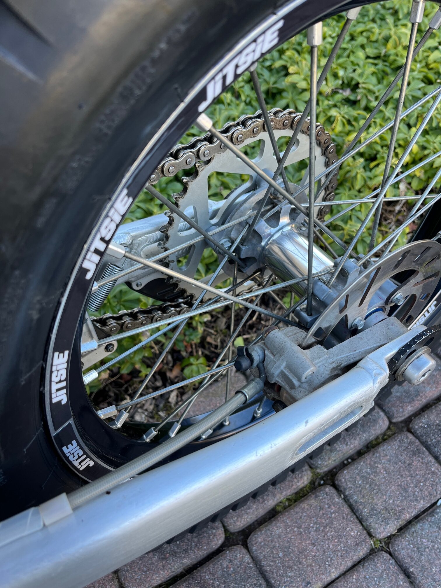

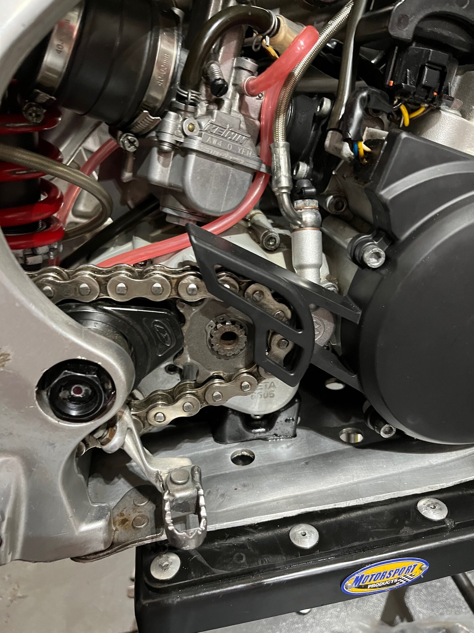

PAULIE Posted January 28, 2023 Author Report Share Posted January 28, 2023 (edited) Repacked the silencer with the Jitsie stuff and replaced front wheel bearings and tire Edited January 28, 2023 by PAULIE 2 Quote Link to comment Share on other sites More sharing options...

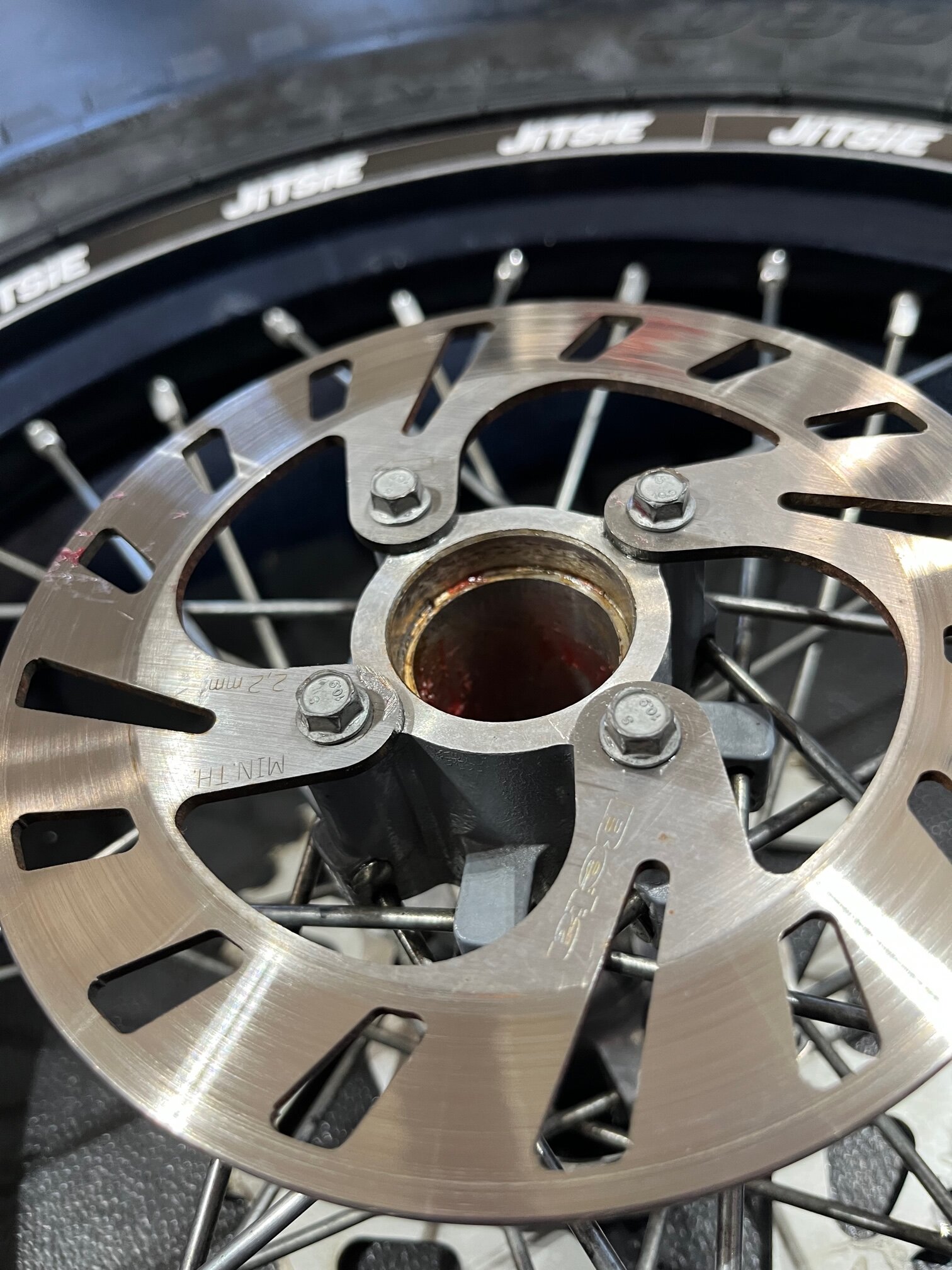

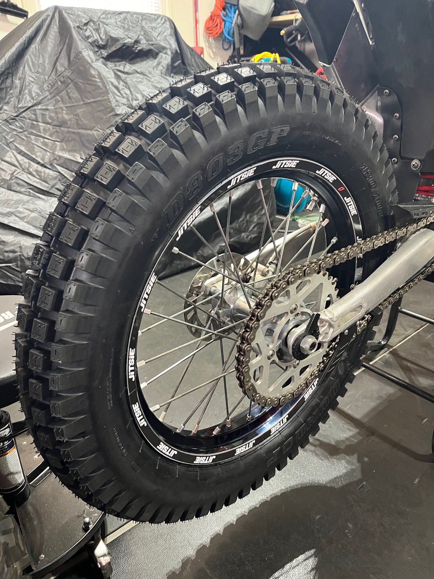

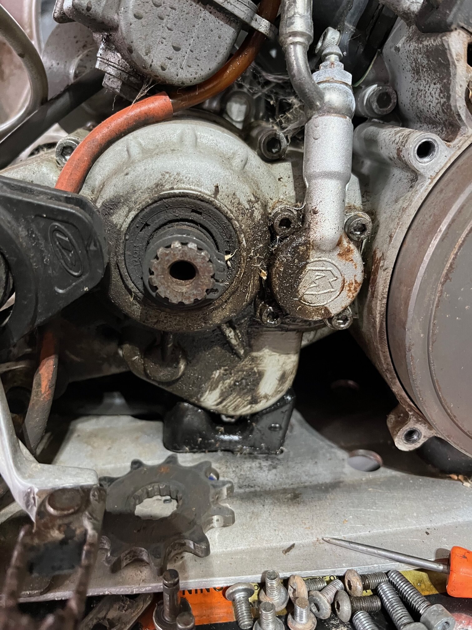

PAULIE Posted January 28, 2023 Author Report Share Posted January 28, 2023 (edited) This morning, enlarged the pinch point gap of the shift lever, installed rear bearings and changed the trans oil. Only 400ML overfilled it past the window so had to drain some. No signs of water. With it on 2 wheels again took it outside to feel the suspension. Both ends need some add'l preload for my weight. Next up up is adding coolant and taking a test ride! The f.d. gearing is 11/40 which sounds fast but we'll see. Edited January 28, 2023 by PAULIE 2 Quote Link to comment Share on other sites More sharing options...

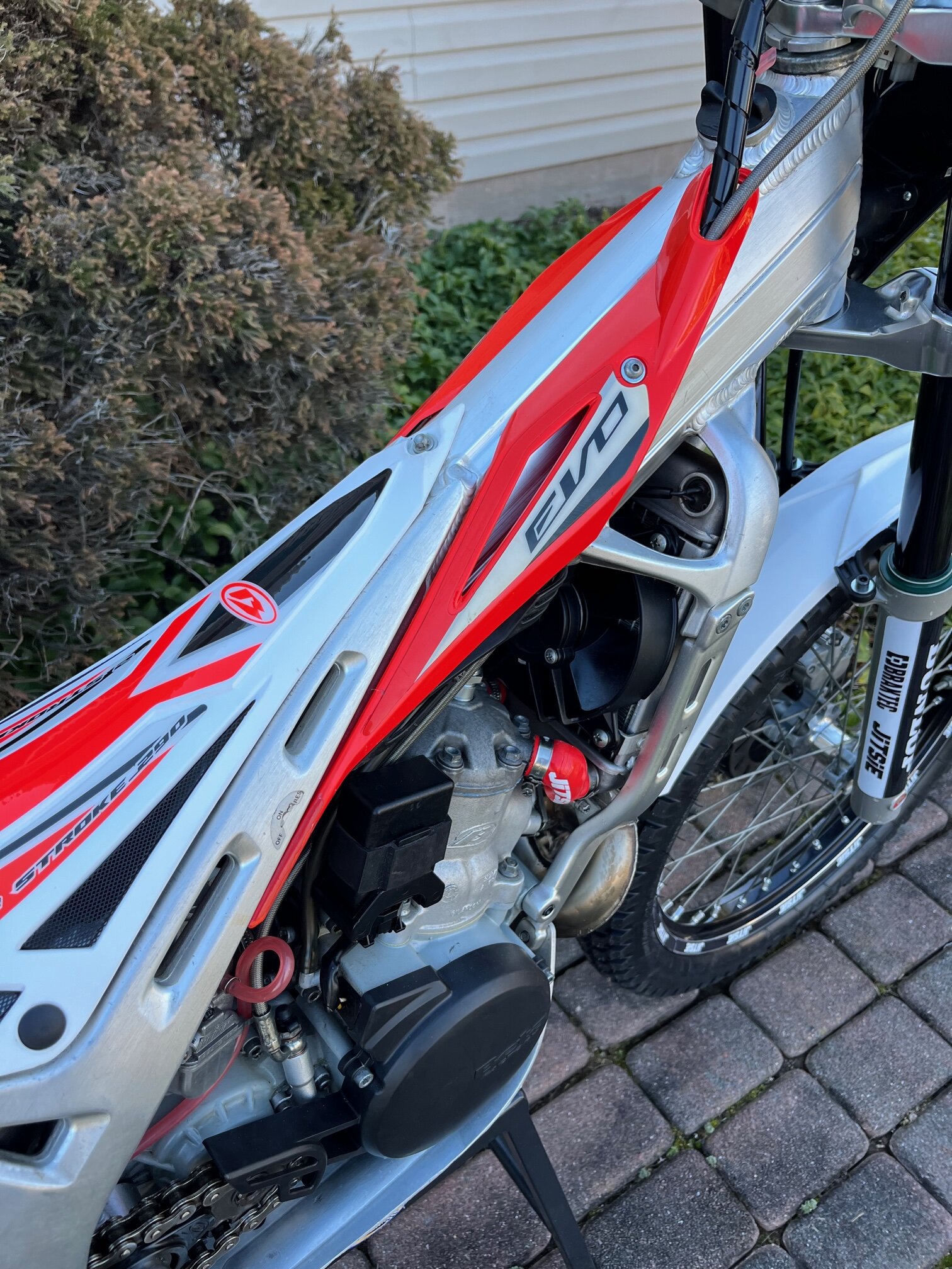

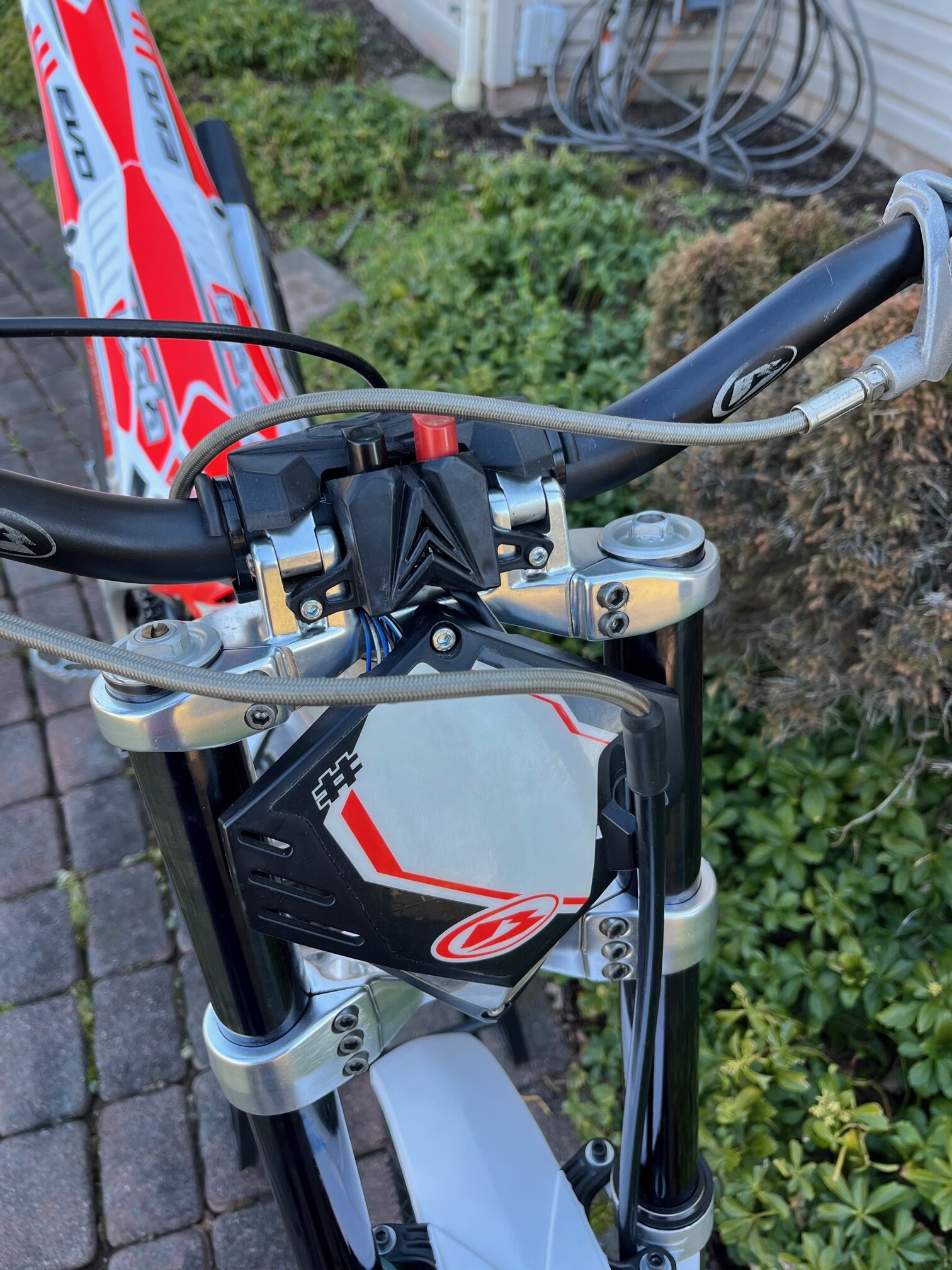

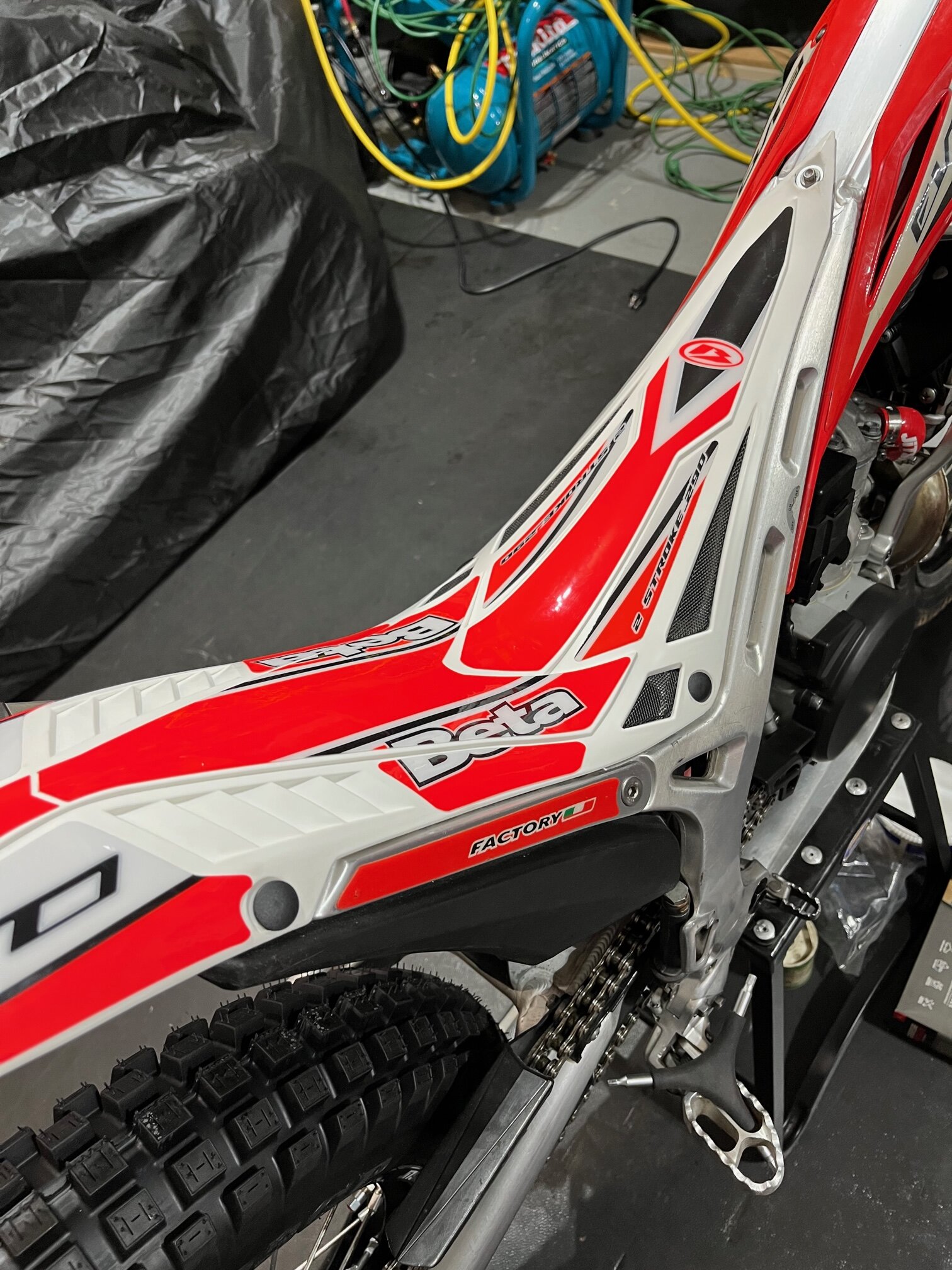

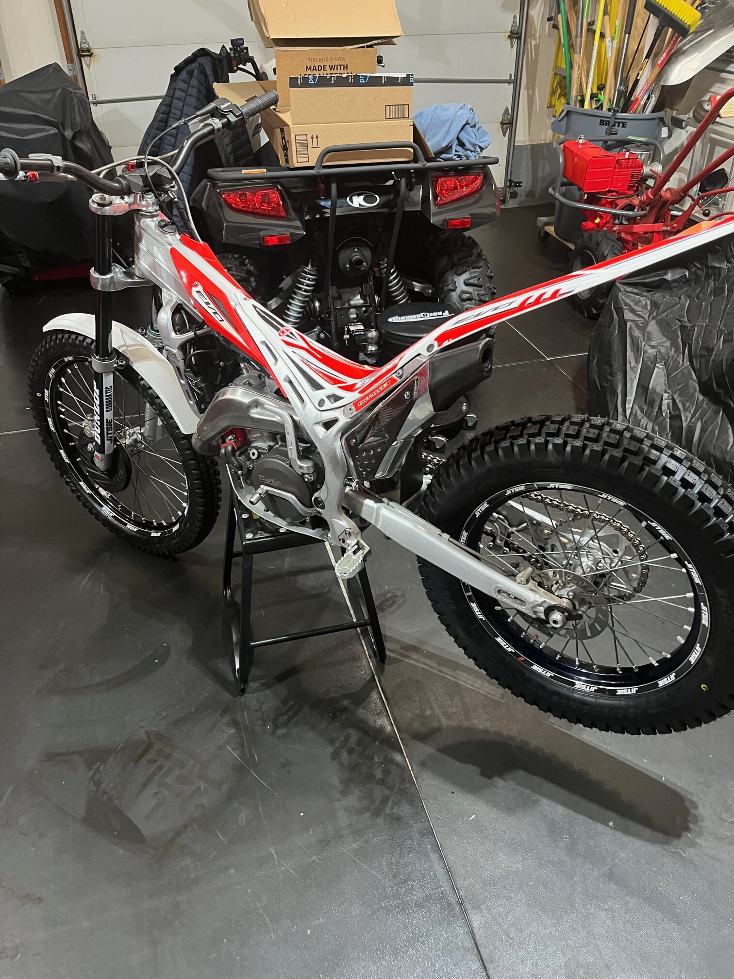

PAULIE Posted February 25, 2023 Author Report Share Posted February 25, 2023 (edited) Suspension is too soft for my 240lb so in goes some stiffer springs. 85N/mm is the grey ...and a little bling on the way home Edited April 7, 2023 by PAULIE 3 Quote Link to comment Share on other sites More sharing options...
