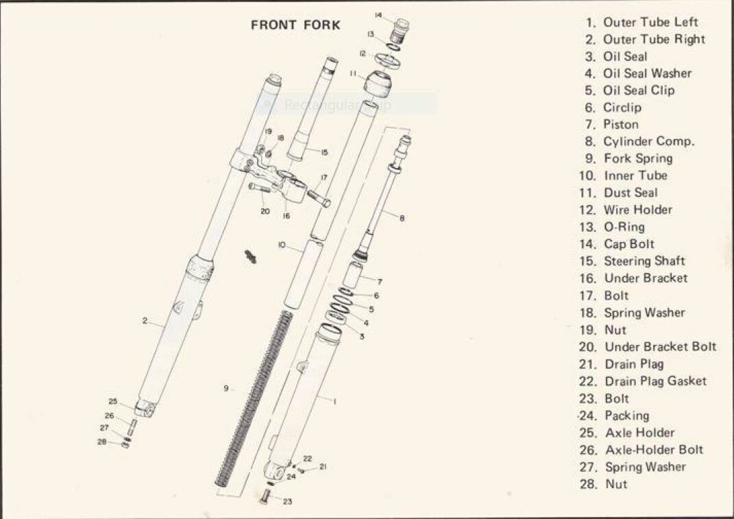

Bradocross Posted February 4, 2023 Author Report Share Posted February 4, 2023 Yes, I'm sticking with the stock dampening rods and my drain screws are on the rear of the fork legs so I should assume these forks are from a later model ('76 or '77 in the U.S.?). So please correct me if I'm wrong in doing the following: Referring to the diagram below, I should be removing the stock springs (#9), the stock spring seats (#11) and the stock spacers (#12) and replacing those with the new progressive springs and Magical adjustable spacer. Everything else (stock) will remain. You recommended that I, "....set the total Magical spring+spacer length the same as the original spring + spacer length". I should ignore the length of my sagging springs and use 400mm as the measurement of the original spring in your formula. When setting the sag are you referring to the difference between the handlebar height and ground when the bike is resting and when I'm on the bike? Or are you referring to the amount of fork travel down the fork stanchion tube between the bike resting and me sitting on the bike (sorry, I'm a newbie). You mentioned that the dampening rods are different in the later models. I've been thru all the parts diagrams and noticed that the springs, rods and tubes are the same part number throughout the 1970s in the U.S. I've also been told that the diagrams are wrong as they all depict the drain screws on the side which confirms they are wrong. Thank you for all your help Quote Link to comment Share on other sites More sharing options...

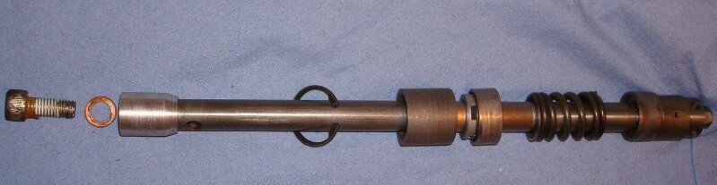

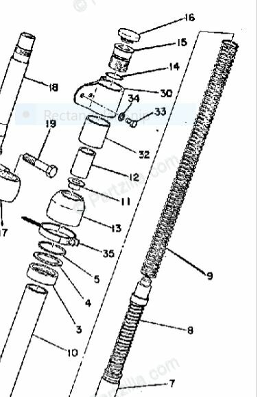

Bradocross Posted February 5, 2023 Author Report Share Posted February 5, 2023 Majesty kindly provided me with a service manual and parts list for the TYA. These documents include a completely different diagram of the forks that do not include a spring seat or a spacer (see below). The Magical springs are 443mm long. I just pulled my forks apart and discovered that my fork springs are 450mm long. This looks similar to the service manual diagram than the online parts diagram as it does not have a spacer but, unlike the service manual diagram, it does have the spring seat and a second small spring on the dampen rod. There appears to be some extra pieces below the piston not shown in any of the diagrams so I'm now wondering why these parts diagrams are different and why neither matches what If got inside my forks (see picture below). Are these TY forks? Quote Link to comment Share on other sites More sharing options...
feetupfun Posted February 5, 2023 Report Share Posted February 5, 2023 (edited) 1 hour ago, Bradocross said: Majesty kindly provided me with a service manual and parts list for the TYA. These documents include a completely different diagram of the forks that do not include a spring seat or a spacer (see below). The Magical springs are 443mm long. I just pulled my forks apart and discovered that my fork springs are 450mm long. This looks similar to the service manual diagram than the online parts diagram as it does not have a spacer but, unlike the service manual diagram, it does have the spring seat and a second small spring on the dampen rod. There appears to be some extra pieces below the piston not shown in any of the diagrams so I'm now wondering why these parts diagrams are different and why neither matches what If got inside my forks (see picture below). Are these TY forks? Your photo shows TY250A forks apart from the fork spring which is single rate and longer than standard. The standard spring is dual rate, thinner wire, shorter and the ends are tapered on the OD. The spring in your photo looks like what I bought from B&J Racing about 15 years ago to try in a TY250. The B&J set I bought were exactly the right length to use without any preload spacers. In my opinion, the Magical springs provide a superior action for most riders compared to both standard springs and the B&J Racing springs. The parts diagram you said is from "Majesty" is not showing TY250A forks. It is from the TY250 Owners Manual but sadly is not what TY250 forks look like. The TY250 fork diagram from the TY250 parts book also has a few mistakes which can cause confusion. Your forks in your photo look standard except for the fork spring. Edited February 5, 2023 by feetupfun Quote Link to comment Share on other sites More sharing options...

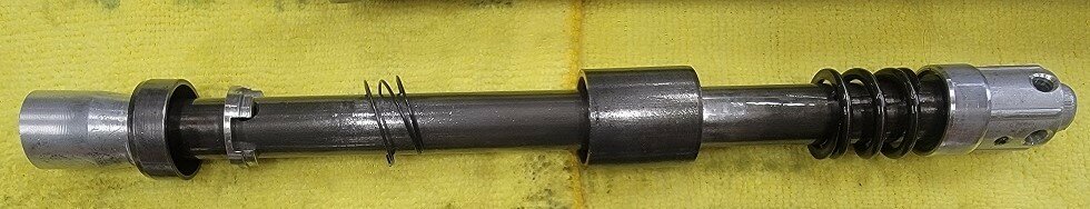

feetupfun Posted February 5, 2023 Report Share Posted February 5, 2023 John Cane has a reference photo on his website showing TY250 fork internals which might help you. https://www.tytrials.com/trailandtrialsuk/cat_88541-Front-Forks.html Quote Link to comment Share on other sites More sharing options...

Bradocross Posted February 5, 2023 Author Report Share Posted February 5, 2023 I compared the configuration of the forks components in the forks I pulled apart to the photo of John Cane's dampening rod. Apparently the last person who worked on these forks put them together backwards. The top photo (below) shows the parts assembly order on the dampening rods I took out of both fork legs. I reassembled the correct way after viewing John Cane's (bottom photo). I've got the magical and adjustable spacers in both forks and now have them back on the bike. I was surprised that I was able to put the fork caps on with the new spacer added but it worked. I've got the spacers adjusted to the minimum length and I'll have someone help set the sag when out riding. I'm curious about the sag starting point you mentioned (60mm). That's more than a third of the entire travel length of these forks (178mm). That seems a bit steep for sag. I may have to remove the spacers and even then I don't think I can get that much sag with me on the bike. Thank you again for all your help and support. Quote Link to comment Share on other sites More sharing options...
feetupfun Posted February 6, 2023 Report Share Posted February 6, 2023 5 hours ago, Bradocross said: I compared the configuration of the forks components in the forks I pulled apart to the photo of John Cane's dampening rod. Apparently the last person who worked on these forks put them together backwards. The top photo (below) shows the parts assembly order on the dampening rods I took out of both fork legs. I reassembled the correct way after viewing John Cane's (bottom photo). I've got the magical and adjustable spacers in both forks and now have them back on the bike. I was surprised that I was able to put the fork caps on with the new spacer added but it worked. I've got the spacers adjusted to the minimum length and I'll have someone help set the sag when out riding. I'm curious about the sag starting point you mentioned (60mm). That's more than a third of the entire travel length of these forks (178mm). That seems a bit steep for sag. I may have to remove the spacers and even then I don't think I can get that much sag with me on the bike. Thank you again for all your help and support. As for John Cane's photo, yes he put it there because it's easy to get it wrong. It's no surprise that people get it wrong with the available parts diagrams being so incorrect. Did you compare the length of the spring+spacer that went in compared with what came out? Quote Link to comment Share on other sites More sharing options...
