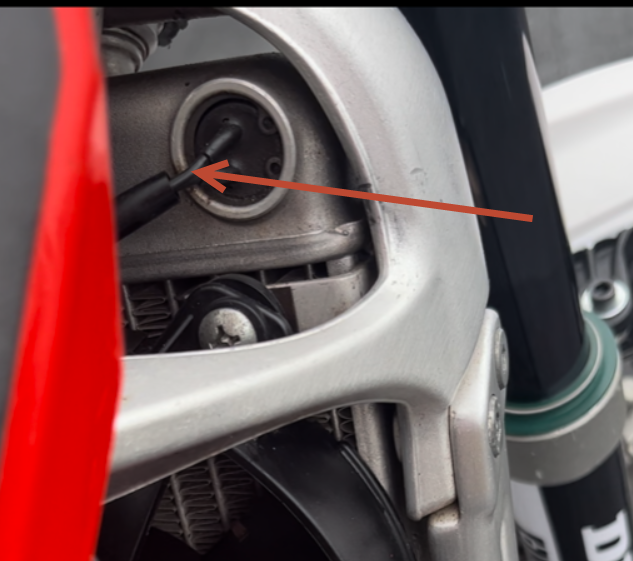

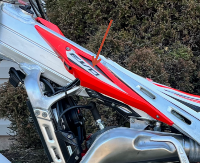

PAULIE Posted February 10, 2023 Report Share Posted February 10, 2023 (edited) remove this cover Starting from the thermo sensor on radiator, trace the wires back to the connector under the cover you just removed. Fab a jumper cable and disconnect the connector. Start bike up and plug jumper into the connector end that is coming from the CDI box near the carb area. If fan does not turn on the fan and/or thermo sensor might be in need of replacement Edited February 10, 2023 by PAULIE 1 Quote Link to comment Share on other sites More sharing options...
trailmeisterjoe Posted February 10, 2023 Report Share Posted February 10, 2023 4 hours ago, lonewolf said: Where do I bridge the fan. I'm terrible with electrics. Jump a wire between the 2 leads that connect to the temp sensor on the radiator that come from the fan. Fan should run (while bike is running). If fan doesn't run when you jump the 2 wires, either the fan stopped working, or it is wired incorrectly. Mine had same issue and I discovered previous owner had for some strange reason wired in a kill button (ok), and then proceeded to wire kill ground wire to yellow hot wire from the magneto thereby grounding out any DC powered accessory which was the fan on mine. You DO want the fan to run on a trials bike nearly all the time after engine gets up to temperature as low speeds and small radiators are involved. Joe Quote Link to comment Share on other sites More sharing options...
trailmeisterjoe Posted February 10, 2023 Report Share Posted February 10, 2023 1 minute ago, PAULIE said: remove this cover Starting from the thermo sensor on radiator, trace the wires back to the connector under the cover you just removed. Fab a jumper cable and disconnect the connector. Start bike up and plug jumper into the connector end that is coming from the CDI box near the carb area. If fan does not turn on the thermo sensor is probably bad. I would think that "if the fan DOES come on", then the thermo sensor is bad. Jor 1 Quote Link to comment Share on other sites More sharing options...
PAULIE Posted February 10, 2023 Report Share Posted February 10, 2023 (edited) With a cold engine, when I plug the jumper into the connector fan comes on and when unplugged it turns off. With engine warmed up it works as it should cycling on and off so it seems good. Edited February 10, 2023 by PAULIE Quote Link to comment Share on other sites More sharing options...
trailmeisterjoe Posted February 10, 2023 Report Share Posted February 10, 2023 32 minutes ago, PAULIE said: With a cold engine, when I plug the jumper into the connector fan comes on and when unplugged it turns off. With engine warmed up it works as it should cycling on and off so it seems good. Correct.......you know your thermo sensor works and fan comes on as it should when engine warms up. You can also manually turn on the fan with jumper so fan works, and thermo sensor works. O.P. Lonewolf knows his does NOT turn on when hot, but needs to narrow it down to fan, thermo switch, or wiring. To verify if thermo switch is culprit, he needs to jumper wire and if fan DOES come on, we know wiring and fan are good but thermo switch is bad. If when he jumps wires the fan still does not come on then it still could be 1 of the 3 being bad ( fan, wiring, switch). He then needs to remove fan and apply 12v to it via a battery and if it works, then we know it is a wiring problem. Wirie to the fan should be in the wiring schematic for his year Evo and needs to trace and verify. Joe 3 Quote Link to comment Share on other sites More sharing options...
