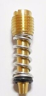

Beta evo air screw adjustment
lonewolf
That indicates that it probably has one of these things happening:
Pilot jet or pilot jet passage restricted.
Too small a pilot jet.
Air leaking into the motor somewhere other than through the carby venturi.
If it didn't have the problem before you cleaned the carby then it's not option 2.
  • Like 3
Link to comment
Pilot jets are all clean & blown out. Funny thing is it runs just the same. When you rev it revs come back down nice & steady. Nothing really changes when you screw it out when it's ticking over revs don't increase. I ran it on sat all the way in & 1.5 out & didn't really notice any thing different between the settings. Temp was around 5 degress C.
