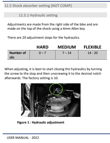

PNWer Posted April 27, 2023 Author Report Share Posted April 27, 2023 Thanks for the info. I'll try to find a manual for the r16v. It looks like there are a few adjustment screws, but I'm not sure. The manual references only one and calls it a "Hydraulic setting": I saw the same thing in the marketing info about the linkage... The 2023 I rode was from a guy who works at EM. He said the linkage was the same for 2023, only the shock had changed. If the part numbers are the same, maybe that is most accurate? I've found some other discrepancies in the marketing info... (when the throttle body changed) Quote Link to comment Share on other sites More sharing options...
konrad Posted April 27, 2023 Report Share Posted April 27, 2023 Yes, that is the rebound adjuster. As faussy said, opening the valve gives less rebound damping. That will make the rear more "bouncy." Quote Link to comment Share on other sites More sharing options...

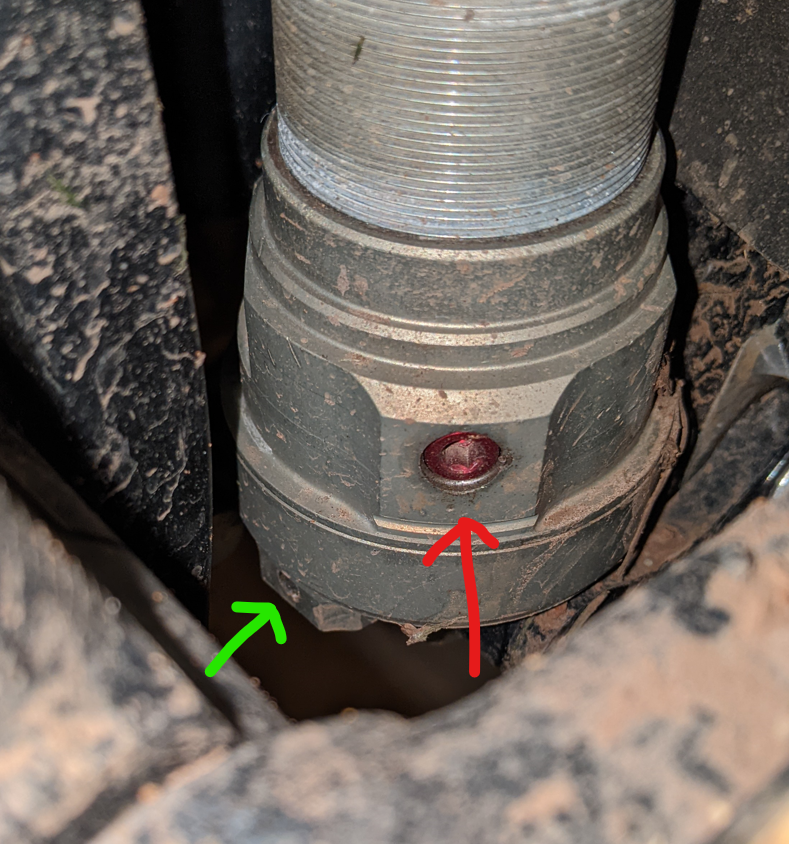

PNWer Posted April 27, 2023 Author Report Share Posted April 27, 2023 Perfect, thanks! Is there a compression screw also? Or is this marketing info not correct as well... I see two more screws on the bottom, but I'm not sure if they are adjustment screws... -Thanks Quote Link to comment Share on other sites More sharing options...
konrad Posted April 27, 2023 Report Share Posted April 27, 2023 (edited) I just downloaded the 2022 manual. The red screw at the bottom is compression damping. There is no mention what, if anything, that other screw (your green arrow) does. Damping adjusters all work in the same way. The number of clicks/turns out from the lightly-seated position (fully clockwise) determines the damping. The more clicks/turns out, the softer the damping. I generally unscrew the adjuster fully, counting clicks from fully seated, to determine the maximum range of adjustment possible. Don't be afraid to experiment. Just make sure you know the starting point so you can return to it if necessary. Make notes. A sensitive rider may be able to feel a single click difference. But start by changing 3-4 clicks at a time so you can notice the change. Honestly, it's not insane to try the extremes of the range so you know what the adjustments feel like. Just be cautious when riding. Don't begin with your biggest obstacle. EDIT: To develop a feeling for what the clicker do, I recommend Andy Ibbott's "Suspension Education Program." I talk about it a bit towards the end of this page: https://www.ossa-efi.com/home/chassis/marzocchi-forks Edited April 27, 2023 by konrad 1 1 Quote Link to comment Share on other sites More sharing options...
