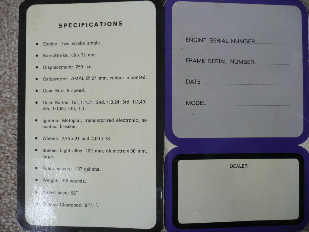

ERW Posted May 3, 2023 Report Share Posted May 3, 2023 What are gear ratios for a 5 speed 250 MAR? Thanks. Quote Link to comment Share on other sites More sharing options...

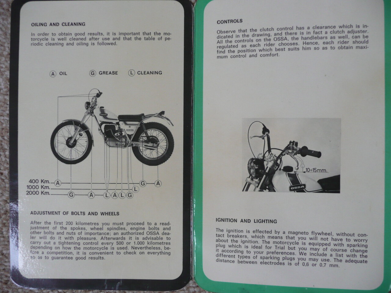

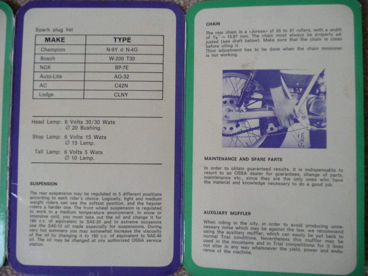

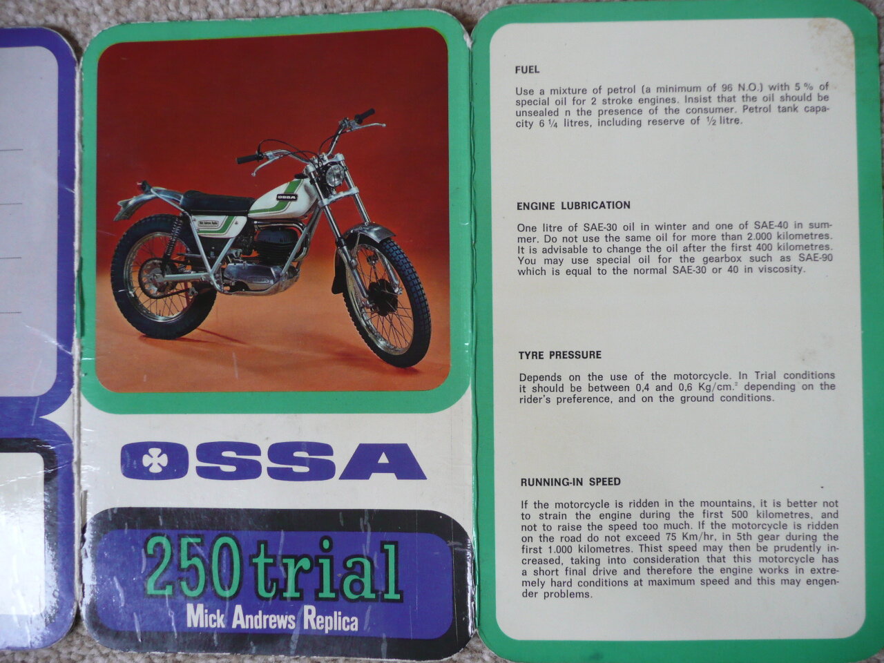

IDC Posted May 3, 2023 Report Share Posted May 3, 2023 Ratios are on attached photos plus some other info you might be interested in. Regards, IDC 3 Quote Link to comment Share on other sites More sharing options...
ERW Posted May 4, 2023 Author Report Share Posted May 4, 2023 Thanks so much! Lots of good information there! Quote Link to comment Share on other sites More sharing options...
