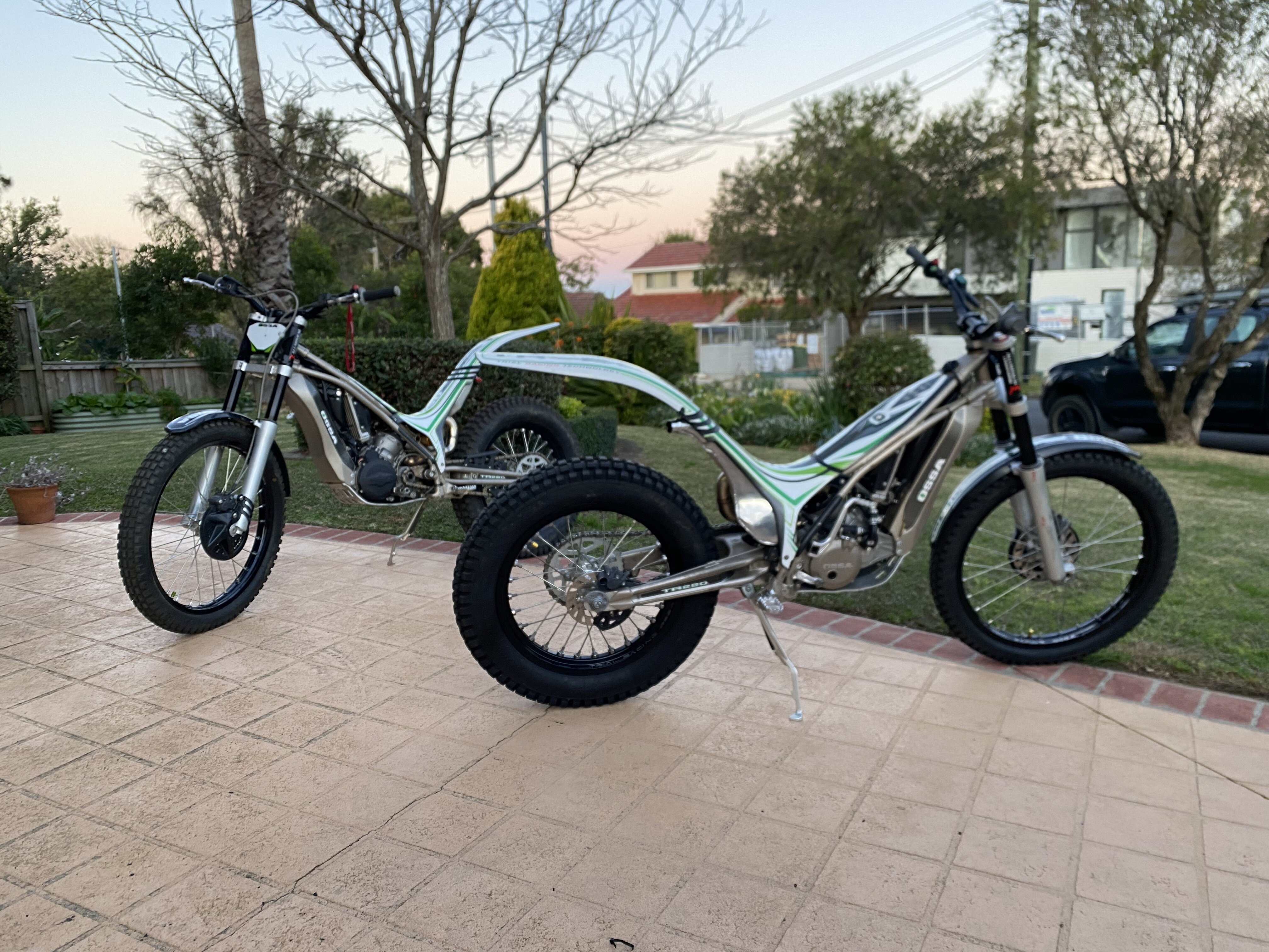

Robbo60 Posted July 9, 2023 Author Report Share Posted July 9, 2023 UPDATE Since invoking the starting fix we (my Son and I) have done a few rides and completed a club competition. The bike starts from stone cold 2nd kick. During the event we stopped to talk about the course and the bike can be kicked into life first go while in gear!!! Woo Hoo! I have now bought a second 2011 Ossa 280i; wired in my fix, removed plug and oiled the bore, drained and replaced the fuel with new as the bike had Sat unstarted for over a year. Pressed the button, heard the fuel pump prime the system, one kick and she started. One kick! It continues to start with ease, even in gear once warm. 1 Quote Link to comment Share on other sites More sharing options...

Robbo60 Posted July 9, 2023 Author Report Share Posted July 9, 2023 Quote Link to comment Share on other sites More sharing options...
