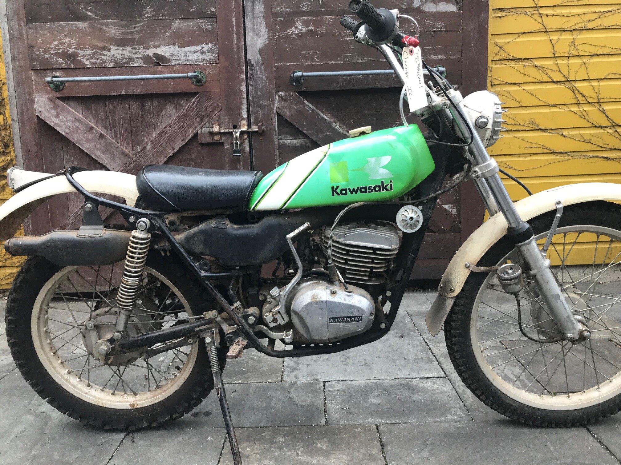

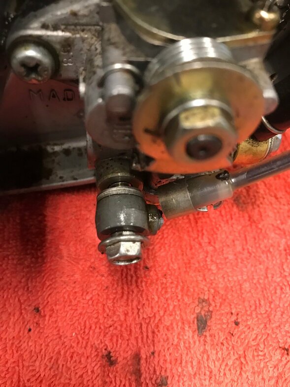

Eastside Posted May 31, 2023 Report Share Posted May 31, 2023 Hi there. I purchased a 76 KT 250 a few months ago, and am currently in the middle of restoring it. I'm guessing my question about whether or not to bypass the oil pump has been debated a number of times. But my line is broken, and I can either try to find a replacement or switch over to pre-mix. I am inclined to keep it as original as possible, but see it's pretty hard to find that oil line. I am a road rider (BMW R100rs, and a few old Honda's) but wanted to get into trials since I was 14 (back in the 70s). Since mom and dad didn't want anything to do with motorcycles, I did trials riding on my converted Schwinn stingray. Sort of a precursor to mountain bikes maybe. At any rate, some 40-ish years later I finally got an appropriate 70s trials bike, and am looking forward to seeing if my skills on the Schwinn translate to the KT. Quote Link to comment Share on other sites More sharing options...
Trials-dabbler Posted June 1, 2023 Report Share Posted June 1, 2023 Nice bike and welcome. I looked for the part in question, 16134-027, and it is indeed elusive. Is it possible to locate correct banjo fittings, some hose and construct the part yourself? 1975 KT250-A OIL PUMP.pdf Just a few sources: www.denniskirk.com/search/banjo+fitting.q belmetric.com Amazon has banjo fittings too. 1 Quote Link to comment Share on other sites More sharing options...
