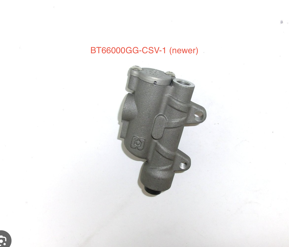

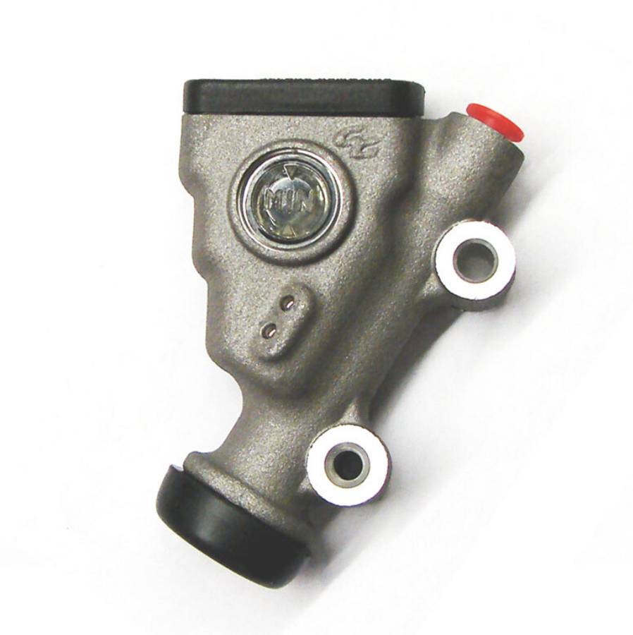

kasper Posted June 9, 2023 Report Share Posted June 9, 2023 Hello I have a 2014 GG Replica, it has an "older" rear brake master cylinder (part number BT660002811) as it wasn't available quickly enough, I bought the newer version (part number BT66000GG-CSV-1). The banjo on the older is 8mm and the more recent is 10mm, I made the new house with proper banjos. However, I am not able to get it working correctly. The brake is really weak, almost non-existent. There is a chance, that I still have air in the system, but pumping the brake does not make it any better. Checked/done so far: 1) No leaks; 2) New hose, proper armoured hydraulic hose, professionally made 3) Probably no air, I injected the oil from the calliper side, with a large syringe. Slowly pushed thru a few hundred millilitres; Quote Link to comment Share on other sites More sharing options...

kasper Posted June 10, 2023 Author Report Share Posted June 10, 2023 Yesterday, after posting it here I read more about the bleeding of the rear brakes. I understand that the process is tedious. I will give it another try, unfortunately, I don’t have the vacuum bleeder, but I’ll give it a try with syringes once more. @arnoux made a valid point that the back of the pistons might still have air bubbles trapped in them. Regarding my original question… The master cylinder should be interchangeable as the rear callipers are the same on both master cylinders. So there should be no difference in the length of the stroke or the volume of the brake fluid. With the older master cylinder, there is a chance to open the top lid without unbolting the master cylinder itself from the frame. With the new one, there is no chance to do it. Also, for future users/others, the brake hose banjo on the cylinder side is 10mm instead of 8mm. It is no 1-2-1 swap. And thank you both @rotors7 @arnoux 1 Quote Link to comment Share on other sites More sharing options...
