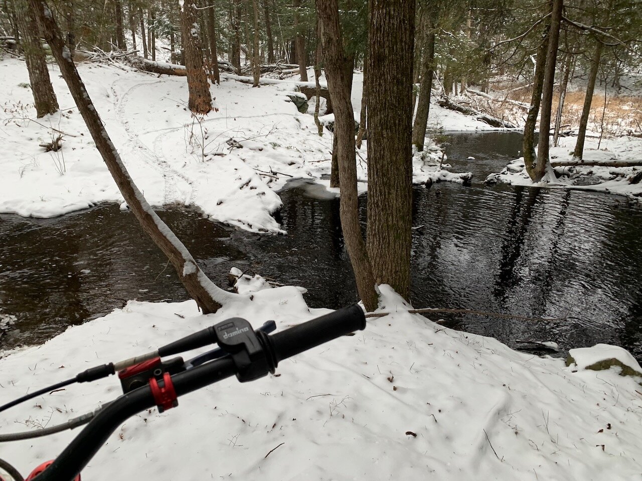

lemur Posted January 9, 2024 Author Report Share Posted January 9, 2024 Today before a snow storm hit 😎 might be the end of it until we get some melt or freezing rain 1 Quote Link to comment Share on other sites More sharing options...
