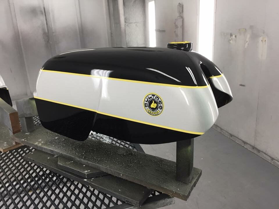

Trials-dabbler Posted July 18, 2023 Report Share Posted July 18, 2023 JRob does share a good point. I went the clear route and didn't incur any issues with the stickers, pinstripe and clear. I suppose it's not what was done originally but clear gives a finished look. Quote Link to comment Share on other sites More sharing options...
LSMO Posted July 18, 2023 Author Report Share Posted July 18, 2023 JRob does have a good point, and it makes me wonder how often I would need to replace my stickers given that gasoline spills seem to be inevitable. On the other hand, your BEAUTIFUL tank proves that clear coating the stickers is possible, Trials-dabbler. I'm curious who manufactured your stickers and what brand of clear coat you used over them. Quote Link to comment Share on other sites More sharing options...
Trials-dabbler Posted July 19, 2023 Report Share Posted July 19, 2023 LSMO; The vinyl-type stickers were from Hugh's Bultaco and the clear was DuPont. I don't recall who produced the stickers and I didn't see them offered on Hugh's site, but I'm sure a call or email would confirm their availability. Phone: 518-851-7184 Email: info@buybultaco.com Quote Link to comment Share on other sites More sharing options...
