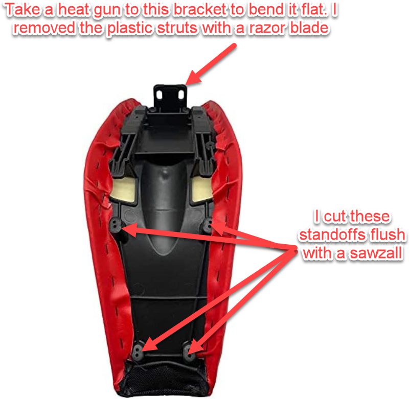

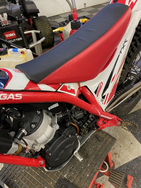

katoom400 Posted September 8, 2023 Report Share Posted September 8, 2023 (edited) I know the 23 is different than my 21 as far as fender and mounting options, but I bought a $20 tall CRF50 pit bike seat from Amazon and made it work on my 21 TXT 250. Took about 30 minutes to modify the base a bit with a heat gun and drill some holes. I'de like to make a key slot and post for the front, but for now it's bolted in the rear using the factory fender hole/screw (you would probably have to drill a hole in your fender) and the front is held down with a red zip tie and it's pretty solid. I did pack out the bottom with rubber so it doesn't flex when I sit on it. It's not as factory looking as the GG contact seat but for $20 I'm happy to have something to sit on that doesn't look horrible. And forget the Jitsie "seat" it's more comfortable to sit on the airbox! https://www.amazon.com/dp/B09YRF7CY6?ref=ppx_yo2ov_dt_b_product_details&th=1 Edited September 8, 2023 by katoom400 Quote Link to comment Share on other sites More sharing options...
Scottro Posted September 8, 2023 Author Report Share Posted September 8, 2023 (edited) That looks pretty sharp, Katoom! I hadn't considered bending that front bracket flat... That's a great idea, really. Thanks! Edited September 8, 2023 by Scottro Added more content. Quote Link to comment Share on other sites More sharing options...
katoom400 Posted September 8, 2023 Report Share Posted September 8, 2023 On 9/8/2023 at 5:46 PM, Scottro said: That looks pretty sharp, Katoom! I hadn't considered bending that front bracket flat... That's a great idea, really. Thanks! Expand You are welcome! My buddy has a 23 and I just noticed it has the fender bolt in the front, so you may be able to do the same thing i did just with the seat backwards. I added some Velcro under the front today and it's really solid now. Quote Link to comment Share on other sites More sharing options...

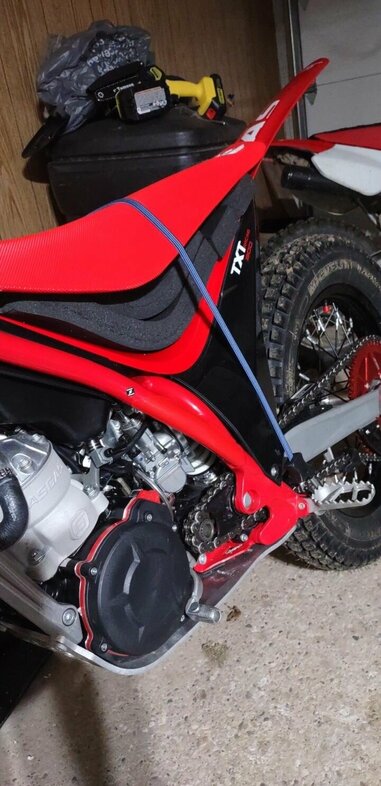

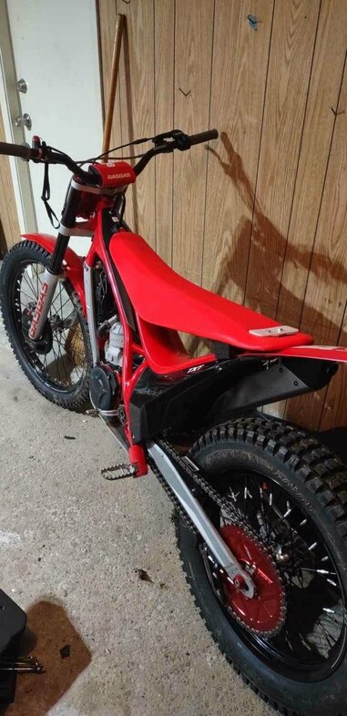

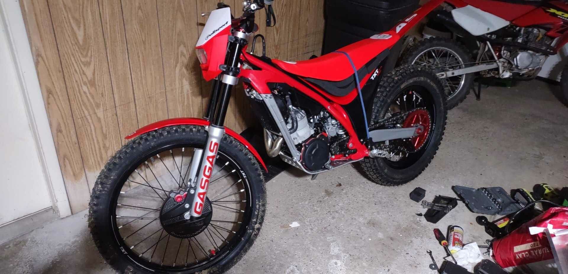

Scottro Posted February 17, 2024 Author Report Share Posted February 17, 2024 I mulled this over for a long time and used some ideas from Katoom400 and posts in another thread. I took the seats off various bikes in my garage, set them on the GasGas and eyeballed them for rough fit. I ended up deciding that a later-model Honda CR250 seat looked/fit about the best. So I got an aftermarket copy of the Honda seat for reasonable $$ and I cut some bumps from the bottom to fit the GasGas tank area. I considered removing the seat cover and foam, attaching mounting hardware to the pan and recovering the seat but decided to wing it this time and just drill straight thru the seat cover and foam for attachment bolts. I drilled two bolt holes in the rear fender and used the existing GasGas front bolt hole. I supported the seat's midsection with chunks of closed-cell foam from a Home Depot Husky Knee Pad. And I secured the midsection with a flat bungee cord stretched over the seat from footpeg mount to footpeg mount. The bungee has small carabineers instead of hooks. (This needs to be redone more cosmetically in future, but for now is very solid.). To prevent the bolts from pulling thru the seat, distribute hold down force, and prevent injury, I made "washers"(??) from plastic cutting boards. (These also need a cosmetic make-over). For now. This setup is very solid and comfy enough for longer trail rides. Quote Link to comment Share on other sites More sharing options...
Scottro Posted February 17, 2024 Author Report Share Posted February 17, 2024 Quote Link to comment Share on other sites More sharing options...
Scottro Posted February 17, 2024 Author Report Share Posted February 17, 2024 (edited) It's still in rough prototype mode, so forgive the makeshift workmanship. It's a work in progress. But it's very solid and rideable as-is. The headlight is also a fitting experiment. Edited February 17, 2024 by Scottro 1 Quote Link to comment Share on other sites More sharing options...

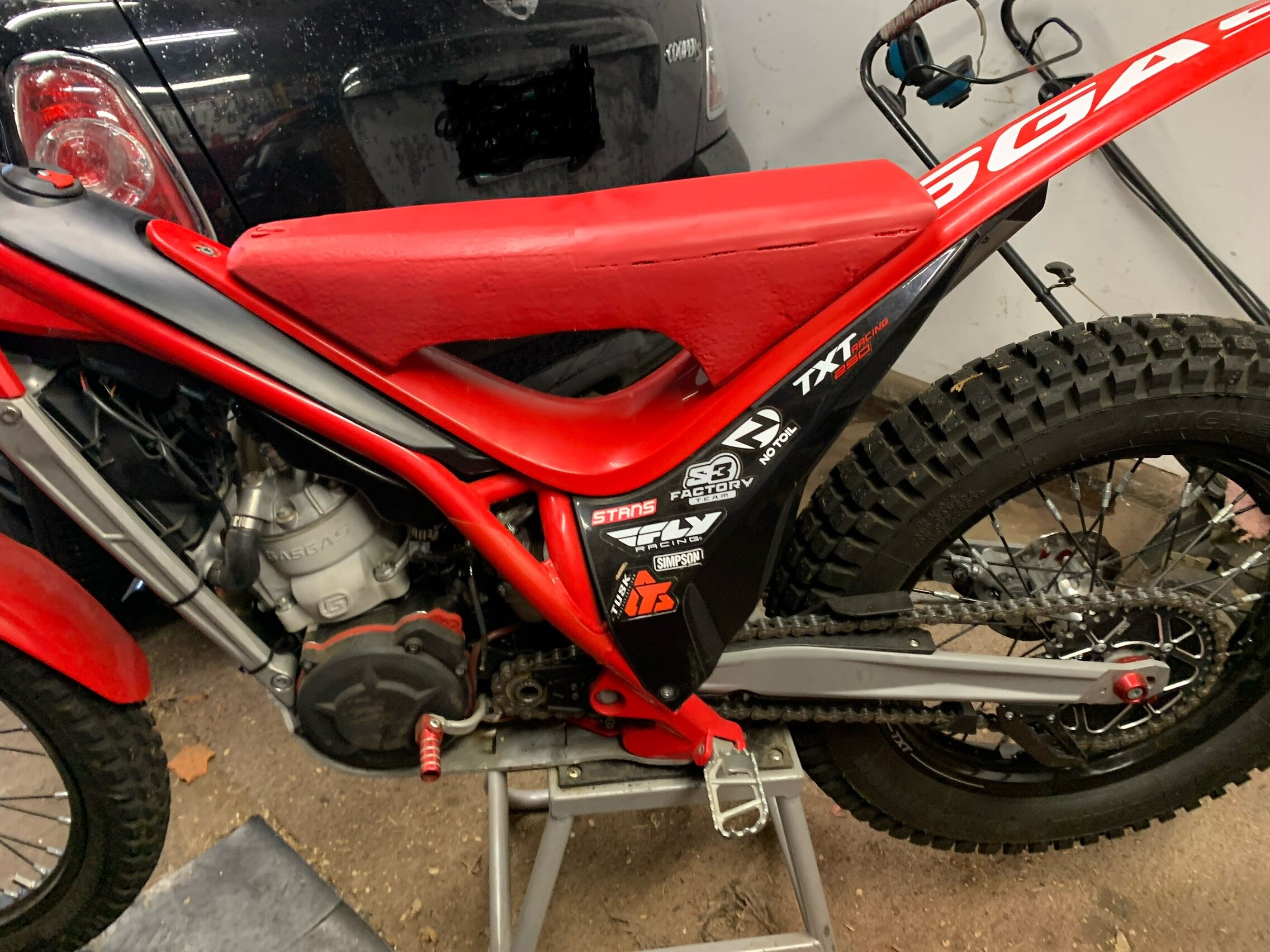

RonH Posted March 31 Report Share Posted March 31 I made this seat for my ‘23 TXT. It’s made of two types of foam. The first is a closed cell, very stiff, foam I glued up from half inch sheets and the second foam is a soft, 1” thick, closed cell, neoprene in the area where I sit. The arch below is reinforced with 6 layers of fiberglass and the whole thing is attached to the fender with 2” strips of hook and loop. It’s very secure and doesn’t move around. I then sprayed the entire thing with Plastidip rubber. It wearing very well and if it peels or cracks I’ll just spray it again. Quote Link to comment Share on other sites More sharing options...
