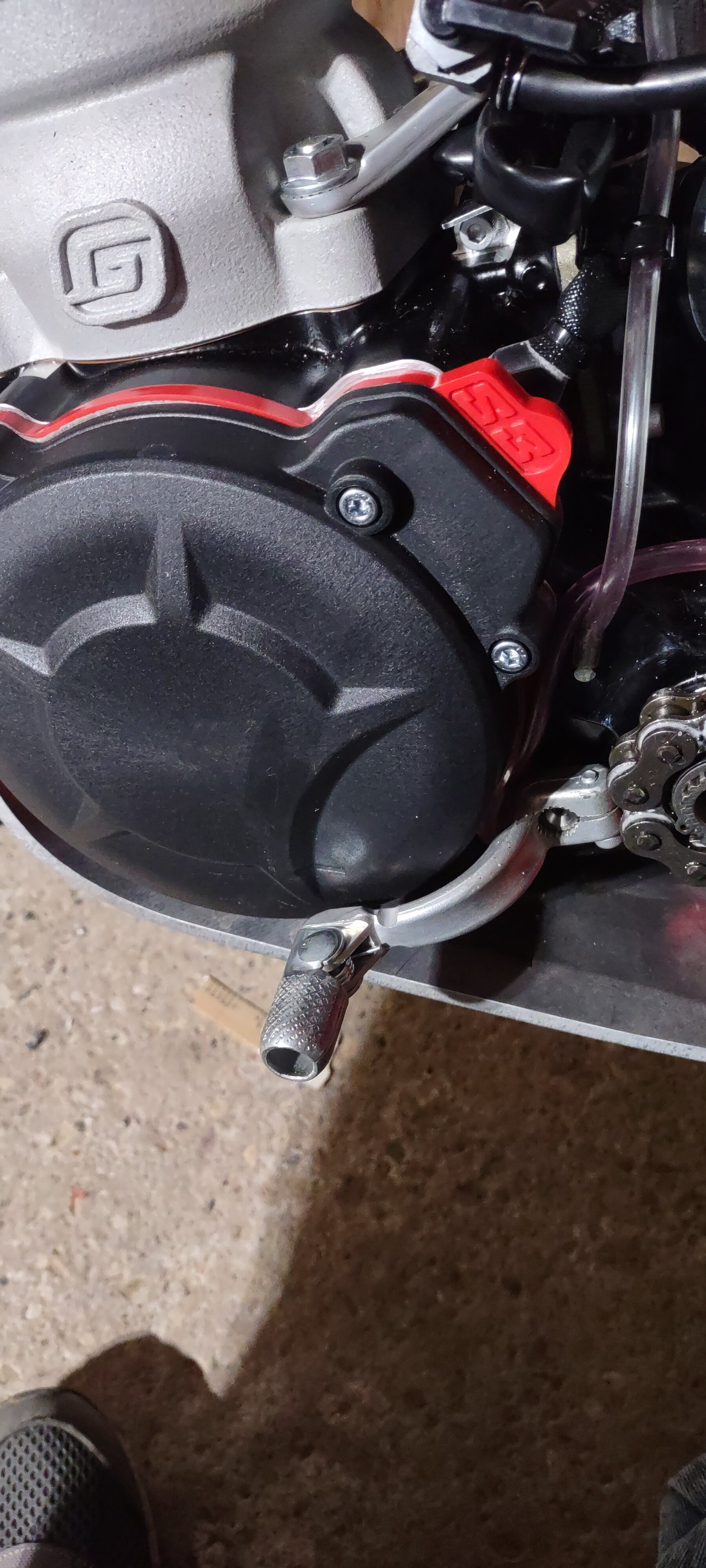

Scottro Posted February 14, 2024 Report Share Posted February 14, 2024 (edited) I just installed a flywheel weight on my 2023 TXT300. I would say it takes the knife's edge off the power delivery, but it's still pretty strong. It helps make the bike more stall proof. With the flywheel weight, spacer, and cover installed, I had to move the shift lever outward 1/4" on the spline to clear the case cover. Ideally, someone would offer an extended shift lever. Edited February 14, 2024 by Scottro Quote Link to comment Share on other sites More sharing options...
