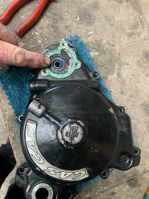

Carquestuk Posted September 30, 2023 Report Share Posted September 30, 2023 What is best way to remove this seal please? Quote Link to comment Share on other sites More sharing options...
Carquestuk Posted September 30, 2023 Author Report Share Posted September 30, 2023 Its a gas gas rookie 70 also where could i get another? Had water ingress in gearbox oil Quote Link to comment Share on other sites More sharing options...
jonnyc21 Posted September 30, 2023 Report Share Posted September 30, 2023 Maybe something like this would work? Quote Link to comment Share on other sites More sharing options...
Carquestuk Posted October 2, 2023 Author Report Share Posted October 2, 2023 Great thanks for that, any idea who would sell a new seal? Quote Link to comment Share on other sites More sharing options...
lemur Posted October 2, 2023 Report Share Posted October 2, 2023 1 hour ago, Carquestuk said: Great thanks for that, any idea who would sell a new seal? Same companies that manufacture and sell bearings, prime example being SKF and resellers of SKF products. I always source bearings and seals from the nearest bearing supply specialty store rather than order the same item via a motorcycle part number. It saves money and time. Many of the seals and bearings commonly used in motorcycles are also found in marine engines, farm equipment and industrial material handling like conveyor belts. Take the worn parts into a bearing supply store and they can usually offer replacements on spec. 1 Quote Link to comment Share on other sites More sharing options...
Carquestuk Posted October 5, 2023 Author Report Share Posted October 5, 2023 All sorted thanks everyone seal cost £1 1 Quote Link to comment Share on other sites More sharing options...
