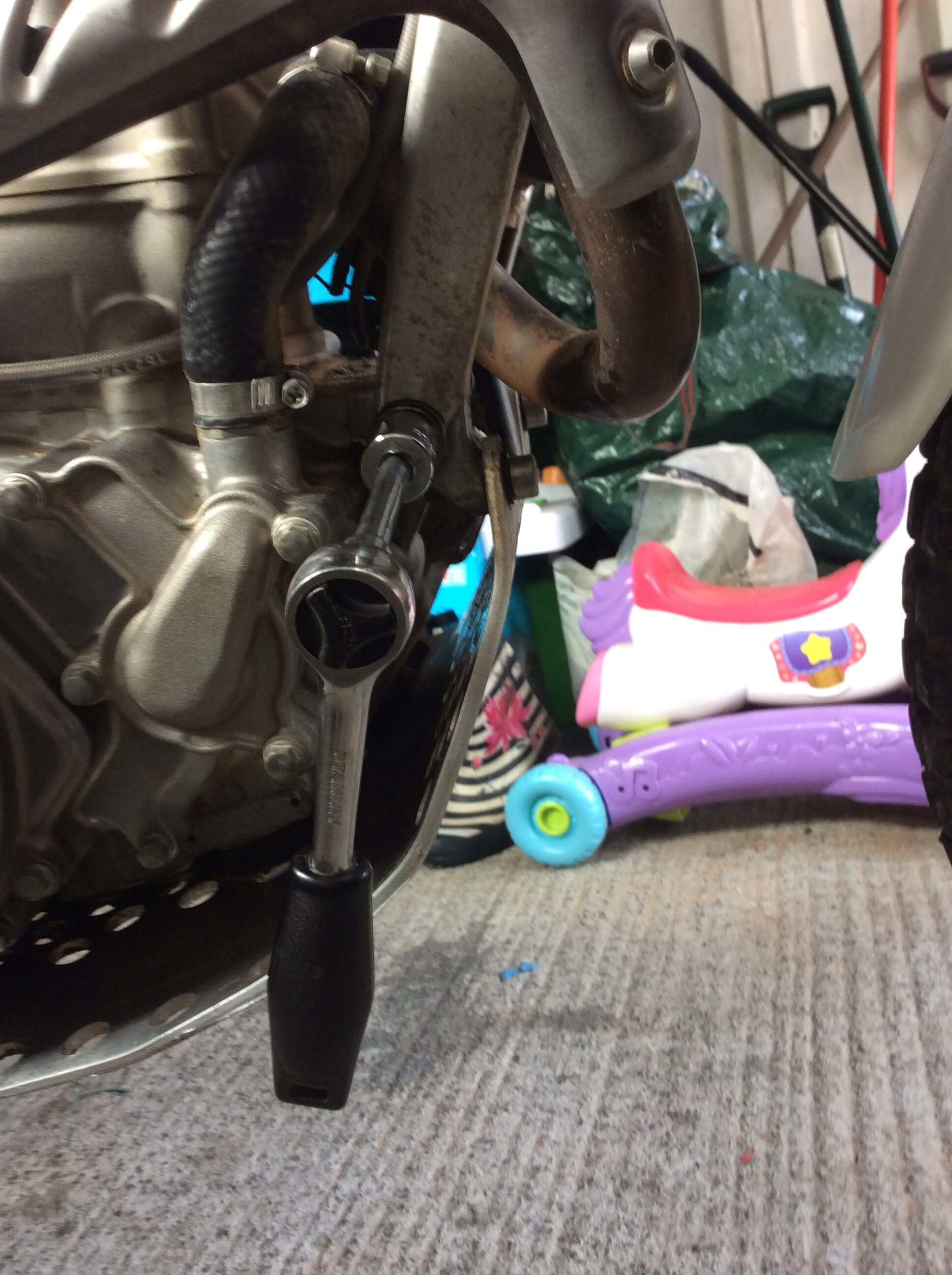

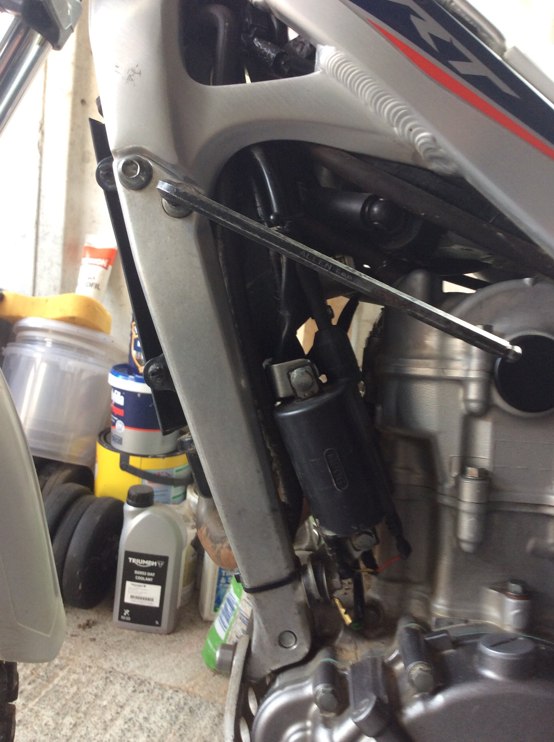

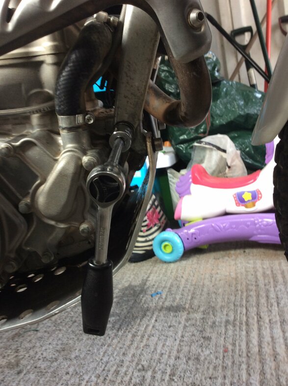

just done oil & oil filter change on my 4RT & like others struggled to get one of the front bolts to line up on the skid plate when refitting it
so I loosened the down tube bolts on the same side a little & also the long bolt that goes through the bottom see photos & it lined up
so I just tightened them all a little at a time until all were secure
hope this helps
