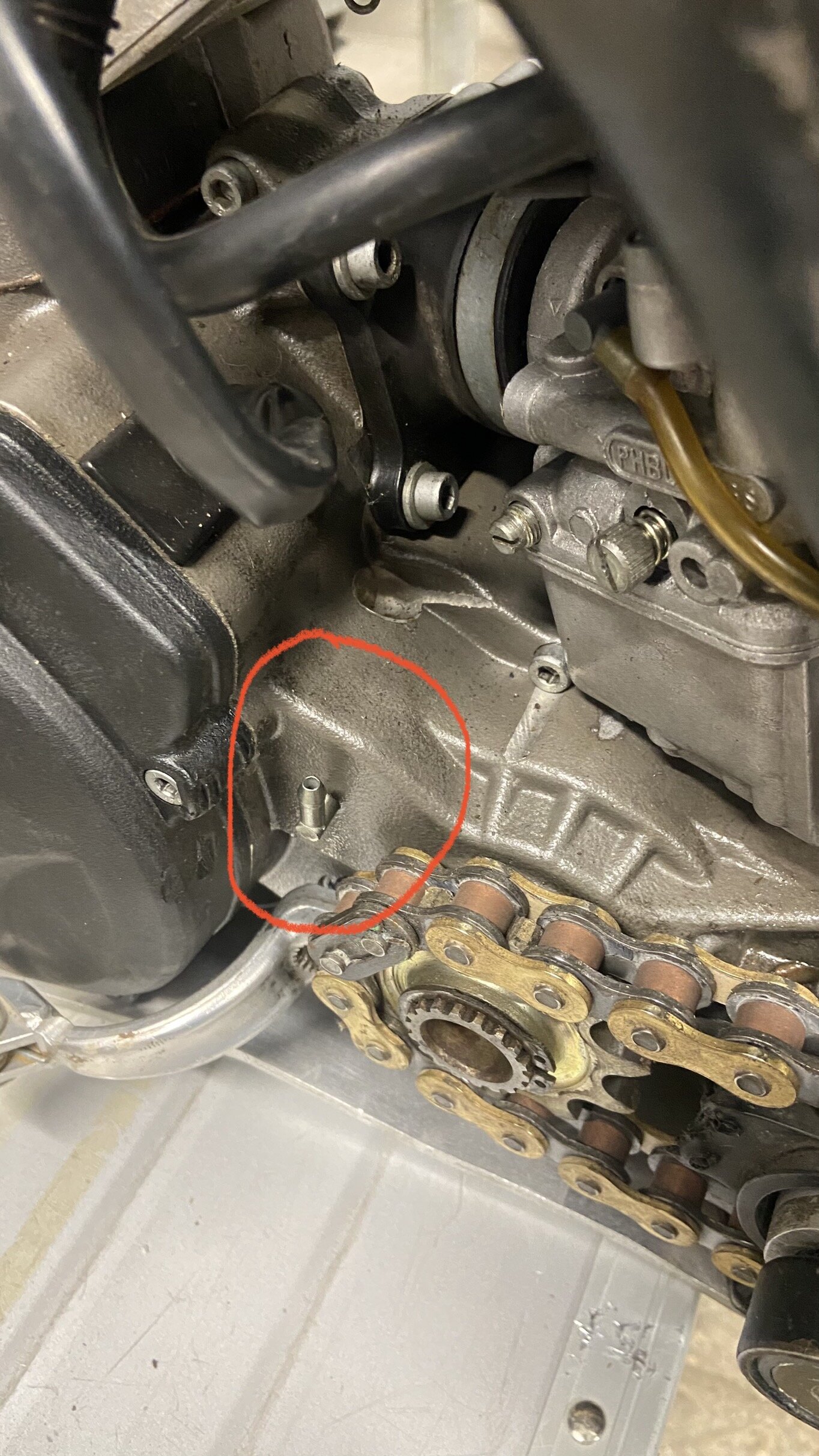

Wizna Posted October 29, 2023 Report Share Posted October 29, 2023 Hi Does anyone know what should be connected to this hose connector on the gearbox side casket? Quote Link to comment Share on other sites More sharing options...
slack Posted October 29, 2023 Report Share Posted October 29, 2023 Its a breather pipe, it runs up the side of the frame under the tank.. Quote Link to comment Share on other sites More sharing options...
Wizna Posted October 29, 2023 Author Report Share Posted October 29, 2023 Thanks! So if I just run a tube up to tank and hide it from dirt, water etc then it will be all good? Quote Link to comment Share on other sites More sharing options...
slack Posted October 29, 2023 Report Share Posted October 29, 2023 Yeah you can cable tie it to the wiring that comes out of the flywheel casing if needed . It's a crank case breather and i used to run mine just where the airbox and tank meet.. 1 Quote Link to comment Share on other sites More sharing options...
