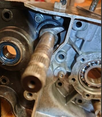

DavidSweden Posted December 27, 2023 Author Report Share Posted December 27, 2023 Thanks for the reply. I an putting the engine together and can anyone tell me: 1) How should the gear at the end of the kickstart shaft should be orientated when the kick is at the stop on the case (see picture). 2) The gear runs under a 3 pronged bolt (not sure what u call it) how tight should this bolt be, should the gear be able to 360 degrees under the prongs? Thanks in advance Quote Link to comment Share on other sites More sharing options...

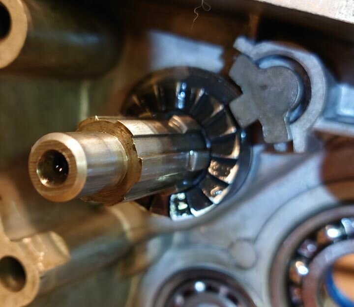

DavidSweden Posted December 28, 2023 Author Report Share Posted December 28, 2023 I put the case together this afternoon everything seems to be ok except for the kickstart mechanism. When the kickstart shaft is rotated (to simulaye a start) the the gearshaft turns (as expected) but there is a clicking noise when the kickshaft is rotated back to its home position. Does anyone know the reason for this? Quote Link to comment Share on other sites More sharing options...
feetupfun Posted December 29, 2023 Report Share Posted December 29, 2023 18 hours ago, DavidSweden said: I put the case together this afternoon everything seems to be ok except for the kickstart mechanism. When the kickstart shaft is rotated (to simulaye a start) the the gearshaft turns (as expected) but there is a clicking noise when the kickshaft is rotated back to its home position. Does anyone know the reason for this? The ratchet mechanism you can clearly see in the photo should click as the kickstart lever returns towards the stored position. Just before the lever reaches the stored position, there should be a cam or ramp that moves the ratchet teeth apart. If not for the ratchet mechanism, the kickstart shaft would be rotated by the motor when the motor starts. Quote Link to comment Share on other sites More sharing options...
DavidSweden Posted December 29, 2023 Author Report Share Posted December 29, 2023 (edited) Ok thanks, So its ok....The reason for the question is that it did not click before and now it does. Thanks for helping out Edited December 29, 2023 by DavidSweden Quote Link to comment Share on other sites More sharing options...

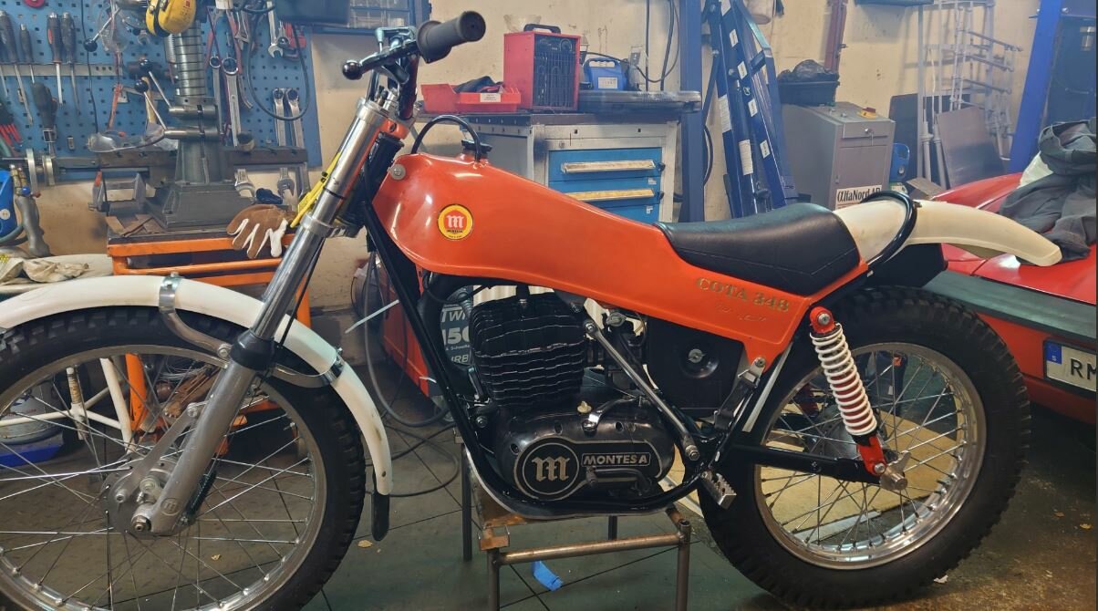

DavidSweden Posted January 20, 2024 Author Report Share Posted January 20, 2024 (edited) I got the engine back in the bike and it stated and runs nice. The bike has the Malcolm Rathmell tank can anyone tell me what the motor cc? Edited January 20, 2024 by DavidSweden Spelling Quote Link to comment Share on other sites More sharing options...
dr nosh Posted January 20, 2024 Report Share Posted January 20, 2024 348cc Quote Link to comment Share on other sites More sharing options...
feetupfun Posted January 21, 2024 Report Share Posted January 21, 2024 15 hours ago, DavidSweden said: I got the engine back in the bike and it stated and runs nice. The bike has the Malcolm Rathmell tank can anyone tell me what the motor cc? If its is a standard 348 engine then it is approx 310cc displacement.. Quote Link to comment Share on other sites More sharing options...
