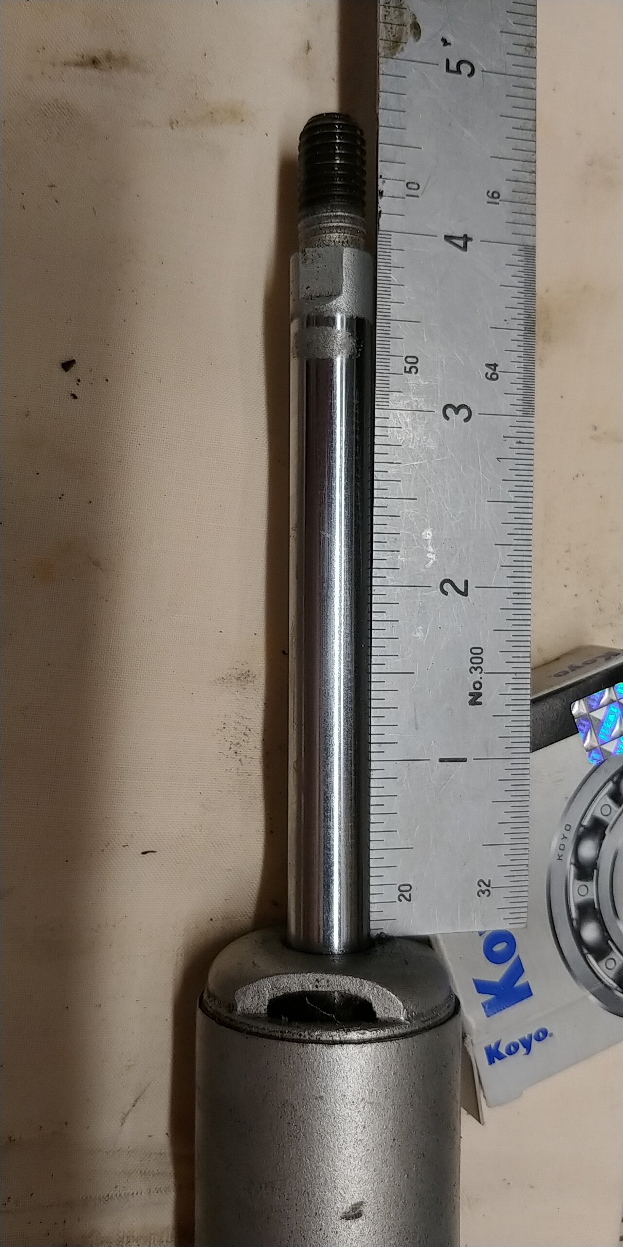

tokig Posted January 2, 2024 Author Report Share Posted January 2, 2024 Need tech specs please. 1972-3 Sherpa model 92b. what is the OEM shock travel? Not wheel travel, not axle travel Eye to eye, shock travel dimensions, exposed chrome shaft length when fully extended? Quote Link to comment Share on other sites More sharing options...
feetupfun Posted January 3, 2024 Report Share Posted January 3, 2024 On 1/2/2024 at 7:50 PM, tokig said: Need tech specs please. 1972-3 Sherpa model 92b. what is the OEM shock travel? Not wheel travel, not axle travel Eye to eye, shock travel dimensions, exposed chrome shaft length when fully extended? Expand My memory is saying 3.25". I'll have a look to see if I have one to measure Quote Link to comment Share on other sites More sharing options...
feetupfun Posted January 3, 2024 Report Share Posted January 3, 2024 (edited) On 1/2/2024 at 7:50 PM, tokig said: Need tech specs please. 1972-3 Sherpa model 92b. what is the OEM shock travel? Not wheel travel, not axle travel Eye to eye, shock travel dimensions, exposed chrome shaft length when fully extended? Expand So here's a photo of a Spanish Betor trials shock from back then. I have no way of knowing if its actually from a model 92 or not but I do have quite a few and they all have the same length shock shaft. Some have this type of seal retainer and others have a different type of seal retainer. Edited January 3, 2024 by feetupfun 1 1 Quote Link to comment Share on other sites More sharing options...

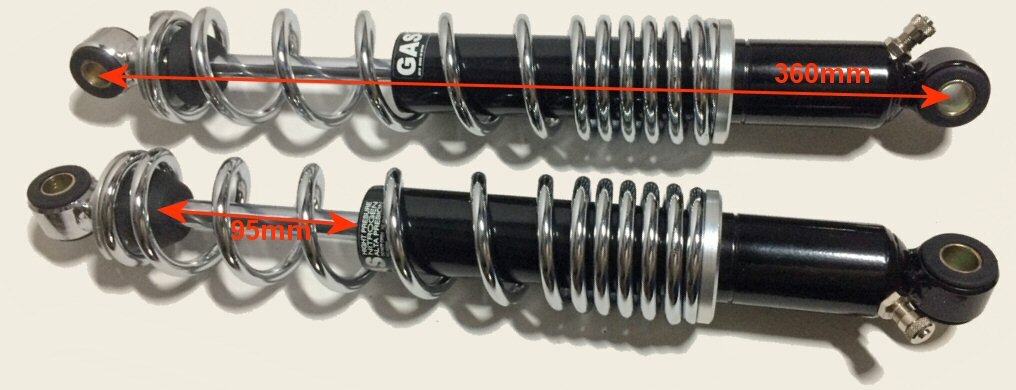

tokig Posted January 6, 2024 Author Report Share Posted January 6, 2024 (edited) Thank you feetupfun, your information and pics are wonderful. I am now using 360mm Betor gas shocks and wanted to understand how the original Betor shocks limited travel. The new shocks 360 with 95mm travel just barely clear new white plastic fender. Edited January 6, 2024 by tokig 2 Quote Link to comment Share on other sites More sharing options...
feetupfun Posted January 7, 2024 Report Share Posted January 7, 2024 On 1/6/2024 at 7:45 PM, tokig said: Thank you feetupfun, your information and pics are wonderful. I am now using 360mm Betor gas shocks and wanted to understand how the original Betor shocks limited travel. The new shocks 360 with 95mm travel just barely clear new white plastic fender. Expand Another factor in rear tyre clearance is that the rear competition tyres in the 1970s were nowhere near as tall as modern competition rear tyres Quote Link to comment Share on other sites More sharing options...
