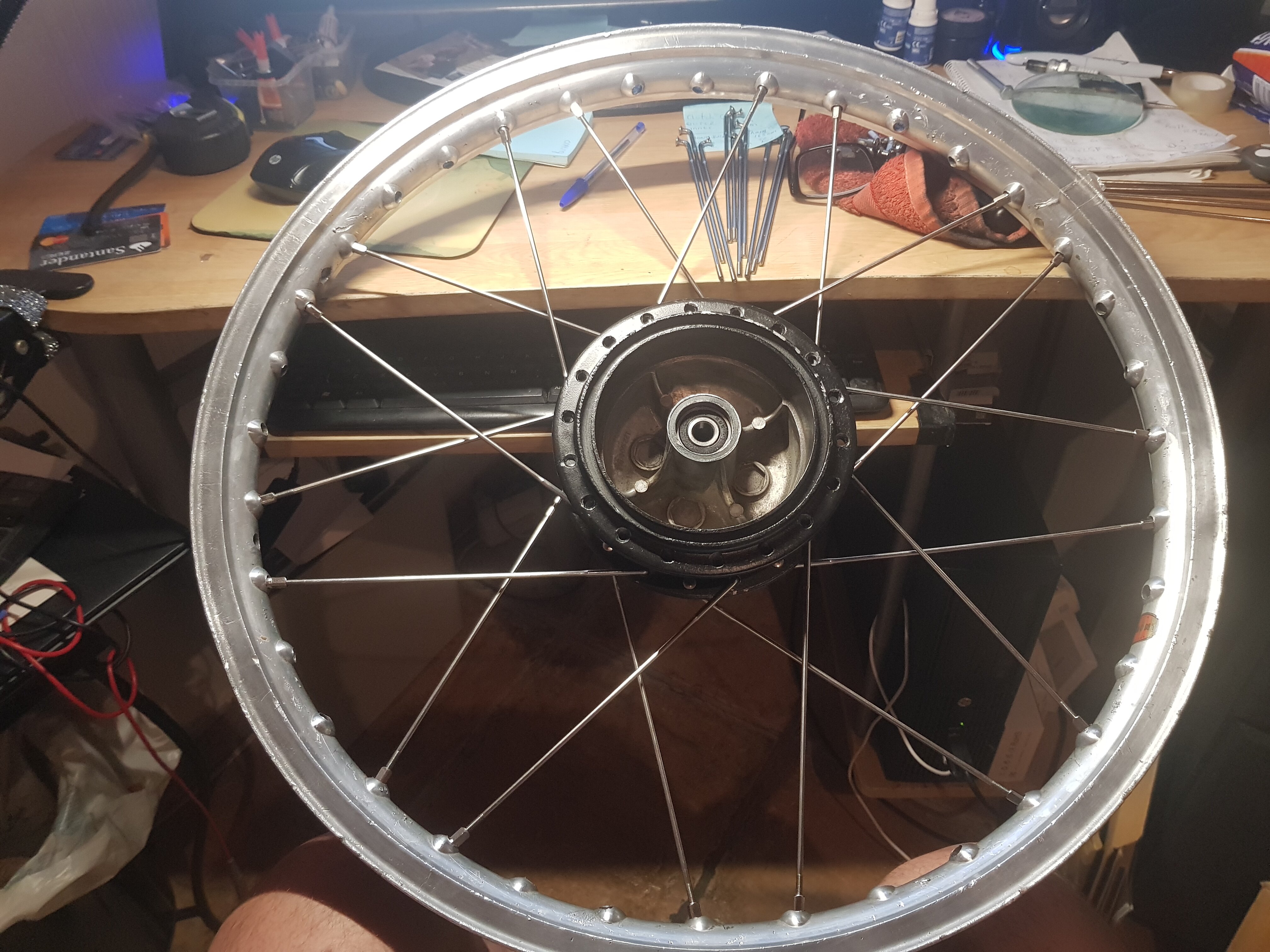

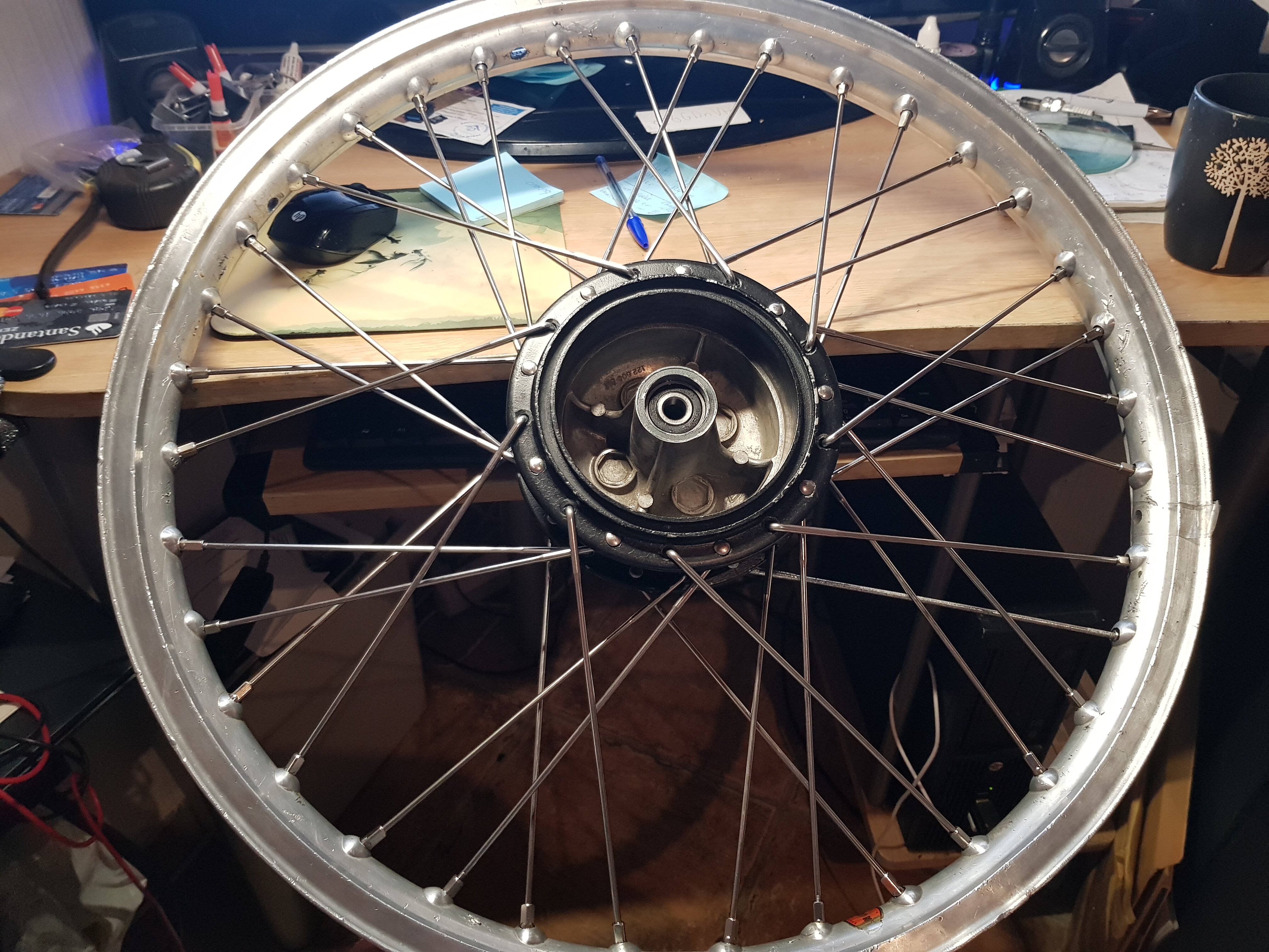

sidstevo Posted December 21, 2023 Report Share Posted December 21, 2023 (edited) Hi I have the rim and the hub and 36 x 90 degree spokes. I'm told they can't all be 90 degrees, half of them have to have a lesser angle. Anyone know what that angle is please? Its a front, 21 inch Akront from a 1974 MAR 250 Cheers Sid. Update.. The bike was a basket case and came with just the front hub and rim, no spokes. So.. In my ignorance I ordered 36 90 degree spokes from Poland because they were half the price of the Ossa kit. WRONG! I should have asked yous for advice first. There are two sets of eighteen, inner and outer with two different angles for each. I've just ordered the correct spokes from Trial World Thanks all for your advice. I'll be back. Sid Got the correct spokes at last. Looks good. Edited January 6, 2024 by sidstevo Quote Link to comment Share on other sites More sharing options...
