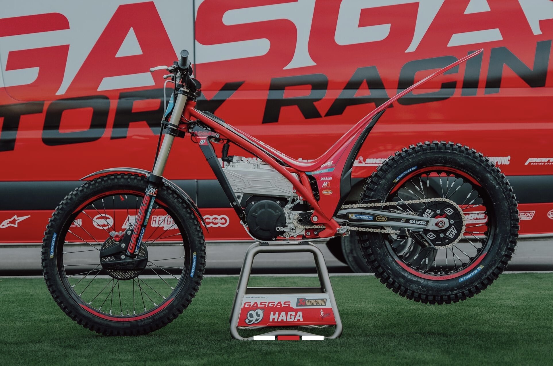

ChrisCH Posted June 22, 2024 Report Share Posted June 22, 2024 Sondre Haga making progress with the factory model now. Some of it in action (sorry it is in Spanish) Quote Link to comment Share on other sites More sharing options...
RonH Posted June 22, 2024 Report Share Posted June 22, 2024 A couple of images… Quote Link to comment Share on other sites More sharing options...
