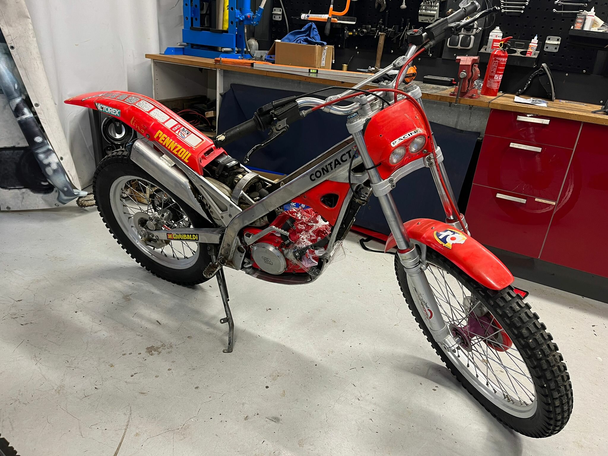

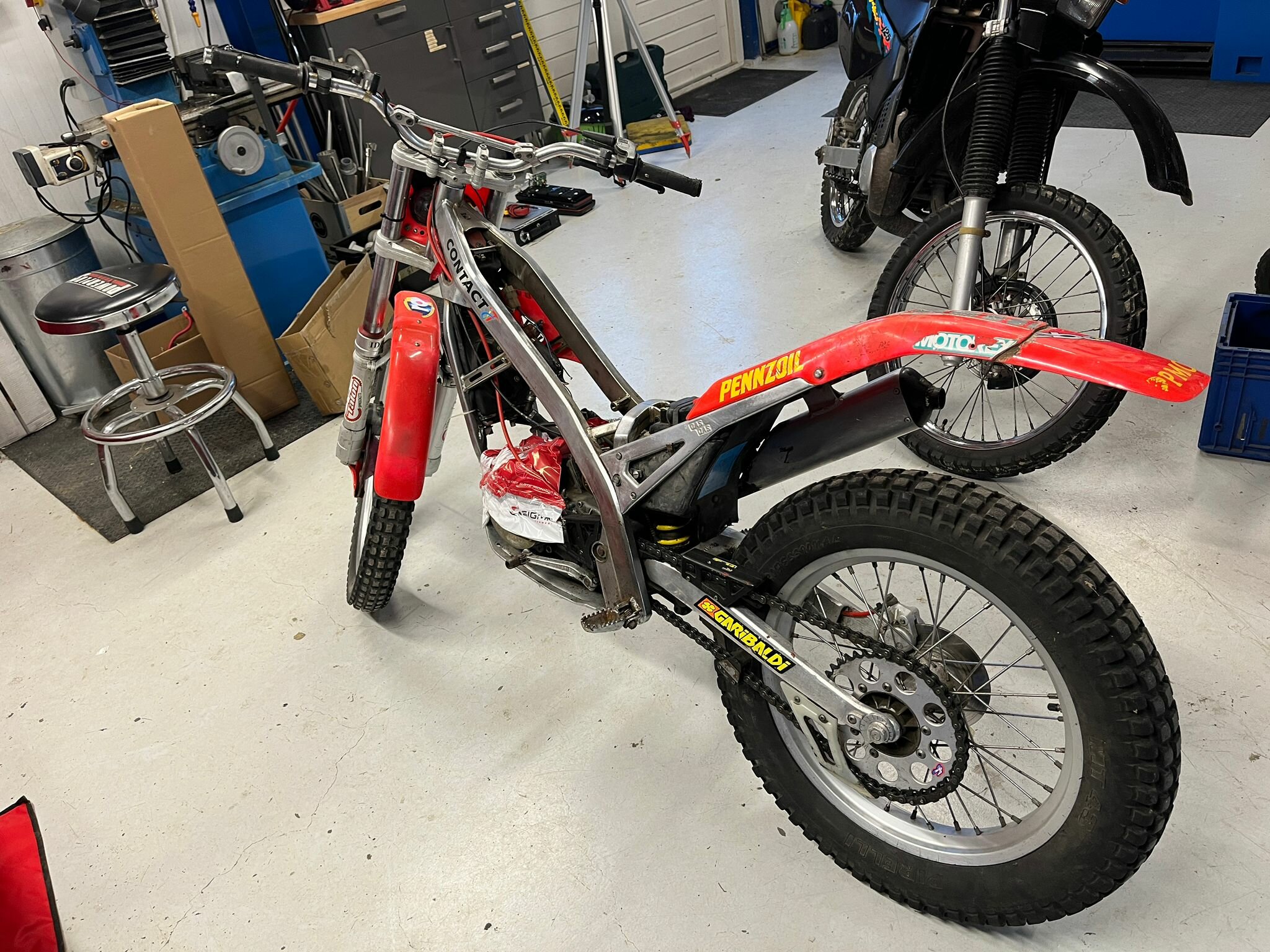

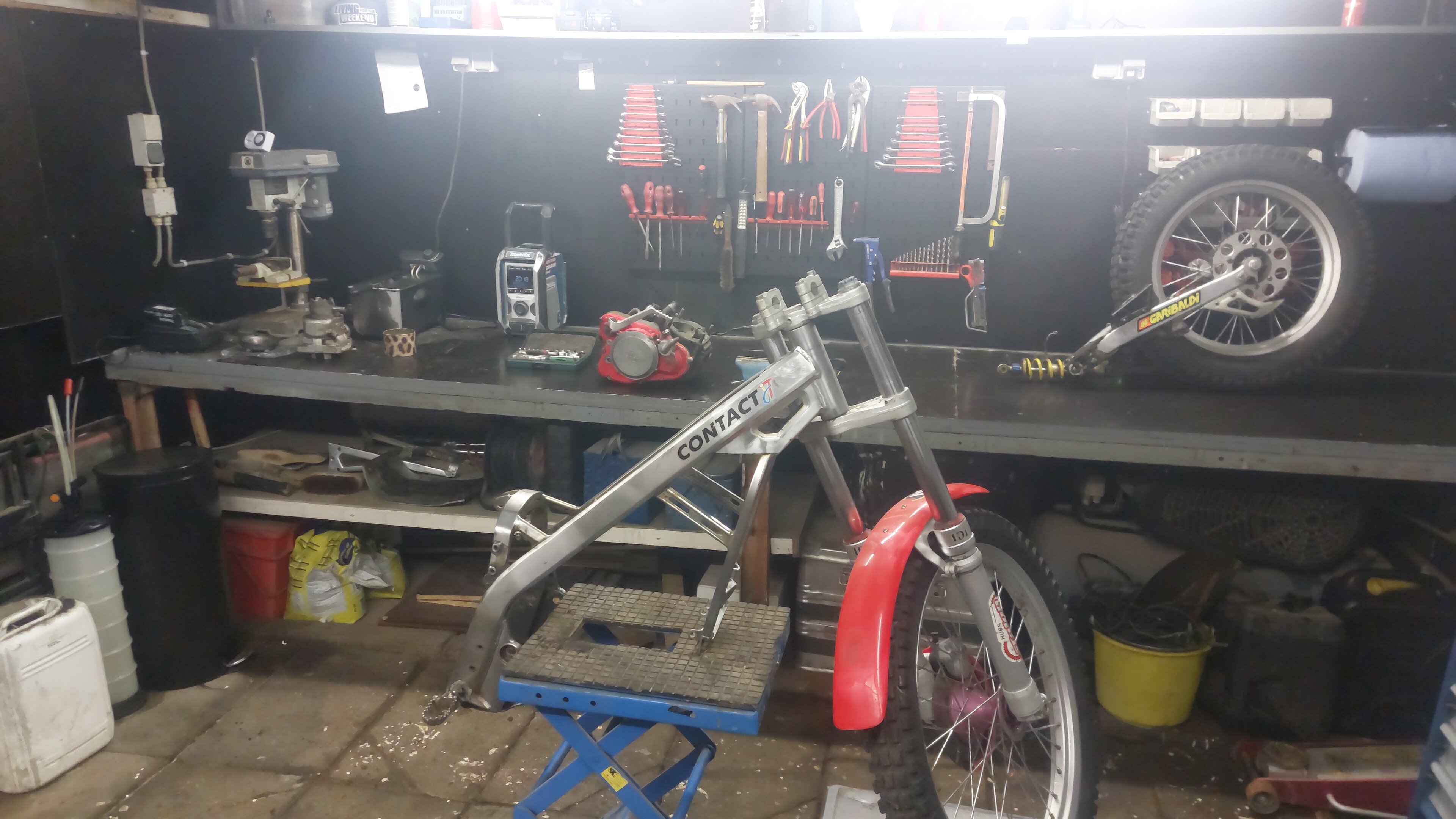

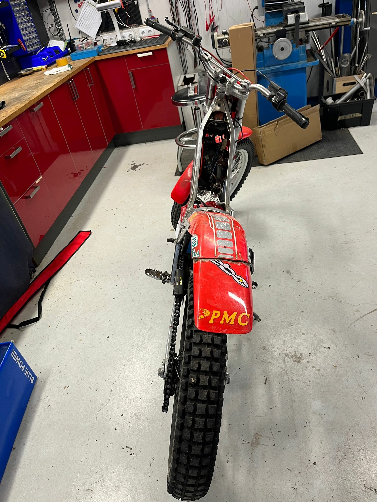

andrenld Posted January 4, 2024 Report Share Posted January 4, 2024 (edited) andrenld Posted just now Hello.guys I am currently looking for new parts for my gasgas jt25 contact 1995. I am looking for al the bearings in the swing arm and rear shock. Crankshaft bearings Al the seals in the engine and cilinder. Also looking for a lot of new parts to restore the whole bike. Do you guys have any idea where i can find those parts? Thanks for helping me Andre Netherlands Edited January 4, 2024 by andrenld Quote Link to comment Share on other sites More sharing options...
