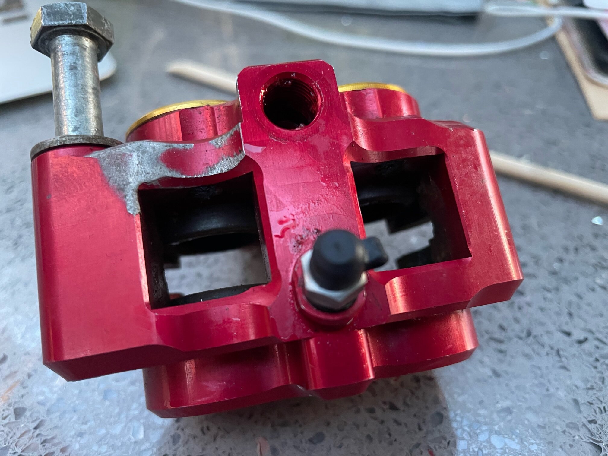

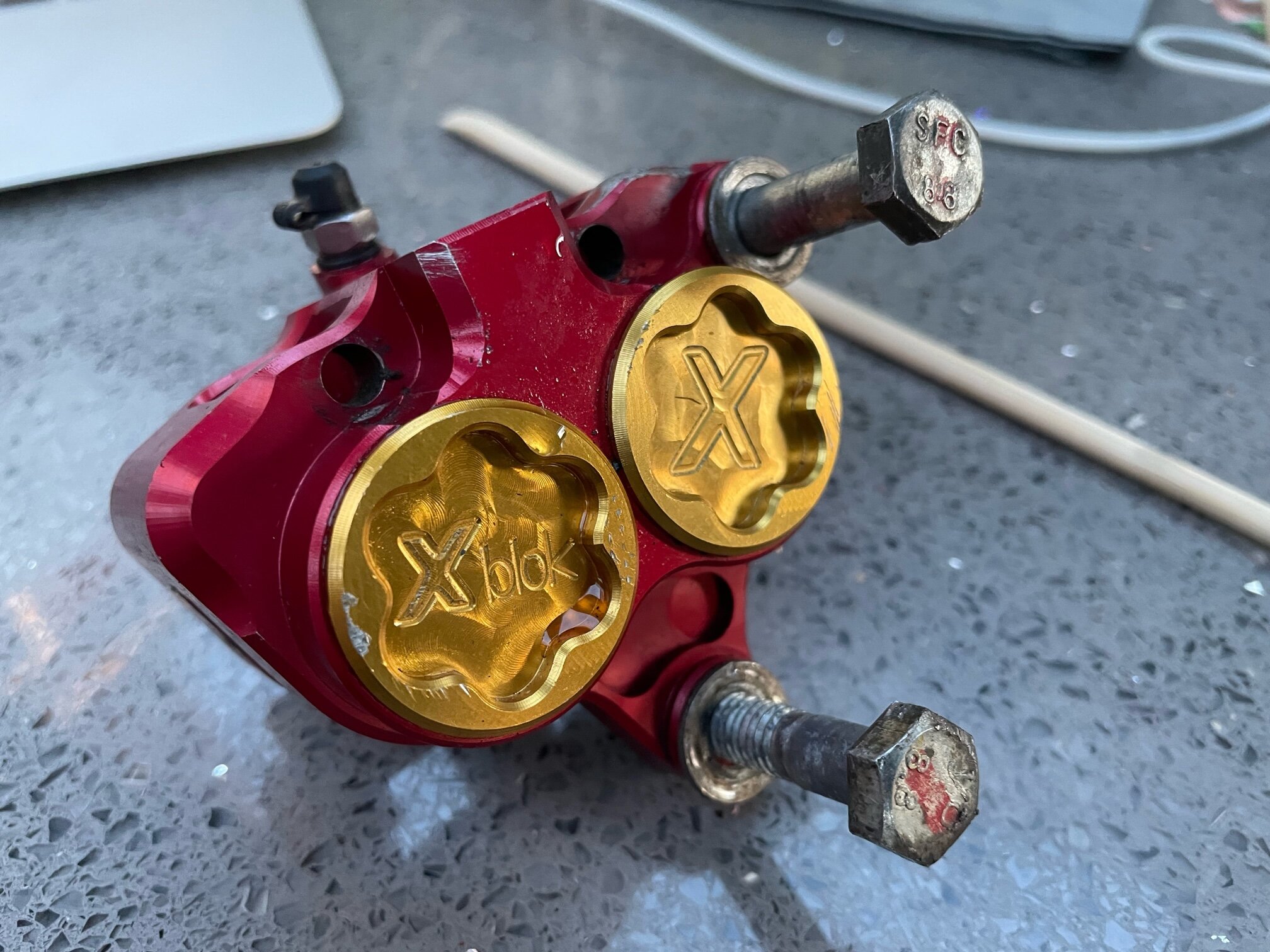

EddieStiffback Posted January 15, 2024 Report Share Posted January 15, 2024 Can anyone offer me some advice please on my Xblok front brake calliper, fitted to a 2011 Beta Evo 290. Cant find any info on Xblok online, is it an old / discontinued brand? 2 things, 1, where can i get a piston / seal kit? 2, whats the tool called or type of tool used to remove the gold calliper covers ( looks like a larger version of whats used on Hope MTB brakes. Thanks you Quote Link to comment Share on other sites More sharing options...
Tr1AL Posted January 15, 2024 Report Share Posted January 15, 2024 @EddieStiffback I remember when they were on sale ,The only advice that I would give is throw it away and buy a common and currently available Grimeca or Braktec front brake calliper with parts fairly easily available from many shops .In the time you have taken faffing around with that collectors item buying a Torx key that fits ETC and found the piston size you could be sorted and riding around. That is probably not what you wanted to hear. Alternatively buy a Torx type key very expensive for minimal useage make or find something that will undo the plugs and extract the pistons can be a hassle if you have not got a well equipped workshop then buy/use a vernier caliper to measure the pistons and see if the servicing kits that Braktec ,Brembo Nissin ETC ETC sell are compatible with your caliper block. 2 Quote Link to comment Share on other sites More sharing options...

faussy Posted January 16, 2024 Report Share Posted January 16, 2024 (edited) I actually dont think a torx will fit. The braktec calipers use a torx100 to remove their caps but the shape of this caps indents are more rounded than torx, so id say you would have to make your own tool. You may be lucky and find the pistons are the same size as braktecs (i assume they would make their caliper to suit pistons and seals already on the market) which are 25 mm, but youre already looking at £40 for a piston and seal kit! Edited January 16, 2024 by faussy 1 Quote Link to comment Share on other sites More sharing options...
