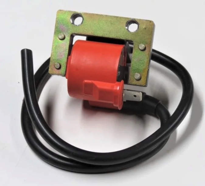

faussy Posted January 15, 2024 Report Share Posted January 15, 2024 (edited) Break in to the wire from your cdi to final coil, usually black and white, and earth it. Dont see why that shouldnt work, but never tried it before Edited January 15, 2024 by faussy Quote Link to comment Share on other sites More sharing options...

SherToPina Posted January 16, 2024 Report Share Posted January 16, 2024 faussy's suggestion is spot on, and can be a lot more robust and easier than my suggestion of a repair at the failure site. (Seal off the exposed broken wire at the CDI with non conductive epoxy or RTV.) Grounding (earthing) the mag-coil power-in spade terminal will kill the spark. Remove the female spade terminal wire from the HT coil and cut off the female terminal. Strip the end of the Power Wire, and strip the end of the Kill Wire. Twist the wires together and crimp into a fresh female spade terminal. This repair is very robust, permanant, and is good enough for flight (I mean stop). Quote Link to comment Share on other sites More sharing options...
